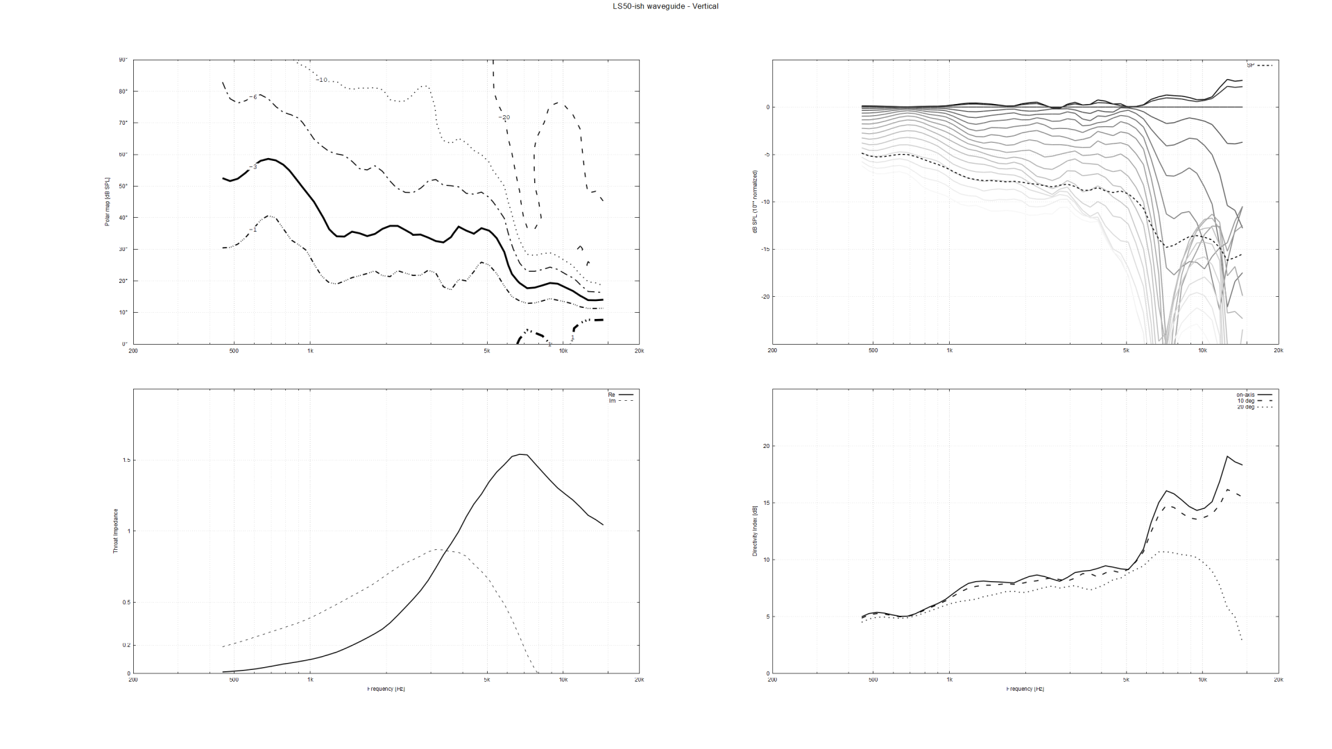

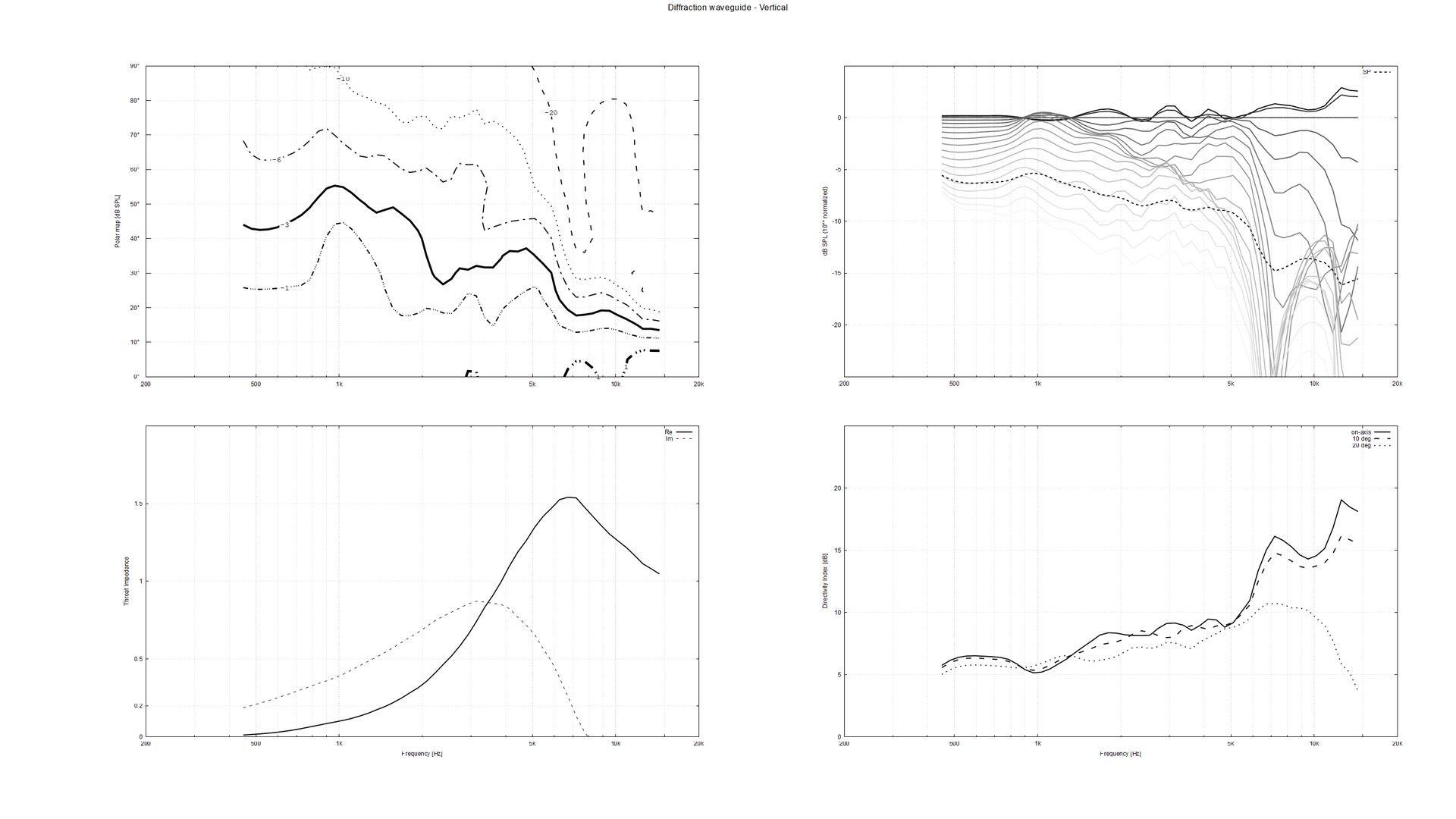

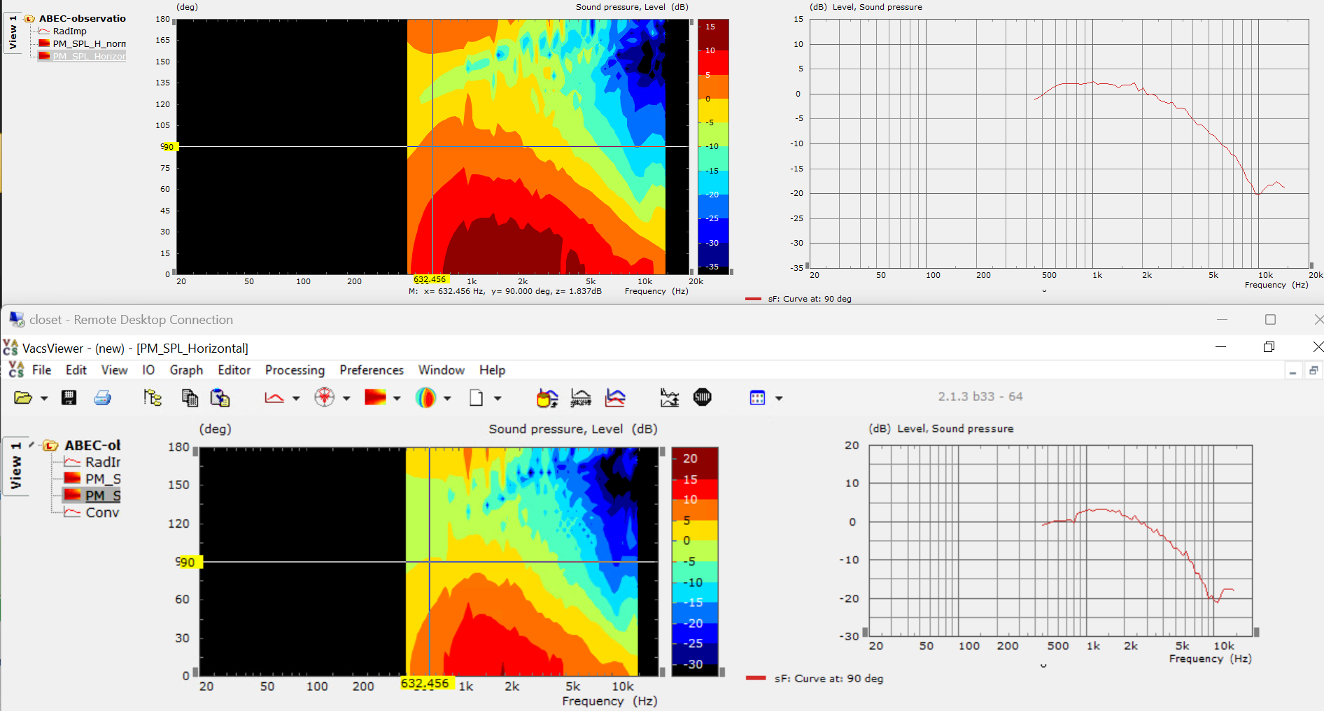

Here is a sim of this enclosure when it's 20cm deep
Here is a sim of this enclosure when it's 40cm deep
The differences are subtle. Energy cannot be created or destroyed and all that. In the enclosure that's 40cm deep, we see that the beamwidth is narrower at lower frequencies. Note how the beamwidth at 600Hz for the 20cm deep enclosure is 160 degrees, and for the 40cm deep enclosure it's 140 degrees.
I'm going to go out on a limb and speculate that the average listener can't perceive a difference between a beamwidth of 160 and 140 degrees at 600Hz.

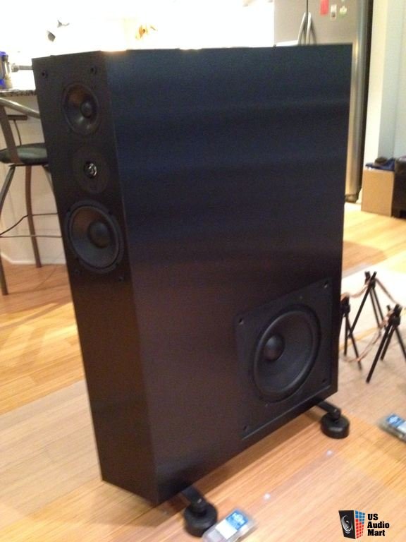

Ultra deep speakers like the NHT 3.3 (see attached) likely used a deep enclosure to increase the efficiency of the subwoofer that was located in the base of their enclosure. Particularly since the subwoofer in the NHT 3.3 had an efficiency of somewhere around 82dB.
There is more than just a beamwidth difference. Look at the 90 degree curve that shows the off axis diffractive hump that comes with all cabinets. It becomes lower in frequency with the deeper cabinet, but it also becomes higher in level relative to the on and near axis responses. It also changes the amount of sound that goes in which direction. If you put some observation fields in your simulations you will literally be able to "see" the shape of the directivity at different frequencies.

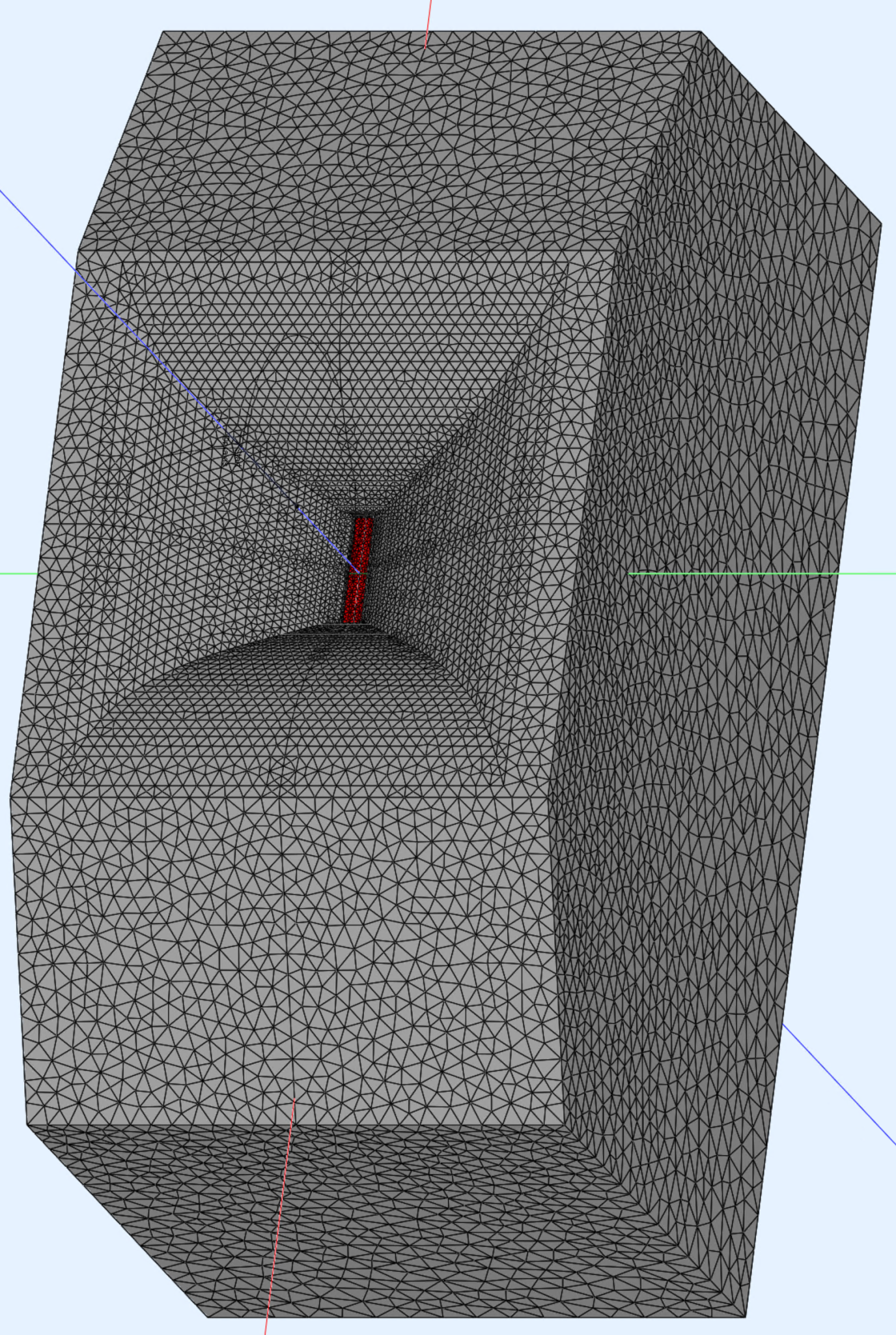

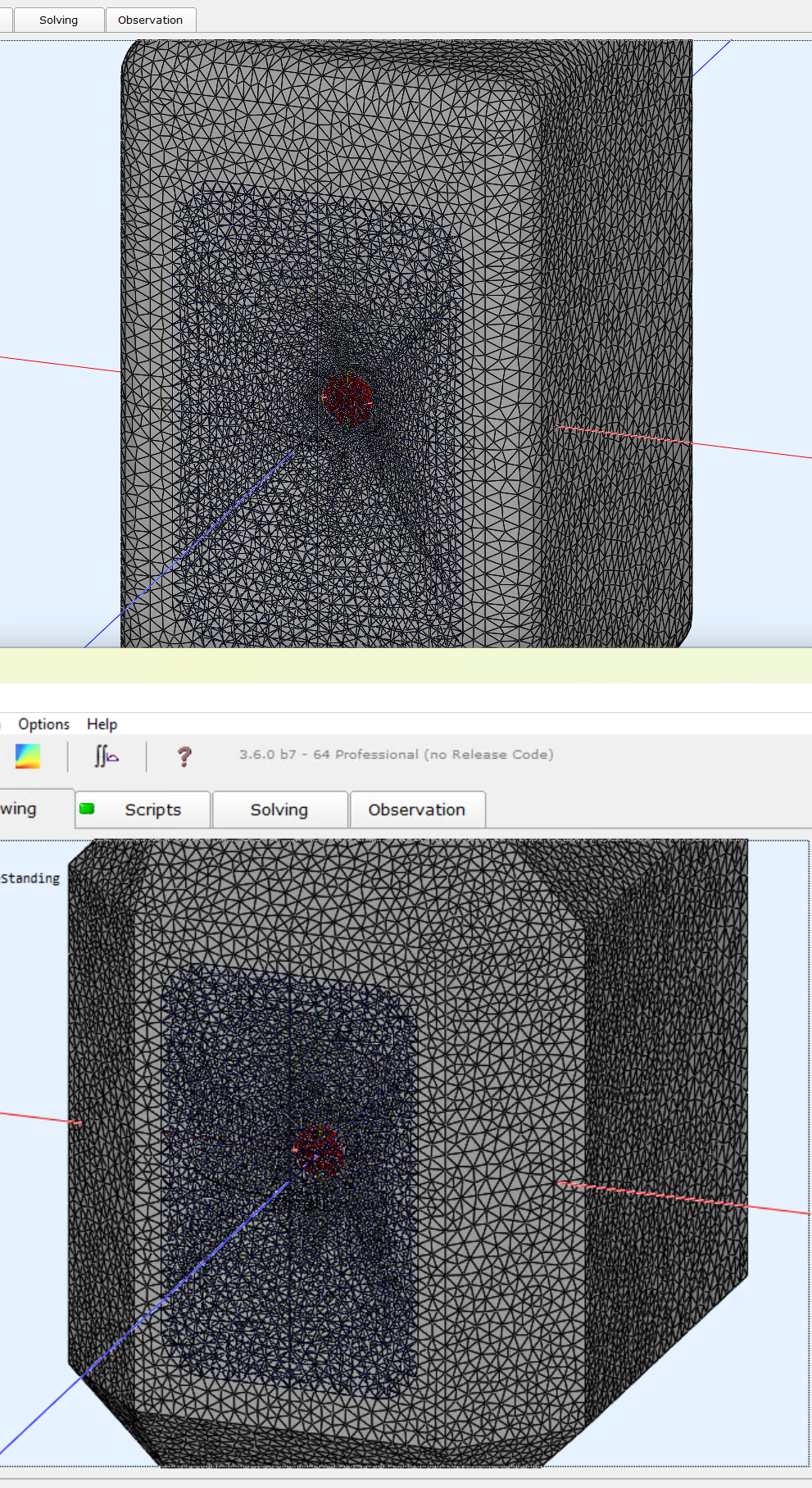

Attached are five files:
First, there are pics of two different Unity waveguides, which are mounted in an enclosure. One of the enclosures has a modest roundover - 1" or 25.4mm - while the second enclosure has a larger bevel on it. I was curious to see if a roundover is always superior to a bevel. Particularly since the use of a bevel simplifies building the baffle by quite a bit. It's way easier to cut a 45 degree bevel into a wood baffle, than it is to 3D print a baffle with a roundover.
Next, is a pic illustrating the predicted response of the two enclosures. The first prediction IS normalized. The next one ISN'T normalized. The reason that the difference between "normalized" and "not normalized" are similar is because the beamwidth of this particular design narrows at high frequency. I believe this is due to the fact that 75% of the bandwidth (up to about 2khz) has it's beamwidth determined by the size and shape of the enclosure.
In other words, the shape and dimensions of the cabinet allow the cabinet itself to behave as an extension of the waveguide, but the beamwidth is still quite wide. The waveguide itself maintains pattern control down to 2khz, where the beamwidth is ninety degrees. By 500Hz, two octaves lower, the beamwidth has increased to 150 degrees, but it's not the 180 degree beamwidth you'd expect from an infinite baffle.

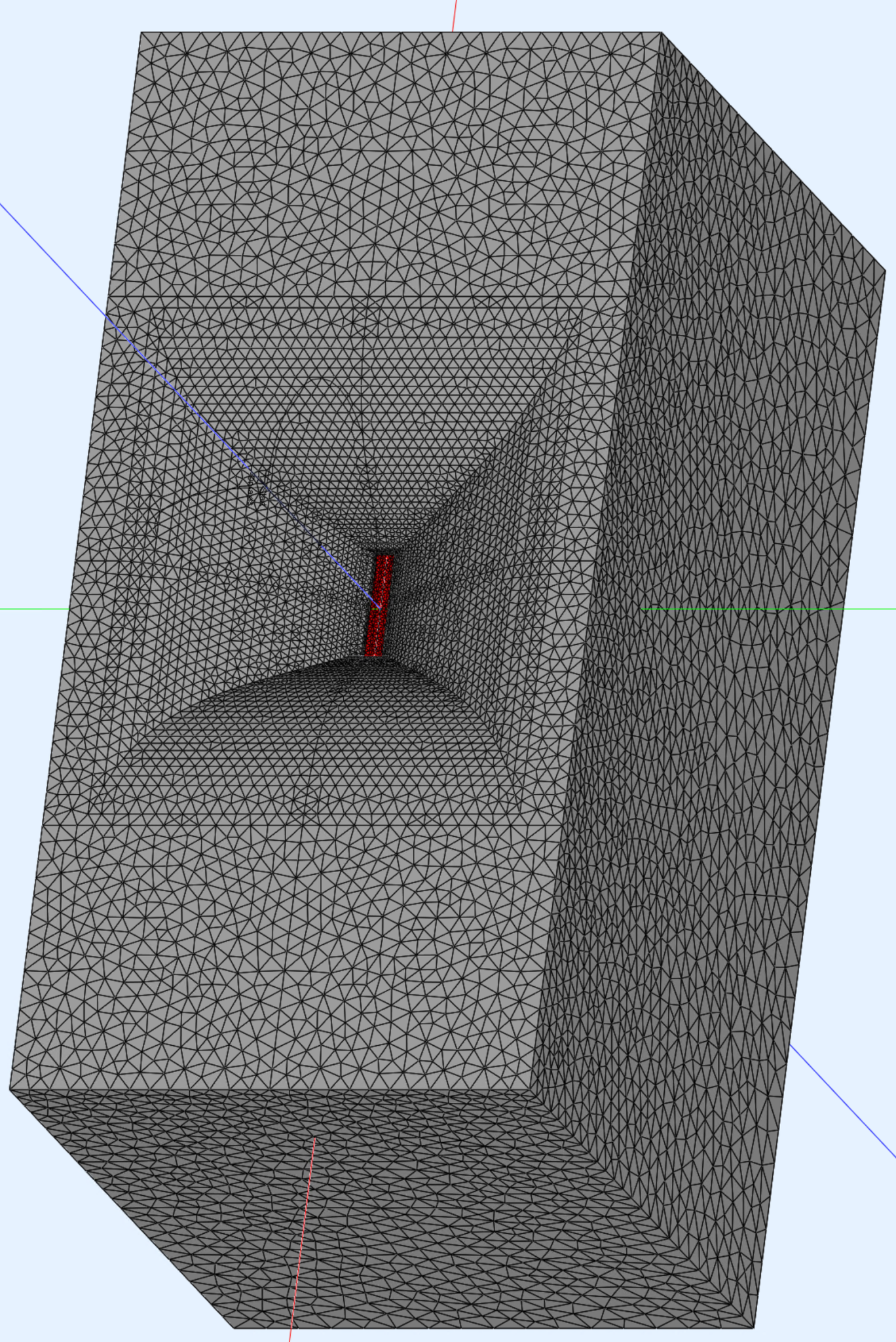

Here's the output from running ATH; note that the beamwidth at the throat is 34.340 degrees. I think I may be able to improve the performance by making the entrance angle to the waveguide wider, to reduce the beaming at high frequency.
-calculating profiles
-morphing to rectangle
-morph: adding -5 mm in width
-morph: adding 2 mm in height
-fixed length: 50.8 mm
-stretched to boundary: dx=4.92786 dy=2.43566
-writing ABEC project
-writing geo file bem_mesh.geo
-average mesh throat angle: 17.170 deg
-reading source definition file
-running 'c:\Users\johndoe\Downloads\gmsh-4.11.1-Windows64\gmsh bem_mesh.geo -'
Info : Running 'c:\Users\johndoe\Downloads\gmsh-4.11.1-Windows64\gmsh bem_mesh.geo -' [Gmsh 4.11.1, 1 node, max. 1 thread]
Info : Started on Mon Jan 13 00:51:03 2025
Info : Reading 'bem_mesh.geo'...
-running 'c:\Users\johndoe\Downloads\gmsh-4.11.1-Windows64\gmsh mesh.geo -'
Info : Running 'c:\Users\johndoe\Downloads\gmsh-4.11.1-Windows64\gmsh mesh.geo -' [Gmsh 4.11.1, 1 node, max. 1 thread]
Info : Started on Mon Jan 13 00:51:05 2025
Info : Reading 'mesh.geo'...
Done.
Device width x height = 178.00 x 288.00 mm (7.008 x 11.339")
Device length = 50.80 mm (2.000")

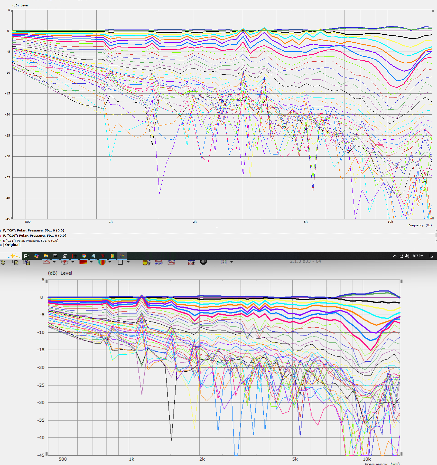

The difference in these graphs is subtle, so let me point a couple things out that may not be obvious. The first is that my measurement technique that I've been using for 2+ decades, it looks like I need to step my game up. Basically, I've done nearly all of my measurements in +/- 45 degrees, measuring 90 degrees of beamwidth. I figured that was sufficient for a waveguide, since most of my waveguides have been narrow, over the years. I've made lots of Unity-horn-inspired stuff, and it's beamwidth is 50-60 degrees, depending on the model. What these ABEC sims show, is that the enclosure impacts beamwidth, but you need to look ALL THE WAY out to +/- 180 degrees, a full 360 degrees around the design. There, we can see that radiation to the sides is impacted by what's happening at the FRONT of the baffle.
I've made a lot of threads about roundovers and minimizing diffraction, and often found that a roundover didn't seem to make much of a difference if the waveguide is large. What I'm seeing here is that it DOES make a difference, but you really need to widen your measurement and simulation window beyond +/- 45 degrees. In the sim below, the HIGHLIGHTED curves are 0-45 degrees, in five degree increments. You can see there are few differences; you really have to look past that angle to see the difference, where it's mostly apparent between 450Hz and 1Khz - the frequencies where the wavelength is larger than the width of the enclosure itself.
In the attached graph, the TOP enclosure has a modest roundover (one inch) and a larger waveguide but smaller box. The BOTTOM enclosure is 33% larger in every dimension. This increases the volume of the enclosure quite a bit; I struggled to get the volume under three cubic feet, and that's a fairly ridiculous size for a two way.
It's difficult to see ANY real advantage of the larger enclosure, except that it's easier to build. But that IS quite important; every time I've 3D printed a decently large baffle, it tends to look ugly. Because the larger the print is, the more that warping is noticeable. Basically, if your angles are off by two degrees and the baffle is 20cm wide, it's not super noticeable, but when the baffle is twice as large in all dimensions, you start seeing gaps and noticeable problems.

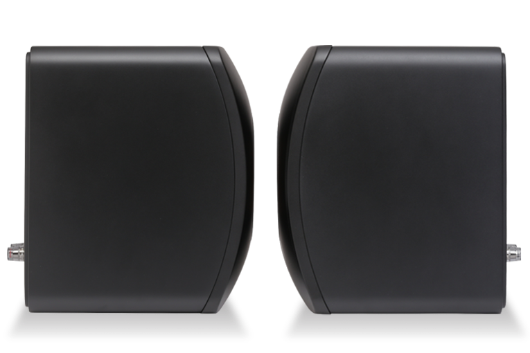

I'm sure many of us have wondered why the KEF LS50 has a baffle that's vertically curved. KEF rarely doesn't anything without a good reason, and I'll bet the curvature is functional.
I've also attached some sims of a "super sized" version of the same enclosure that I've been working on.
In the vertical polars, you can see that the addition of the curvature has a substantial impact:
1) it smooths out the overall response. This should be audible; flatness through the treble is generally perceived as "sounds good."
2) The most noticeable change is that the curvature NARROWS the vertical beamwidth. This is probably the opposite of what you might expect, but I explain on the first page how/why this happens.
3) The frequency response off-axis is much more consistent with the on-axis sound, when the baffle is curved.
