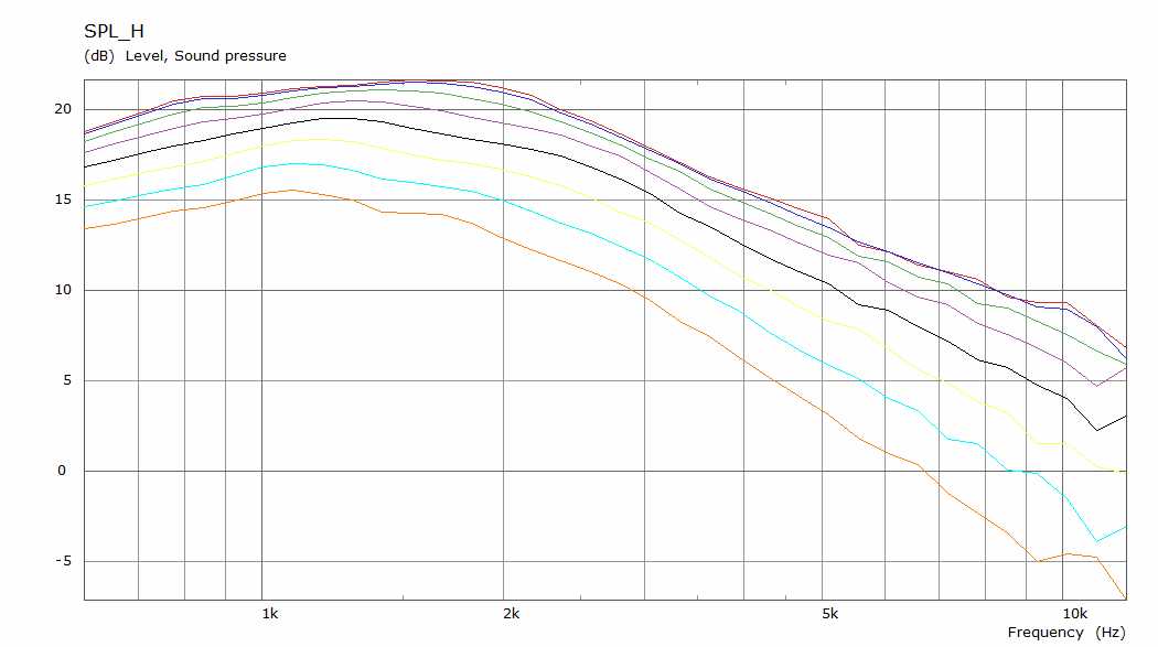

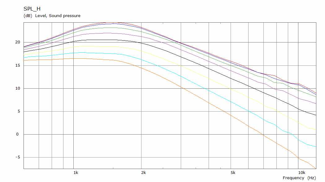

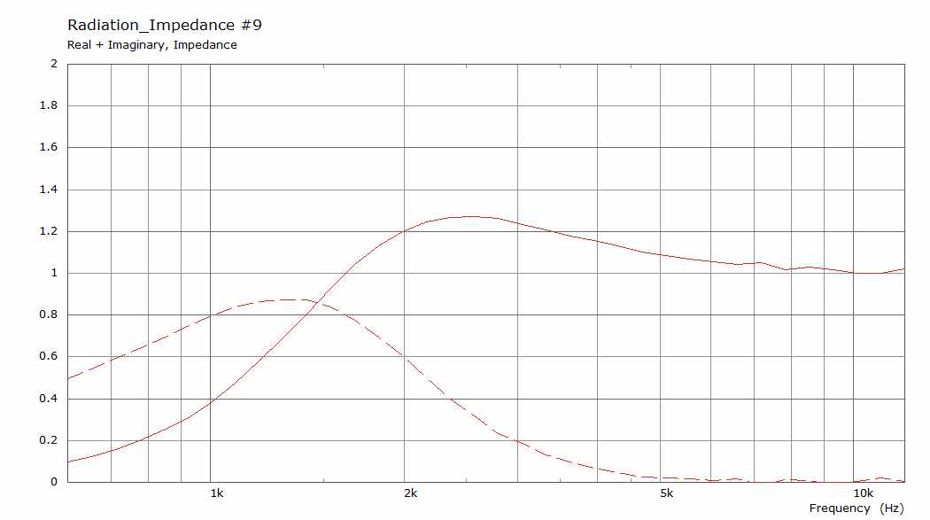

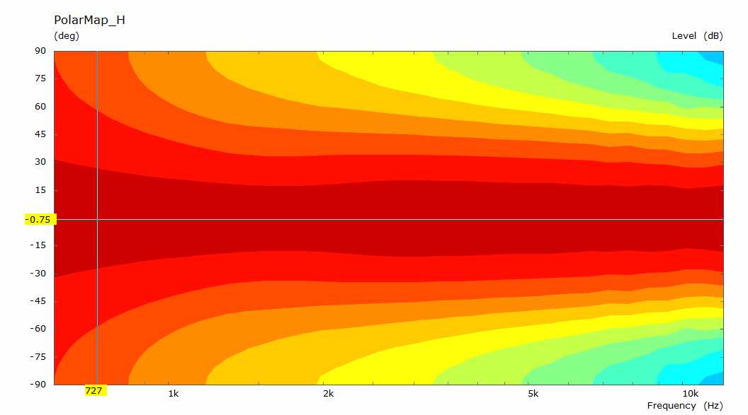

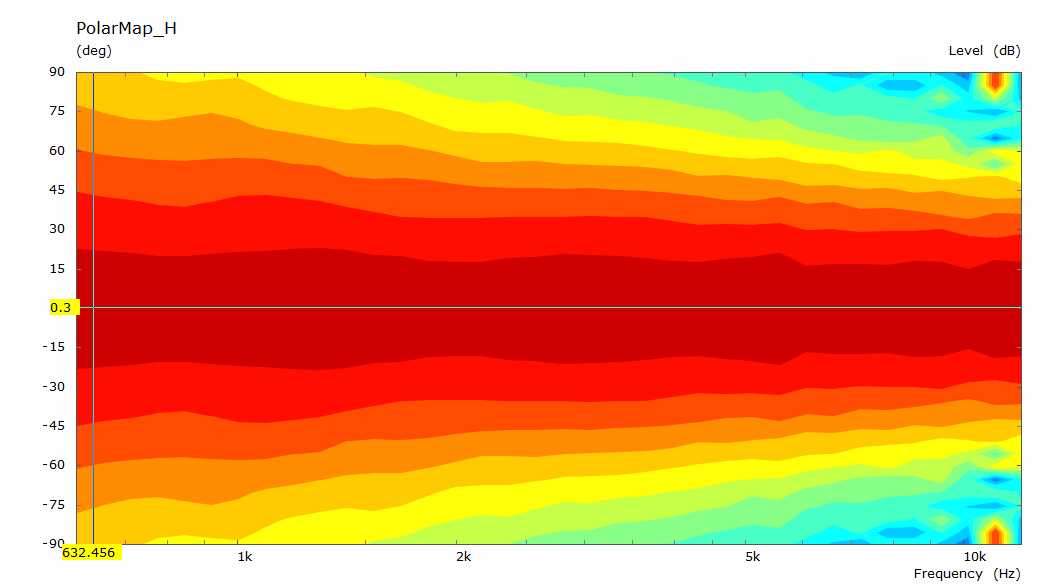

Here's an ABEC example that shows the change in directivity lower in frequency from a complete enclosure vs the same waveguide in an infinite baffle. The same sort of sim could be run for a Revel size bookshelf speaker. Considering the entire enclosure is important (particularly if you are targeting a specific directivity) as it can have quite a large influence on the final result.
This is done with 1/4 symmetry to save solving time but due to the size of the enclosure (574mm wide) and the resolution of the mesh it still takes 3 hours to solve.

Is the first set of curves for the infinite baffle and the second for the complete enclosure?
What computer were you using which took three hours to complete the sim? I might be getting a new system so it'd be useful to know how much grunt is needed for simulations.
The left set of curves is in the enclosure, the right set is the Infinite Baffle. So the smoother curves are those of the infinite baffle and the ones that extend the directivity lower and smoother belong to the enclosure.
