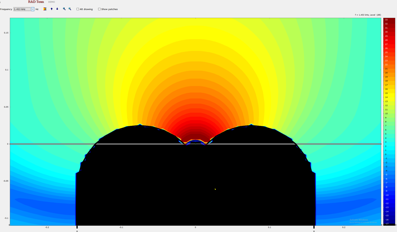

Here's a close up of the Revel Salon - style model, with a 14" wide baffle with a huge roundover.
There's some aliasing artifacts up close, but that's fairly normal for Axidriver.
I am using a mesh frequency of 30,000Hz, which should be quite a bit more than necessary.
I think the Axidriver sims are relatively accurate, but they're exaggerated. For instance, the actual Revel Salon exhibits a treble curve that's relatively ragged, compared to a tweeter on a wide and flat baffle.

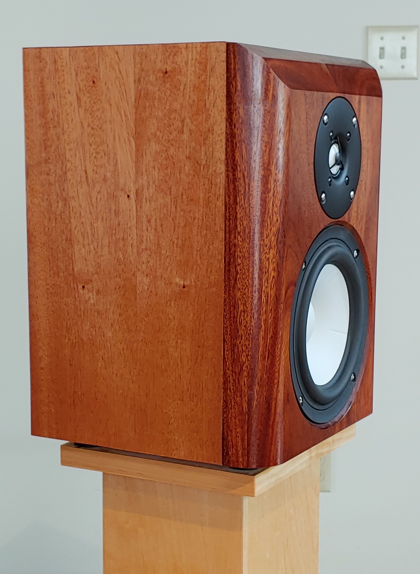

Below is a photo of a speaker I built. It uses the SB26CDC tweeter (almost identical to the SB26ADC driver of your simulations). The baffle is narrow; 10 inches total width, and 7 inches of flat baffle to the start of the roundover. The left/right roundovers have a radius of 1.5 inch (37 mm), and the bevel along the top is 30 degree, then 60 degree.

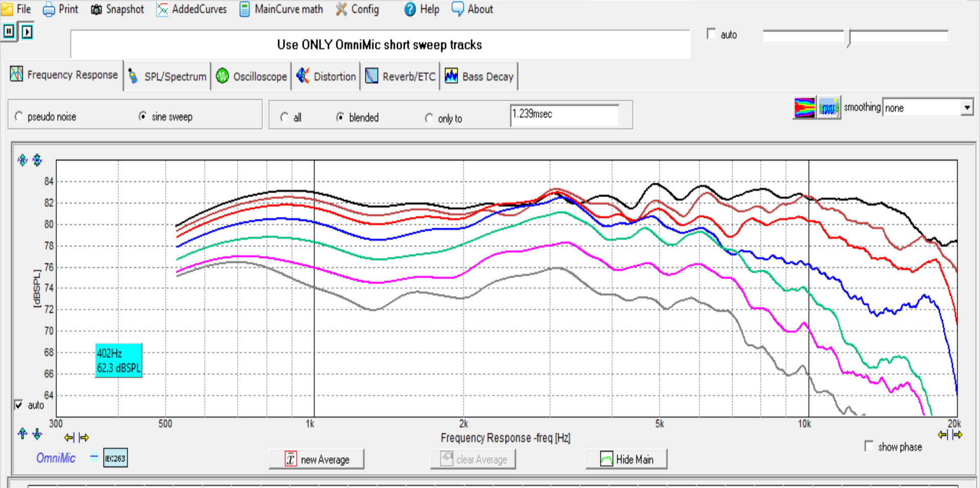

Attached is the response at 0, 15, 30, 45, 60, 75, and 90 degrees horizontal. No smoothing was applied. My measured response is quite a bit smoother than any of the simulation plots you have shown. And I realize my system does not use a waveguide on the tweeter, so the comparisons only go so far. I suspect a simulation of my system may show a worse response than what was measured.

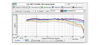

It would be good to see your measurements from 1m distance at least, no smoothing (gated is fine as long as gate is larger than 3.3ms) and vertical dB range 60-90dB.
This measurement is so squished that one can not draw any conclusions out of it.
It would be good to see your measurements from 1m distance at least, no smoothing (gated is fine as long as gate is larger than 3.3ms) and vertical dB range 60-90dB. ... This measurement is so squished that one can not draw any conclusions out of it.
I did not re-measure it, but I replotted the July 19 2020 data with 2 dB vertical divisions. The measurements were taken at a distance of more than 2x baffle width. According to my notes a distance of 23 inches (58 cm). Time window gating was 4.7 ms.

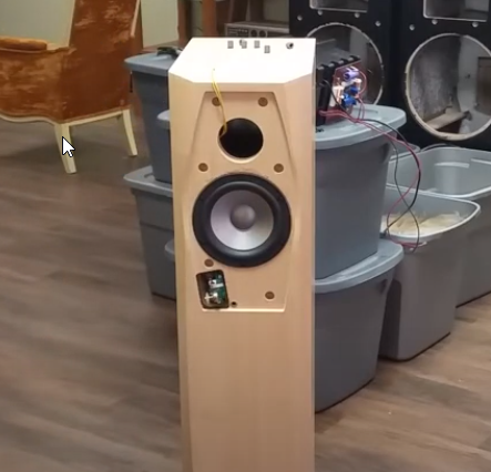

Here's a pic of the Infinity speakers, with the stock baffle removed. To give you an idea of how you can use the stock speaker but with a different waveguide, tweeter, and woofer. Basically 3D print a new baffle to replace the old one.
These Infinity speakers are ubiquitous on eBay and Craigslist, and can easily be found for $200-$300 a pair. Admittedly you can get a flat pack cabinet from Parts Express for less than that, but I like the diffraction reducing baffle of the Infinity.
