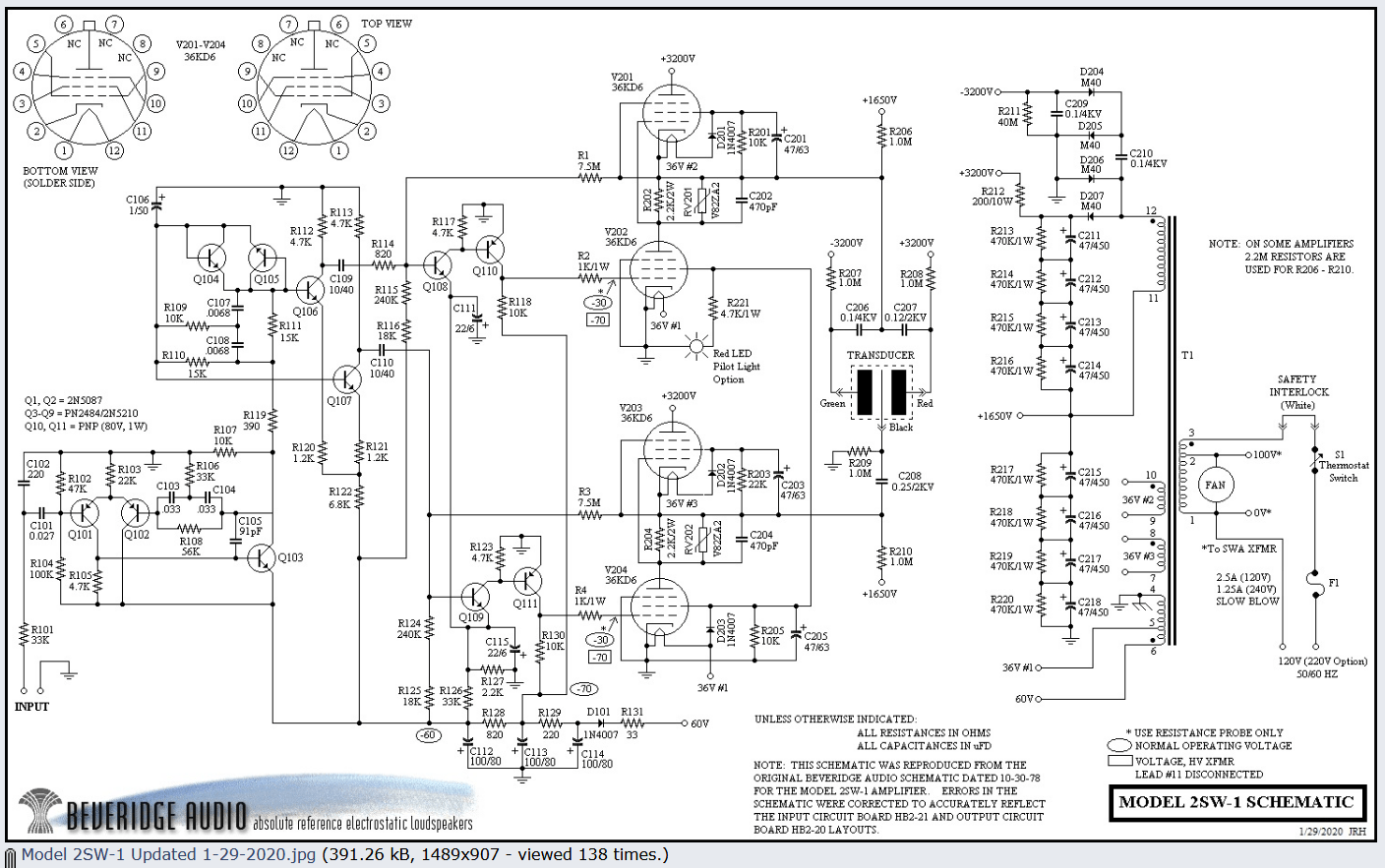

I think the 36KD6 is used in the beveridge amp.
Jan
Yes 36KD6 in Beveridge amp.
schematic attached

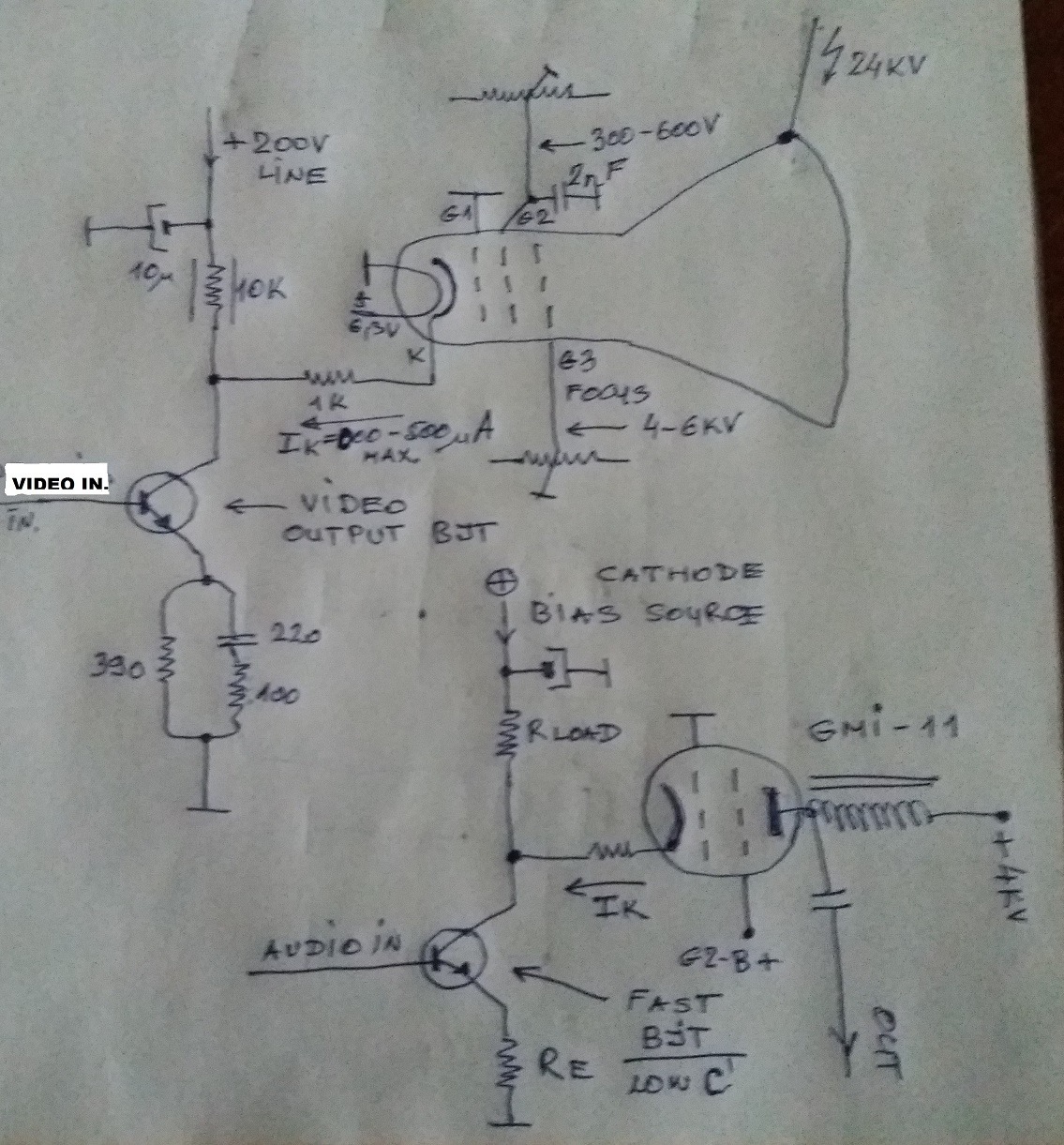

Jan check this schematics , since maybe this can be useful for your project , basically it represents principle how CRT cathode is linearly modulated with wide band video signal in countless nr. of colour TV set`s ,notice that there`s allways present one cathode very clean bias positive DC source , we R&TV repairsmans called that source simple as 200V line , principle is very simple , when video signal is not present on the driver transistors base than the driven cathode current is Ik=0uA , CRT screen is black , that also mean that cathode now stays on max.DC positive potencial relative to g1 which is grounded , that represent cutt-off point ,
the question is ; for your specific hybrid amp and for linear cathode drive but now with audio signal it is also necessary to have some suitable DC bias source or not ?

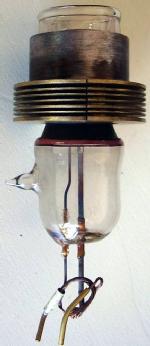

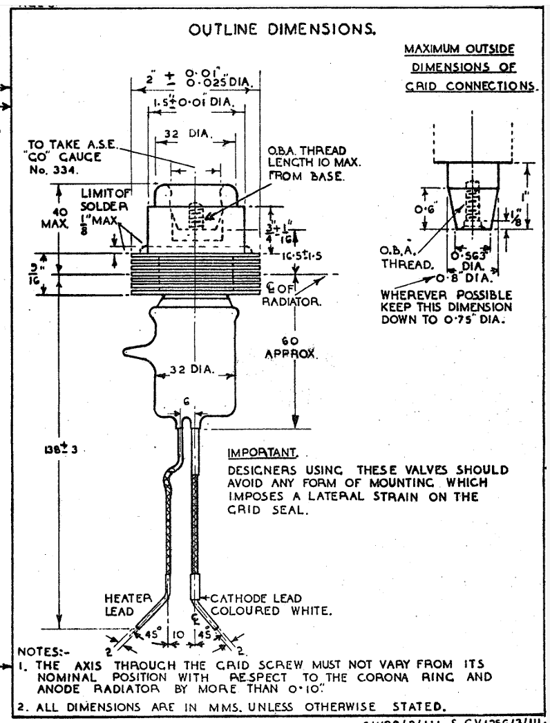

I made a rudimentary inventory as attached. It seems that the CV-1256 and its siblings are the most promising.
What I am wondering is the mechanical mounting of the tube. Am I right that the grid is in the center connected to a threaded insert.
How would I mount this tube on a chassis of some sort?
Jan
