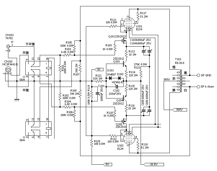

I do worry about any current that causes a difference between Ia and Ik and I believe C2 current does cause that.
In my concept it causes distortion, I want Ia to be exactly Ik as far as feasible.
See attached.
See attached.
Jan
Jan
as long as the audio signal drive of the cathode goes only in the positive sving direction, Ia will be equal to Ik, this is valid for example the case when both grids of the GMI-11 tube are directly grounded, with such connected grids, that lamp is a real Triode,
but only in the case when the audio signal drive of the cathode goes in the negative sving direction in relation to the both grounded grids, then the grids current will also start to flow so that Ia will no longer be equal to Ik, in that case Ik will be the sum of Ia+Ig1+ig2.

With just a few mA Ia and kilovolts of voltageswing from anode to all other electrodes, there is little hope to get really equal anode and cathode currents at higher frequencies, thinck also of capacitive currents,strays a.s.o, cathode current will always be higher, no?
Which rules out pentodes, or demands a lot of jumping through hoops to use natively pentode valves as triodes. I wonder if the requirement could be relaxed in your (push-pull) case? Suppose that only the G2 signal (but not the DC) currents needed to be equal in your application. Would that mean that you could tie the two G2s together, and feed them from an arbitrarily large impedance from their own supply, chosen for best operating characteristics, and let any G2 signal currents' differences cancel, because push-pull Class A?
The secondary question of DC currents might be minimized by the current source G2 feed sufficiently to keep anode currents in reasonable balance. Of course you want to keep those anode currents in tight balance for headroom in the plate choke. Would a trim resistor in the semi-con driver portion do that job?

Chris, there will be global feedback from output to input. The drop across the inductive load will be about 30V and I can accept that 'unbalance' relative to purely symmetric output. Compare it to offset in a solid state amp slightly offsetting the output so clipping will be assymmetric. Not an issue in practise.
There will be two fully independent opposite-phase amplifiers driving the two stators.
I have for about a year an amplifier in service based on this, works very well. It was published in AudioXpress Dec 23 issue.
In a few weeks we'll put up a link to it so also non-subscribers can download. That project was based on the 6HS5, a beam triode.
The new project became necessary because the output is loud enough for listening at elevated level but not drive the ESL 63 to max output.
So basically I am looking for a replacement for the 6HS5 that can handle more Va and more Pa. Target is 8kV and 80W, but 2 // tubes @ 40W is also acceptable. What I found so far is that beam or compactron triodes max out at 5.5kV Va(max). (Beam) pentodes are available with Va(max) of 8kV+ and Pa of 40W+, but that introduces all those grids that complicate things. The other alternatives are RF xmitter tubes like the CV-1256 which is a triode that handles 10kV at 100W.

As usual, I was unclear. I'd meant DC imbalance in the standing mag field of the anode inductor's core, in the same sense as a conventional amplifier's DC imbalance through its OPT primary, and the same issues. In that respect, that anode inductor needs to be very much like the primary of an OPT. You might even use the 63's step-up's secondary windings with (originally) primaries disconnected, and reserved for emergencies or comparisons.
Re pentode G2 supplies in push-pull: in modern semi-con circuits like this (cascoded push-pull Class A, like input diff-amps) the analogous common G2 connection (the "top" BJT pair's common base terminal) is bypassed, cap coupled or even something fancier, to the junction of CCS and "bottom" emitters or sources.
In really ancient, pre-War, and somewhat post-War push-pull pentode circuits the common G2 connection to power supply was often just through a big resistor, no bypassing. Looks like it would be somewhat self-balancing.
