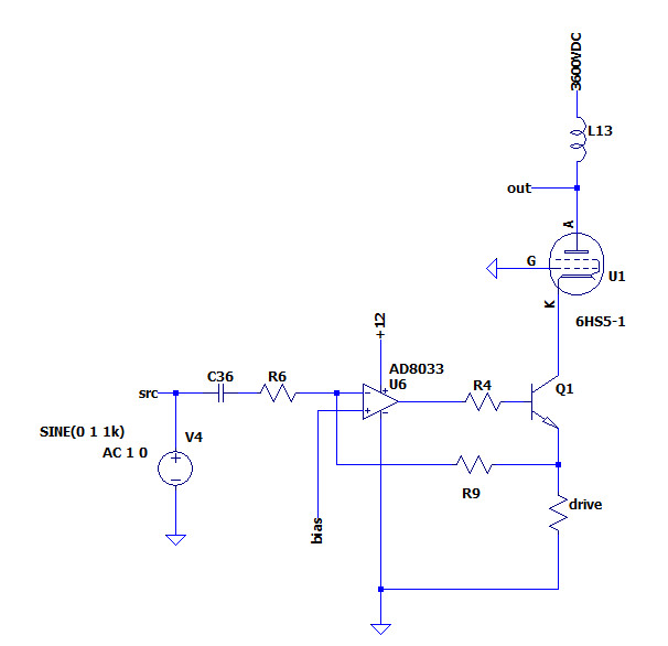

Mornin' Reinhout. I looked at those 15e's but it seems Pa is limited to 20W.
I need about 80W total. I also like to avoid grid current, that needlessly complicates the design.
I am now looking at two 6LF6* in parallel, choke loaded, at about 3600VDC B+.

Chris, direct heated would be OK, also a separate G2 depending on the voltage, a few 100V would be OK.
I'll look at the 4E27. 75W is just about my lower limit.
Attached is the concept with a beam triode.
Jan
Jan

That certainly looks pretty elegant. Can't even imagine the kind of inductor that is L13. You're saving some secrets for a big reveal, and I can't wait to find out.

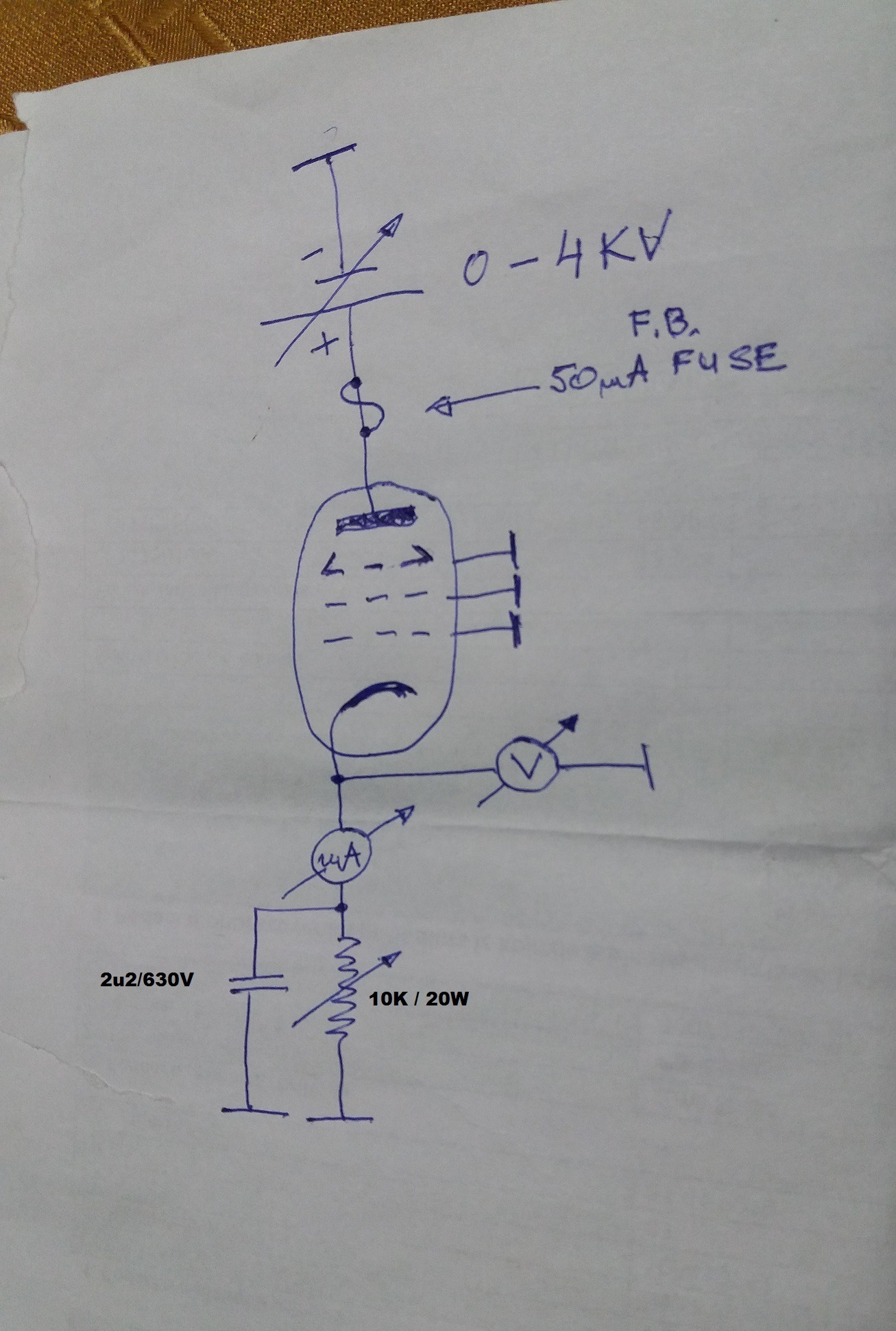

since you already have adjustable up to 4,4KV HV DC source I propose you to made one simple test jig just to record specific basic results whatever which type of tube you want to use , but allways triode strapped with all grids and beam plates electrodes grounded , and before you further develop the real amp circuit of course , by using this simple test circuit you can watch what Ik and Vk you get when you manualy adjust both Va and Rk , also in this way you can determine max. anode disipation.
ps ,filament heater supply allways have to be floating type , let`s say supplied from some isolation transformer , just to suppres arcing betwen cathode and filament in case you testing those TV beam pentode tubes .
Jan
with proposed test jig you can test those tetrodes or pentode tubes including GMI-11 tetrode tube in both ways , with g2 connected to ground line or with g2 connected to cathode , but with g1 control grid allways tied to ground line , it is all depends from final test results , and from resulting tube parameters which is the best suited for your solid state cathode driver circuit , and of course also depends from primary task to get the best basic or open loop overall linearity ,
btw , think in case that you get cathode voltage in range of 200-400DC than that bipolar driver power transistor can be the one from those again TV or even better CRT-PC-monitors horizontal output stage ?, like BU508 ,BU208 , or simmilar HQ- HV transistors .
