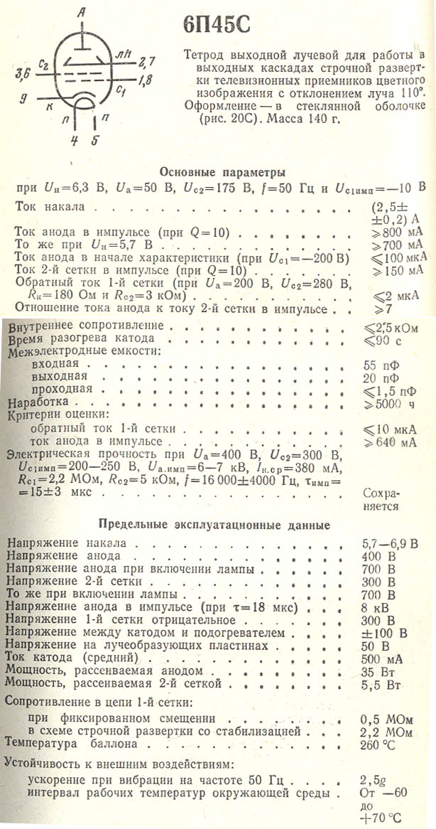

IMO Russian both 6P45S and 6P42S beam pentodes tubes can be also interesting choice for GG linear AB1 class operation , those tubes are very simmilar to European EL509/EL519 TV tubes , with max. anode disipation of 35W and max. anode peak voltage of 8KV for T-peak=18u-second , by these tubes is good that cathode are fully galavanically isolated from heater electrodes and also from all other electrodes which can simplify cathode driver circuit , but my rough calculation says that you will need four of these tubes per one push-pull ESL- OTL amplifier .

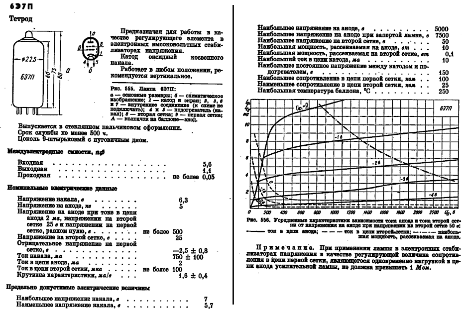

GP-5 is 2mA Ia rated, but the GMI-5 is on my short list.
Jan
The GP-5, 2mA is dc !!!, at 20kV, and without grid current . I cannot imagine this 2mA is a emission limitation . I would thinck at the much lower anode voltage you would use you can run up the anode current till you reach the power limitation of 40W or so. To do so, you need gridcurrent offcourse, just as with about any triode with extremely low "Durchgriff" it will need gridcurrent to be able to supply sufficient anode current, A2 operation is the way to go. No idea what power the grid can take or are there any other implications besides grid temperatur, but i thinck it is worth trying.
As to mpulse triodes, they are specially designed to cope with a certain amount of breakdowns and pulseduration is a keyfactor regarding theyr voltage capabilities., check out the pdf
  • ADA136489.pdf
Joined 2006
Jan, If i where you, I would just take one of those TV shunt stabilizer tubes to find out how suitable they would be for the task.
Build a fullwave voltage multiplier with some 400-550V CT transformer.
Hook up the tube with adjustable positive grid voltage, adjust necessay positive gridcurrent till max anode dissipation at the different high voltage steps you get from the multiplier.
DC link caps and avalanche diodes like the BYW96 are your friends.
The first cap of each halfway multiplier side could be taylored to limit the max short current .
Then one can safely climb up the ladder tubelabs style till the tube pops or sensible gridpower is exceeded.
I would thinck something up to 100mW on the grid is something just about any tube can take.
