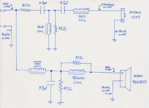

We have severely winged it on the crossover, which we think is this:
816737d1581543233-looking-audax-hd20b25h-mid-bass-driver-s4_corrected-png
I don't like it much. Maybe it works with the original woofer, but we are in entirely new territory with the SEAS replacement. But do note the tweeter is wired in negative polarity.

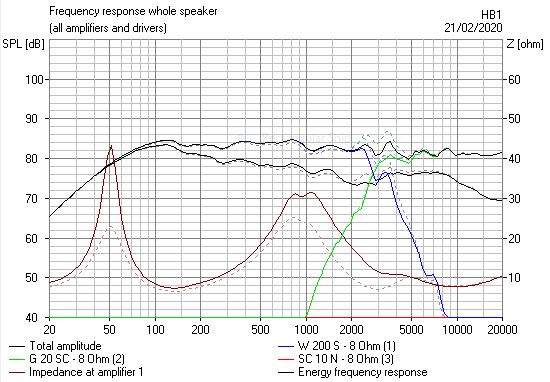

Problem I see now is excessive brightness at crossover. This loudness may be making the bass appear to be lacking. FWIW, closed box probably works best close to the wall, which always adds bassyness. Closed box also benefits from stuffing material, like a pillow.
I was hoping we could avoid crossover mods, but these appear to be necessary. It was always on the cards that tweeter level might need adjustment, and that is just a question of changing the 4.7R. The capacitors could benefit from swapping round too, IMO. Better impedance. The tweeter circuit is actually then quite conventional Celestion style.
I would prefer a more conventional bass circuit like the one below too.
Really, I'm just gathering thoughts here. Let's mull this over. But this isn't hard to fix, IMO.

Just a bit more detail, (bear with me):
I'm convinced (albeit it may not affect the woofer issue that much) that there is not a 100% seal round the driver to baffle. Although I did apply tape, I haven't totally covered the fixing areas round screws.
When I place my hand over tweeter there is very little bottom end coming out the woofer and little to no "movement" of the coil even when cranking with heavy dub bass or punchy bass.
I didnt touch the wiring of the tweeter from the crossover. I did replace the Red/Black wires coming in from the terminals as they were very tatty and breaking but i matched the red/black possie/neg to what they were originally.
What i have assumed in respect of the red/black wires coming from the crossover to the woofer is that the red wire went to the plug, on the driver, that was marked (painted) in red. if this was the wrong way round would that affect the woofer polarity? although I would have assumed that a connection painted red would mean red wire needed attached to that post.

Here's the new and improved drawing. It's a little crooked but hey, I was using a Guiness coaster as a straight edge.
Steve is probably more organized (and experienced) with Sim programs so he'll probably get to this before I do.
Hopefully, it will just take a bit of tweeking to make this crossover work with some other woofer.

Hi 4 years later and I'm thinking of changing the caps on my lenteks. Do you remember you provided a schematic and I think you downloaded the images. Would you be able to help me identify which items are the caps and what the values are?
I have recently successfully recovered capped a pair of wharfedales but they were easily identified.
