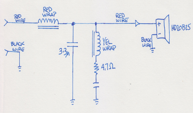

I've managed to work out the woofer section of the crossover but I'm missing some parts values. It is the same as the woofer section of that Tabor crossover with different parts. The tweeter section is different but I don't think it matters because the tweeter is staying.
What does it say on the white thing between the yellow cap marked 3.3uF and the yellow wrapped coil?

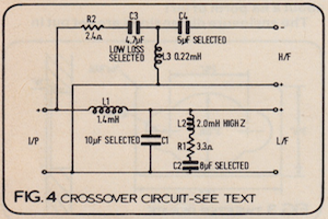

I misread the Tabor filter.
816374d1581443048-looking-audax-hd20b25h-mid-bass-driver-tabor-png
That LCR is 2mH/3.3R/8uF and I'll run a sim.

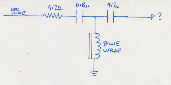

Good progress here. I can't quite figure out the bass filter beyond a 3.3uF cap, 2 coils and 2 resistors, but the tweeter looks like 4th order with 4.7uF and 6.8uF. Sort of thing I build. These sort of things are often negative polarity on tweeter.

We could do with the resistor values here. You need measuring equipment for coils, so we must wing it there.

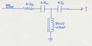

It's hard to make out from the photos but this is what I've got.
Obviously we have no idea what the inductors are but....
I'm quite sure the woofer branch is correct. Just missing the cap value.
The tweeter branch is problematic. Aren't the caps reversed? I couldn't make out what happens after that with the white thing and the red wrapped coil but it ends up connecting the 12X9 reversed phased. The red wire which is soldered to ground on the board going to the red terminal on the 12X9. It also seems that the input resistor on the input to the tweeter section is pretty large. It's almost double the value in the Tabor.

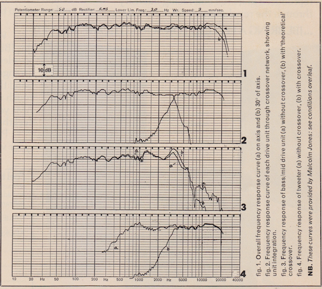

I also thought the graphs for the Tabor might be useful to Steve.
Hmm, that woofer looks a stinker to equalize, but the LCR must be doing it! Usual negative polarity 3.5kHz crossover. Lined the phase up with a woofer that is recessed about 5cm on acoustic centre. Half a wavelength, you see.

Here's the new and improved drawing. It's a little crooked but hey, I was using a Guiness coaster as a straight edge.
Steve is probably more organized (and experienced) with Sim programs so he'll probably get to this before I do.
Hopefully, it will just take a bit of tweeking to make this crossover work with some other woofer.
Chris
That's a good and useful schematic, Chris. I'd usually mirror image the backview in Windows Paint to figure it out, but trust you on that.
I'll sim it and the variations now with Visaton Boxsim. I might use the Visaton W170S-8 to see how it behaves electrically, since we seem to be looking at 25 ohms at 10kHz for these drivers.

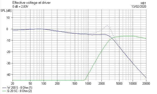

I made a mistake on the bass shunt of the Lentek S4 circuit with 33R instead of 47R, but the result applies:

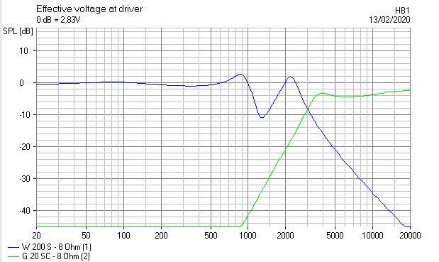

This is the Tabor after filtering:
816582d1581509607-looking-audax-hd20b25h-mid-bass-driver-tabor_graph-png

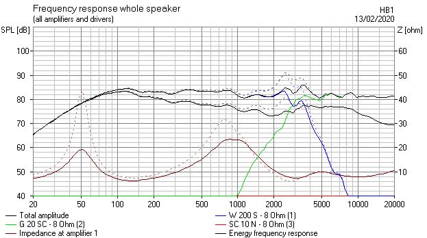

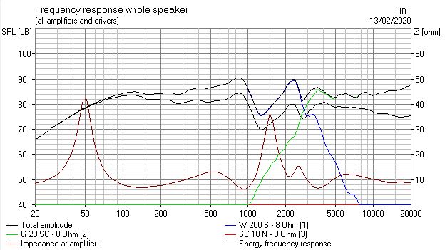

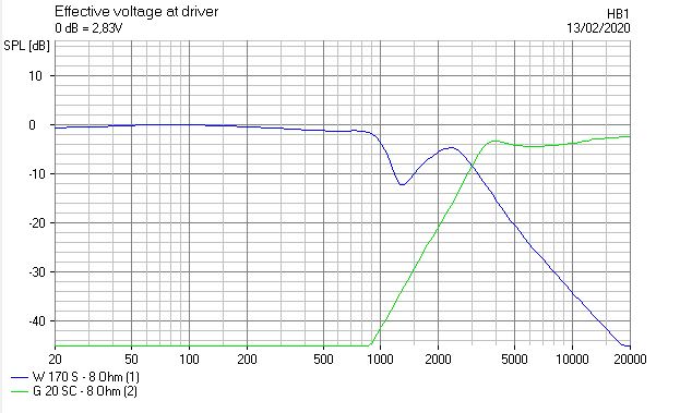

Below are some simulations. The Tabor is a very driver specific circuit. 1.3kHz deep notch as expected. Works best with a similar W170S driver as I also expected. Not much bafflestep.
The Lentek S4 is not driver specific at all. Lots of bafflestep. The bass shunt resistor, which I mistakenly put in 33R for does a lot to control the Q of the circuit. It also heavily influences impedance and must run very hot.
