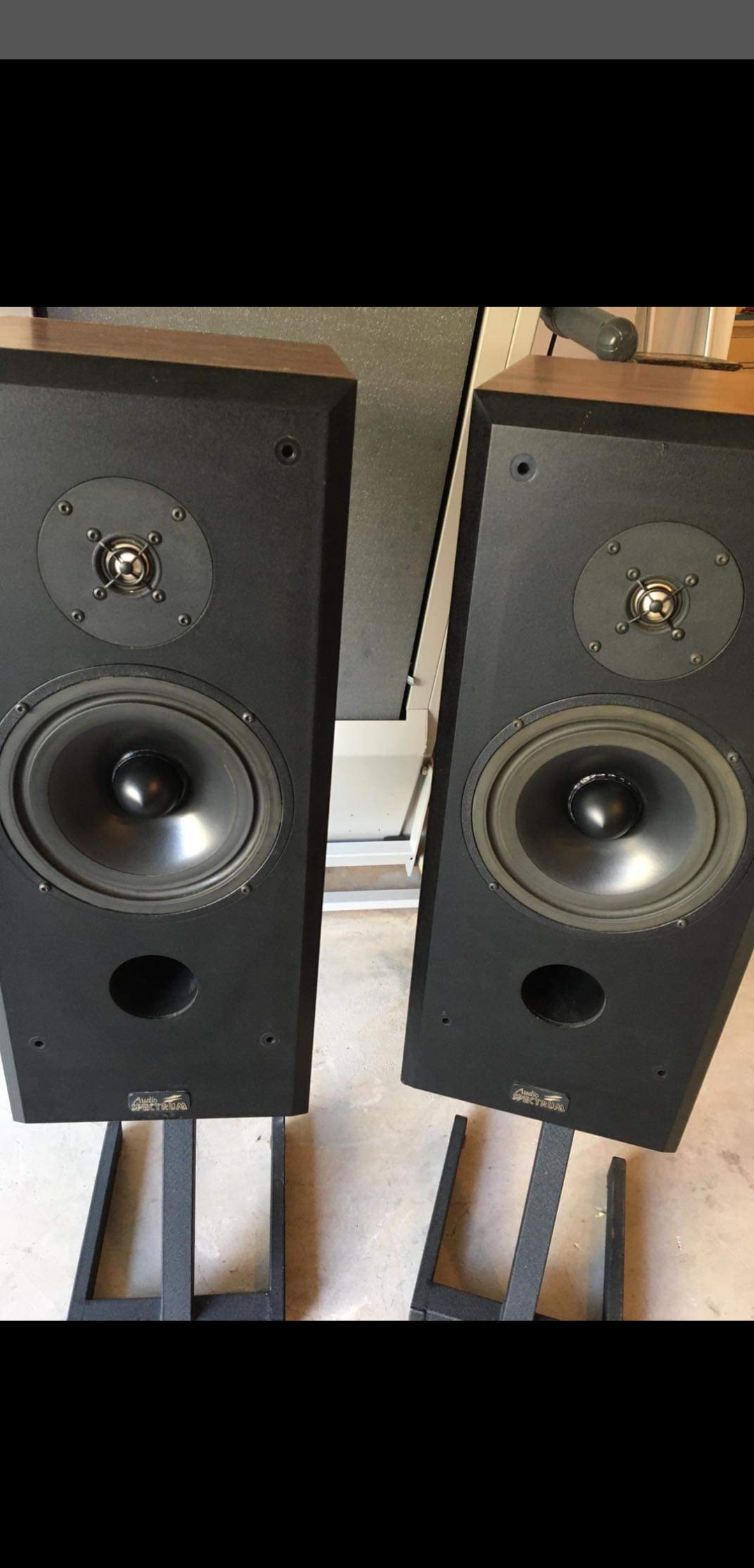

hi guys
Ill measure the box - cabinet thickness.
Im still not sure what it is I need to replace and with what.
Would it be possible to refer to my scribblings and say the white "box" no ref. X needs to be replaced with a "Dibby dobby" etc.
Sorry for being dim and I really appreciate you guys patience and time.
My budget is probably £100 - £150 at a push and Im pretty keen to retain the S4s where practical but if a noobie like me runs the risk of screwing the whole thing then mmmmmmm.
I have a soldering iron already and can solder and have basic cabinet alteration skills (ish)
cheers
Hey,
So obviously the woofers would get changed out and the alterations to the crossover could be crouched in "remove white square thingy next to yellow wrapped coil" type language.
Some of the woofers I looked at would eat your whole budget just for one. The Seas unit I suggested is a good price and the replacement crossover bits should just be a few £. Some of these parts are, I think, right off the end of the "stupid" price scale. As I said, if this project costs too much or gets too complicated you'd be better off just getting some other used speakers.
We'll see what Steve says.
Whilst you're measuring, don't forget to do the woofer hole and it's rebate.

I wouldn't worry about the cabinet too much. It's 30L of closed box. End of.
In theory you should use about 60L with an 8", but who wants that sort of huge lump in their living room, here being bassier reflex:

AFAIK, Falcon do free shipping to anywhere in the UK bar Rockall and Shetland. Honestly, I'd just get these bargain SEAS woofers for about £84 and be done with it.
Seas P21RE/P H0942-08 Woofer. H0313 2015 remake
These are a giveaway. Solid chassis, phase plugs. Maybe a slight weakness on aluminium formers. But not a show-stopper. We can fix any tonal problems for a few quid. Trust me. :)

In my digging around, I realized that the commonly available, terrible scan of the HD20B25 is for the 2 layer voice coil not the 4 layer. The Tabor was the 4 layer. I spent over an hour trying to find something on the internet. Failure. At this point with the surrounds failing it's not like it's necessary for new designs but it might be useful for finding good replacements. It probably is more important for vented boxes. I'll email Falcon at some point and see if Jerry has it somewhere. They should, they designed the Tabor.
The most important measurements are the woofer hole and rebate to make sure a replacement will fit. The Seas unit will be fine in the S4 box but the other measurements are easy and are important for posterity.

We have done the due diligence here and established the Lentek S4 crossover is fairly flat in response. Sure, you don't know till you try it, but I don't think there will be much to adjust.

I'll measure the cabinets once the holes and rebates etc. And post. I will go for the Seas drivers once I can check they will fit. So just waiting to see if there are any replacement bits needed for the cross over's.

I think there is a good chance everything will work first time with the new woofers. If anything, the tweeter will sound quieter, and that's never offensive.
Me, I'd redesign the crossover, but that's just me. I have a huge box of bits and a fine drill bit to make new holes in a crossover board to fit them. And I have a good ear for a couple of dB excess loudness or quietness. Usually just use a favourite and familiar recording.
But really, I'd just see how it goes for now. Nothing will break.
Technically, no. It isn't "speaker magic" or anything. It will work without it.
It was just acting as a stiffener. I've seen some things like that before, just not that plain. It kind of depends on how thick the panels are. If they're 10-12mm, a back panel stiffener would be good. If they're 18-19mm then no not really.
If you do have the thinner panels it would be easier to install a more conventional brace like the one in the plan below which is the enclosure for the Tabor I'm always on about. It's also almost exactly the same as the Lentek S5. The circular hole below the woofer hole is for the port which S4's didn't have but S5's did.

Yup, I'd skip the wooden brace on the magnet to the back panel. It's probably what got the drivers into trouble in the first place, breaking off the magnet. :mad:
Anyway, the new SEAS have a cast chassis so should be fairly inert. I'd just screw them to the front panel where the timber is thickest. Don't know if you need a gasket, but those can be made from cardboard.

Playing something bass heavy like Reggae and use your balance control to go back and forth to see if it's the same in both channels. If it's OK when full left or full right but light in the middle it could be that one woofer is wired plus to minus. If just one is light, it's probably a leak.
New woofers woof better once run for a while but if it's really light, it's probably a wiring error or leakage.
Pan left then right both speakers very weak bass. In the middle same weak bass. Could it be leakage in both? I sealed all round new driver before placing on baffle, checked all foam. Checked that baffle is tight. Breaking them in; they would have to change pretty drastically to improve.
Is it a cross over thing?
I've checked wires and it is all red to red correctly wired.
