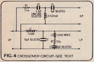

Crossover might be this sort of thing, albeit 4th order negative polarity tweeter:

Also, a possible crossover might resemble the one in the Tabor.

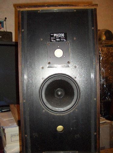

I certainly wasn't tempted by the £200 Chartwell PM200 variation:

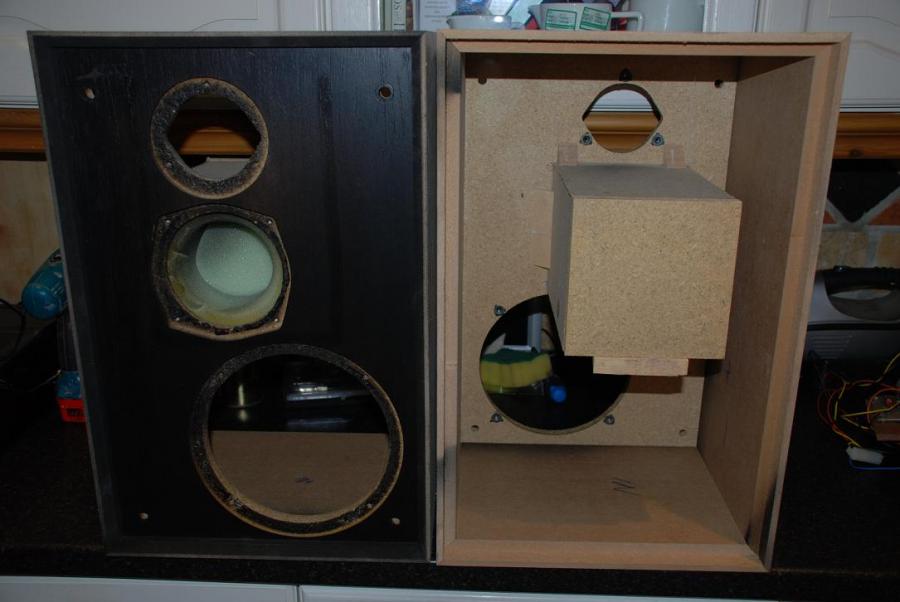

How's it done? Mainly a midrange enclosure:
Bit of spongey stuffing for the bass:

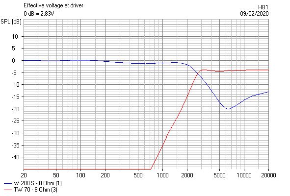

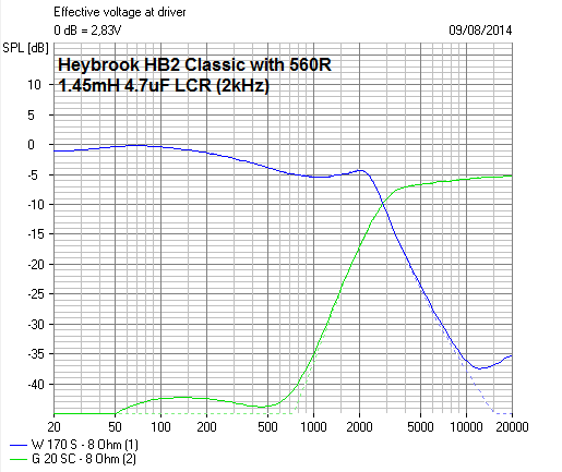

The basic theory is mathematical. Most people do something called Linkwitz-Riley LR4:
What you can't see is a thing called bafflestep, which adjusts for the cabinet's bass response. I won't go into that now.

Boxsim has an optimiser which does a lot of the work for you. You mark components in red and it just does its thing to align it all. What is for sure, is people will help you if you get bogged down.

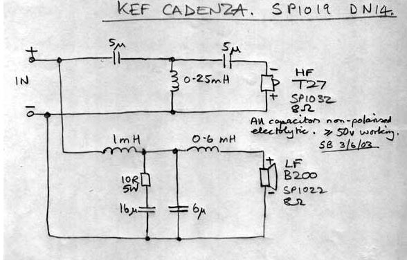

Low inductance woofer for sure. A little breakup notch somewhere around 5kHz. All good.
I do stuff like this myself, here with a high inductance woofer.

I'm not even sure if this Lentek S4 is reflex or closed box. But we can fix it.

I found a picture of the inside of the S4. I see what you mean about the hunk of wood.
