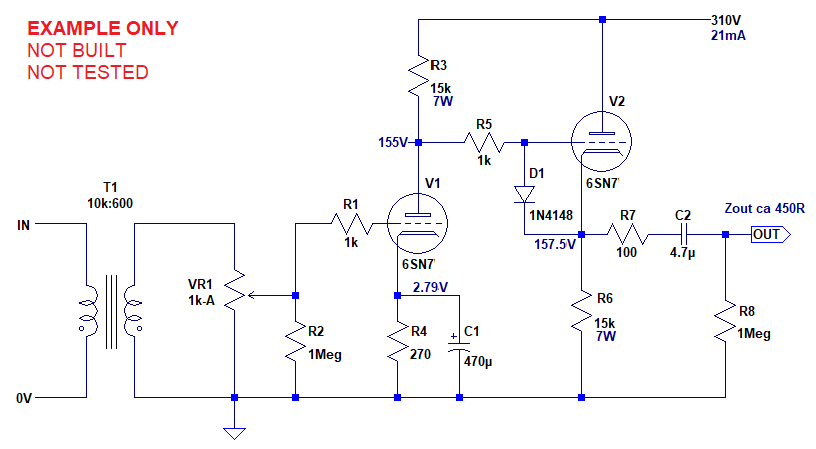

I would suggest using a step down transformer from the pro audio industry such as 4:1 ratio or 10K:600Ω. That way, you can use common audio tubes like 12AU7 or 6SN7 without feedback to have gain of 3 or 4 or 5 (depends one how the tube plate is loaded). Some even have 8:1 ratio if you're stuck with high gain tubes like 12AX7 or 6SL7. And volume control can be low value from 600Ω to 2K. Also step-down transformers tend to have wider bandwidth than step-up ones. 10K or 15K is high enough input impedance to be driven by most sources. As a bonus you get balance input and can break ground loop. And to my ears, they sound better subjectively over straight to the pot. If your source can drive 600Ω, you can even flip around and have 1:4 step-up in front of a cathode follower. Use your creativity.
I really like this idea of using a 4:1 transformer at the input followed by a common cathode triode with gain of about 15x. In the end that will make a line stage with about 3X gain (or thereabouts).
It seems suitable quality 4:1 audio transformers are expensive. The Hammond one is open frame (no mu-metal case), so that's probably out of the running. The Jensen JT-10KB-D (10k:600) looks right, but it's $70 each, so that's $140 for a pair. This transformer does have a mu-metal can. The extra expense is all that would stop me from going this way. I would like to try this, though.
I'd use it on the input with a 6N6P or ECC99 common cathode stage, so the Zout would be roughly 2k ohms (maybe lower) and the total gain would be about +11dB (about 3.5X).

And finally, one could use a 4:1 input transformer to reduce the gain of the incoming signal (by 4X), so that 2V signal would now be 500mV. That would be followed by a triode common cathode amplifier stage, perhaps a 6N6P with gain of about 15X. The end result would be a line stage with gain of about 3X, high input impedance, galvanic isolation of its input, and decently low output impedance -- and all with no negative feedback loop applied (if that's important to you).

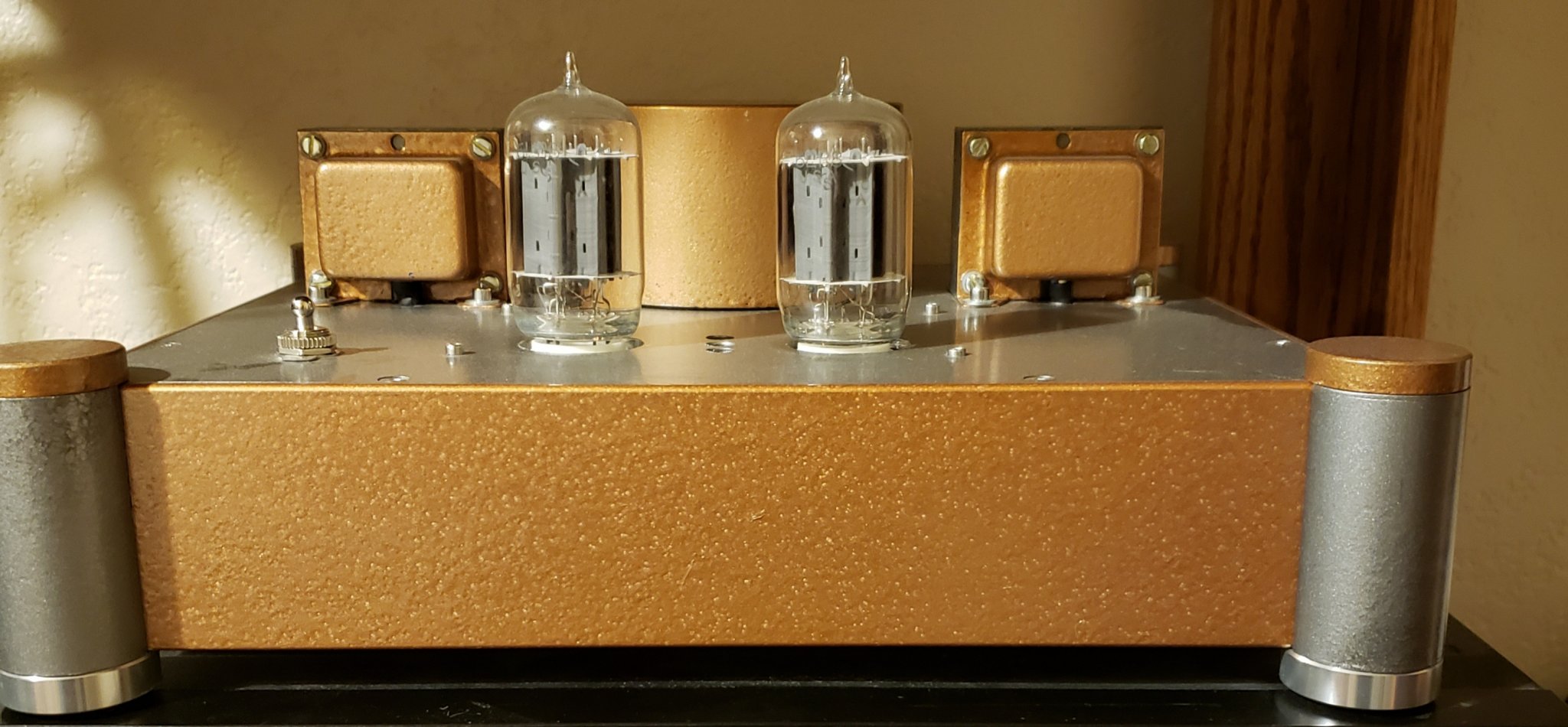

I built a preamp once using mic transformers at the input, then a single 6J5 per channel and another transformer for output. I modified an old RCA mic preamp schematic to build it.

Here's an idea I had after directdriver's suggestions...
A pair of input transformers is going to cost a fair amount of money, and output transformers would be a complication (the thread does say 'simple'). So I figure the 4:1 input transformer is the important ingredient, and a cathode follower will drop the output impedance down to <500 ohms.
Does that count as simple? Or is that not simple enough?
There are mic transformers that are also suitable for line use such as UTC A-10 and HA-100X (500:50K) which were used in the different versions of the Teletronix LA2A opto compressor. With 1:10 step-up ratio going into a cathode follower AND a step-down output transformer (10K:600) you'd still have some gain left, less than 2.5 times!
Your 6J5 is likely wired as a gain stage so is your mic tranny wired backwards as step-down? Was it the RCA BA-2C? Any schematic?

It's been about 12 years since I built the thing. I pased it along to someone else a year later. I'm pretty sure the transformers I used at the input were UTC-10's though. For output I used Edcores, I do believe they were 10K or so:600's. I no longer have the RCA schematic. I do rember it sounding very clean and clear. The BA-2C sounds about right though. It had plenty of gain for my needs.

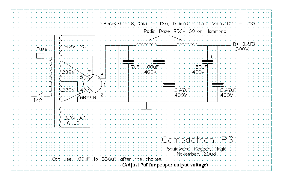

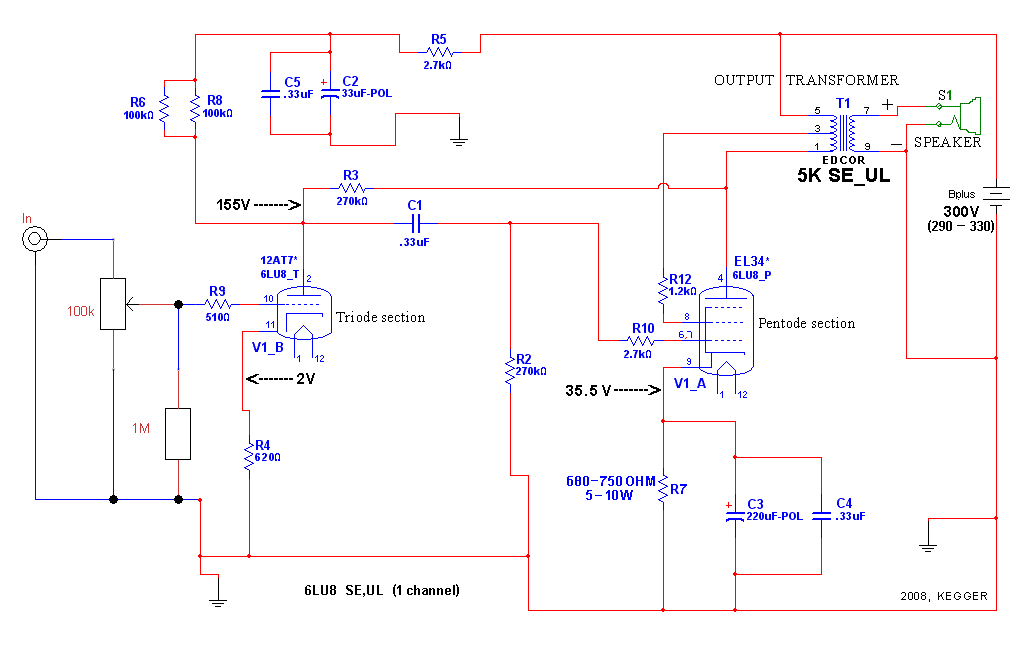

I've landed on this one as this is simple, I have 95% of the parts, it is for my desk so won't be using for critical listening. The chain is Qobuz on computer - simple preamp - 6LU8 compactron amp - Severely cobbled up RS Minimus 11s speakers.
