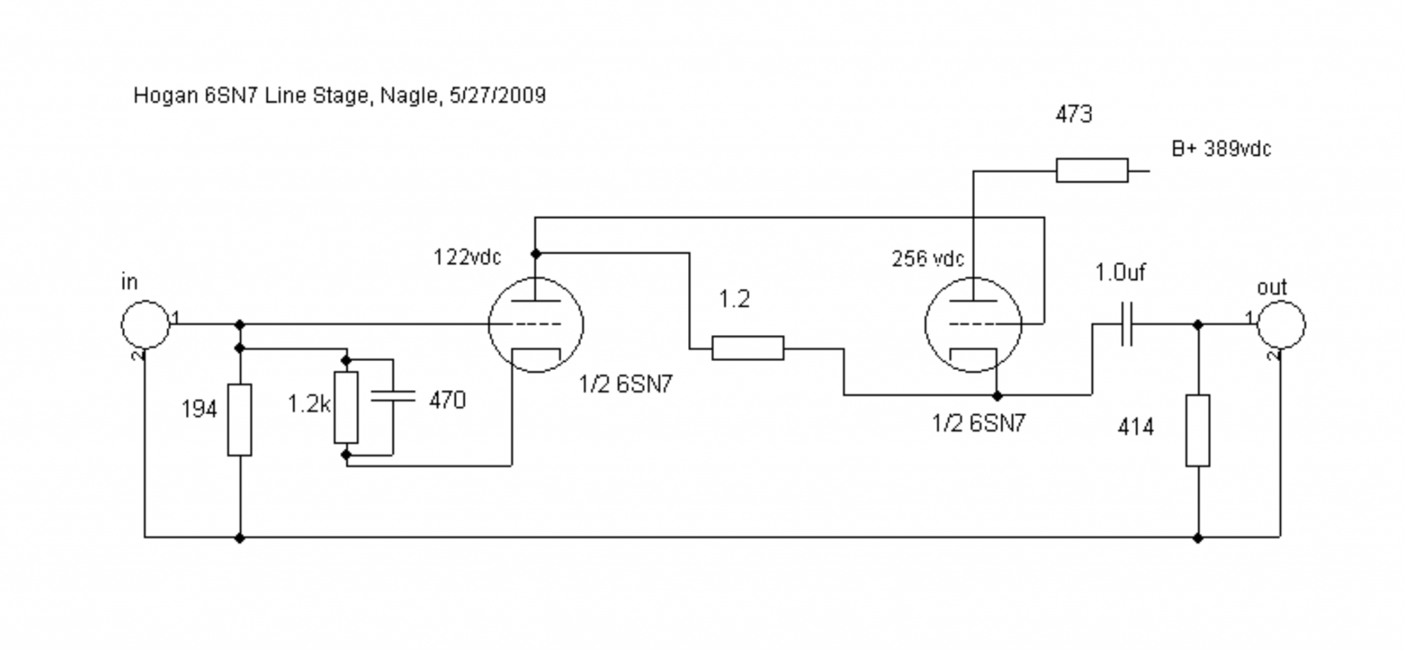

That looks very much like the John Hogan SRPP 6SN7 preamp I use to have. I loved the sound of it. I agree Steve: As these speakers are, more or less, in my face I don't need that much gain, however, I have noticed all these years, that gain = dynamics and I fear I would not get that with just a buffer.

The blue velvet is a typical gain stage driving an anode follower with plate to grid feedback. It is not a buffer and the gain is approximately 12db in the configuration in the link.
The only tests I have were done with the volume pot at full volume. I used an HP analyzer and the distortion was 0.1% at 100mv rising to 0.2% at 1 volt and 0.4% at 2 volts output. At 5 Volts it was 1% and that was the limit of my tests since that was sufficient to drive my power amps into heavy clipping.

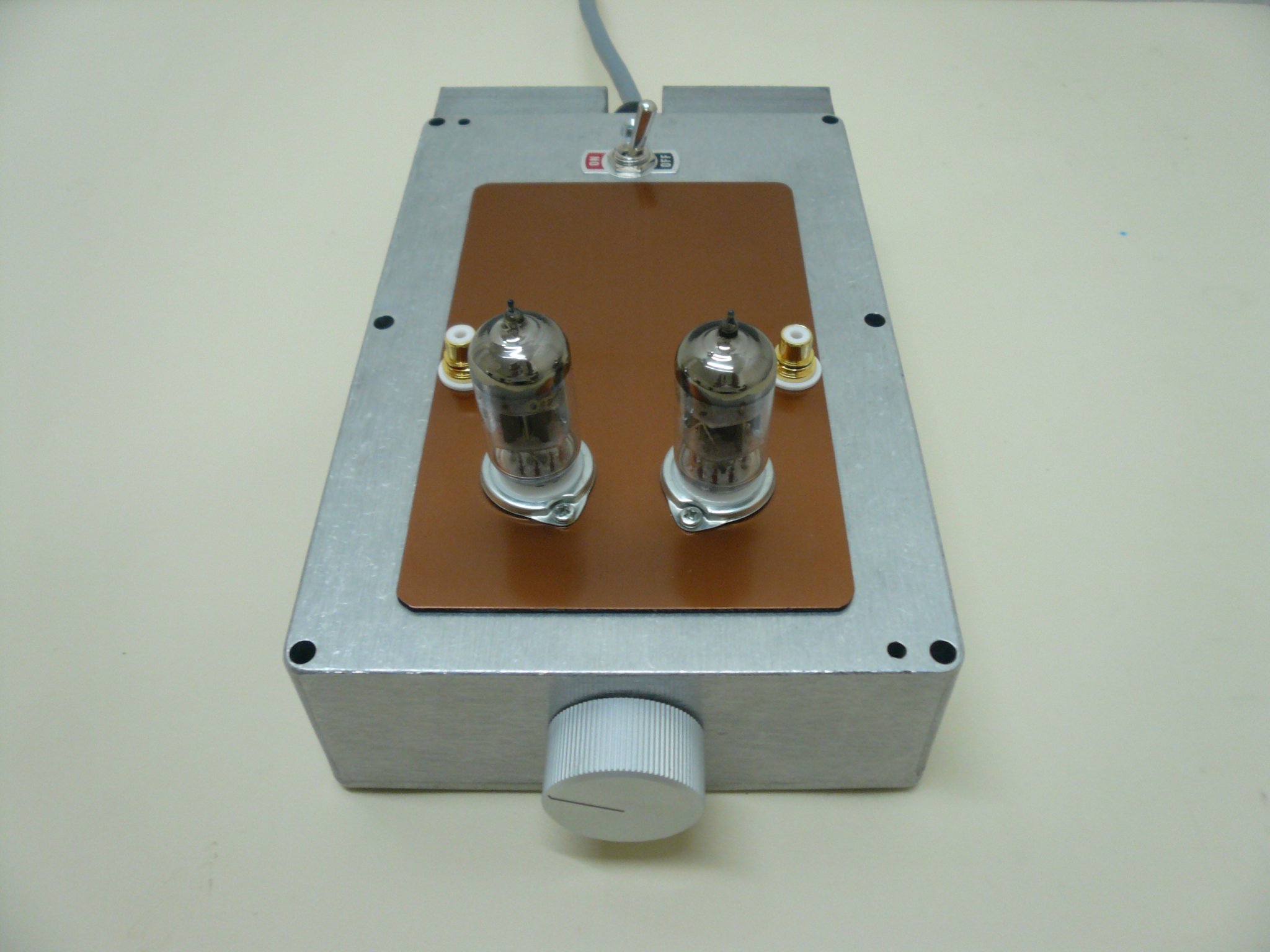

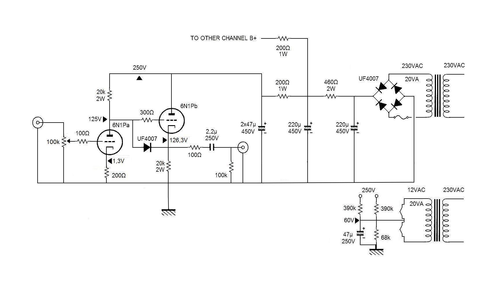

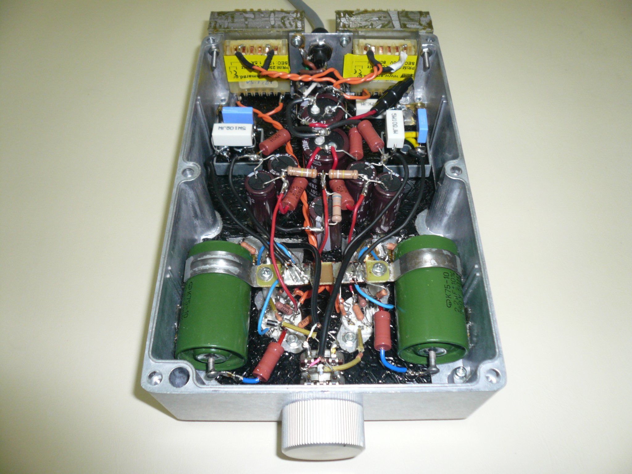

CCDA? A tube preamp can only be as simple as its psu.
