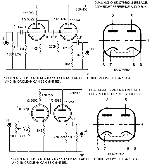

I would add a proper 1M ohm grid leak resistor on the 12B4A, instead of letting the pot be the grid leak. What happens if the wiper loses contact with the track? But that's a quibble.
I'd also reduce the value of the pot to 50k, or perhaps 20k, depending on the Zout of my sources. Another minor quibble.
I found these tubes in my pile up but the 9H 250ma choke seems large.
And this one?
This is a dumb question but if I don't need a bunch of gain can I use 300Bs or 2A3s or 45s???
Of course you can. You can use pretty nuch any triode or triode-wired tetrode/pentode than has an acceptable plate resistance.
