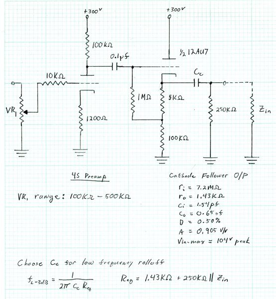

I use the 4S with cathode follower, still have a lot of gain. Maybe i must use 2 x 12au7. View attachment 1072297
The 12AX7 will have gain of about 30X to 40X.
The cathode follower will have gain of about 0.9X.
35*0.9 = 31.5X gain (30dB).
We want something like 3X gain (9.5dB).
You would need to introduce about 20dB of negative feedback to reduce the gain of that 12AX7 down to 3X.
If you substitute a 12AU7 for the 12AX7 first triode, then the gain will be about 10X (20dB).
Again, we want something like 3X gain (9.5dB).
You would need to introduce about 10dB of negative feedback to reduce the gain of that 12AU7 down to 3X.
In both cases, you will need to introduce negative feedback to get the gain down to 3X (9.5dB).

As I said earlier, if you don't need much gain, why start with a tube that has much more gain than you need and then dump most of the signal to ground?
Yes, but excess gain can be put to good use through the introduction of negative feedback. Unfortunately...
There seems to be a widespread aversion to any form of negative feedback imposed on a circuit (while forgetting the internal feedback mechanism in all triodes, or the degenerative feedback produced by leaving a cathode load resistor unbypassed), along with the fact that there are practically no suitable triodes with mu = 2 or 3.
So now we're stuck.
There are no triodes that have mu = 2 or 3.
Most triodes have mu of 10 to 20. (6V6-triode has mu = 8 to 10, 6N6P has mu = 15, 6SN7 has mu = 20.)
We're not allowed to use negative feedback to reduce the gain of the triode.
That leaves us with voltage dividers (volume controls) to basically shunt the signal to ground.
Who can solve this problem?

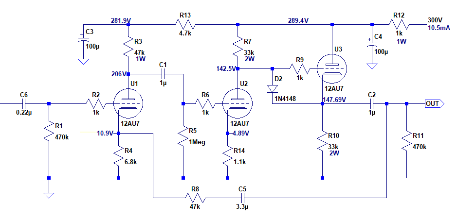

First -- Triode with local parallel negative feedback:
https://www.valvewizard.co.uk/localfeedback.html
Discussion of DC-coupled cathode follower showing use of diode (or neon lamp) for protection from excessive cathode to heater voltage:
https://www.valvewizard.co.uk/dccf.html
Here's an example of a tube circuit that uses the opposing polarity zener diodes on the output to protect solid-state amp inputs downstream from startup DC voltage overload:
https://www.valvewizard.co.uk/phonopcb2.html

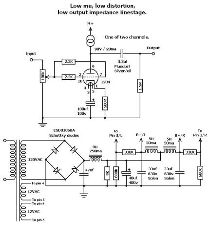

I would add a proper 1M ohm grid leak resistor on the 12B4A, instead of letting the pot be the grid leak. What happens if the wiper loses contact with the track? But that's a quibble.
I'd also reduce the value of the pot to 50k, or perhaps 20k, depending on the Zout of my sources. Another minor quibble.

To pin 3/L and 3/R is not clear to me, to the + of the 100uf 100v cap?https://www.audioasylum.com/forums/tubediy/messages/15/159939.html

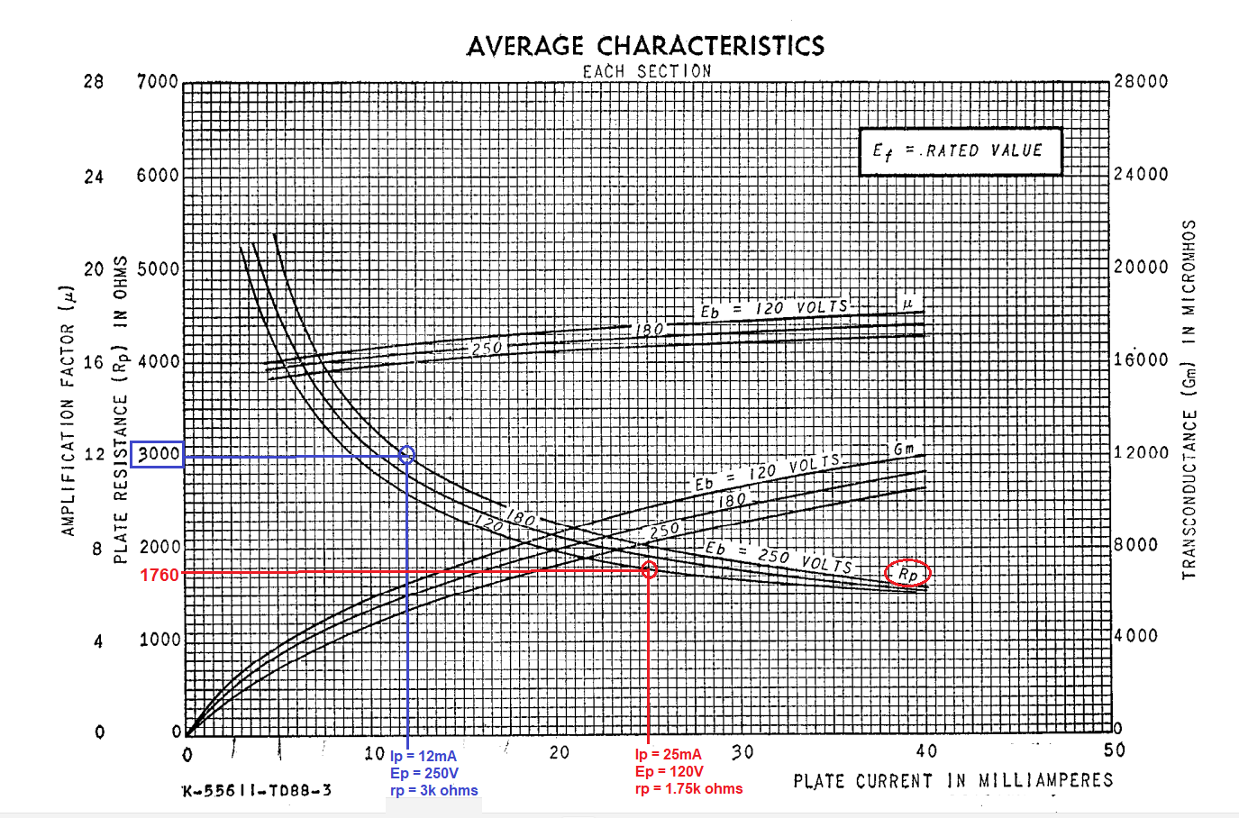

The plate resistance of any triode is somewhat variable (even though it's considered to be one of the 'tube constants'). If you take a triode and run it with a low B+ voltage and high plate current, its rp will be on the low side. If you take that same triode and run it with a higher B+ voltage and with low plate current, its rp will then be higher (sometimes significantly higher).
Here's a comparison of how rp differs at two different operating points for triode type 5687:
The rp for type 5687 can be 3k ohms, or it can be 1.75k ohms, depending on how you measure it. So, which is it? The answer depends on the operating points you choose in your design.
The advantage of this circuit is that it's non-inverting. Gain is about 6X (16dB) as shown. In simulation, the circuit has super-low THD and quite low Zout, but it rings a little if I try to apply much more negative feedback than this. I don't plan on trying to build it, but it was an interesting exercise.
I'd rather design a preamp with appropriate gain for the application, or go without any preamp at all.
There have been a couple of preamp designs posted here using shunt local NFB from plate (output) to grid (input). Another way of doing that is to use two common cathode amplifier stages into a cathode follower, and take feedback signal from the cathode follower cathode (output) back to the cathode of the first gain stage. I've seen that called a 'Ring of Three' topology.Perhaps an earlier poster expressed an aversion to using NFB, but it wasn't me. I've used NFB in amp builds but I've never thought about NFB in a preamp. Other than using an un-bypassed cathode resistor or diodes, I'm not even sure how it would be implemented. My preamp uses battery grid bias, though.
You know... I missed that. I see what you mean.
Pin 3 is the center tap of the tube's heater (filament).
Pin 1 is the tube's cathode.
Type 12B4A has a center tapped heater so that it can be run with the two halves of the heater wired in series for operation with 12.6V 0.3A, or in parallel for operation with 6.3V 0.6A.
In the schematic, there is a 100uF capacitor connecting from pin 3 (heater CT) to ground. I don't know what that's doing. Is that a drawing mistake, or is that a cathode bypass scheme I've never seen before? Or is that supposed to reduce noise from the AC heater? I really don't know.
There is a 500 ohm resistor from pin 1 (cathode) to ground. It looks like that 500R resistor is not bypassed by the 100uF capacitor, which means the gain of the triode will be reduced and its rp will be increased by way of current feedback (degeneration) as AC signal current travels through the resistor.
