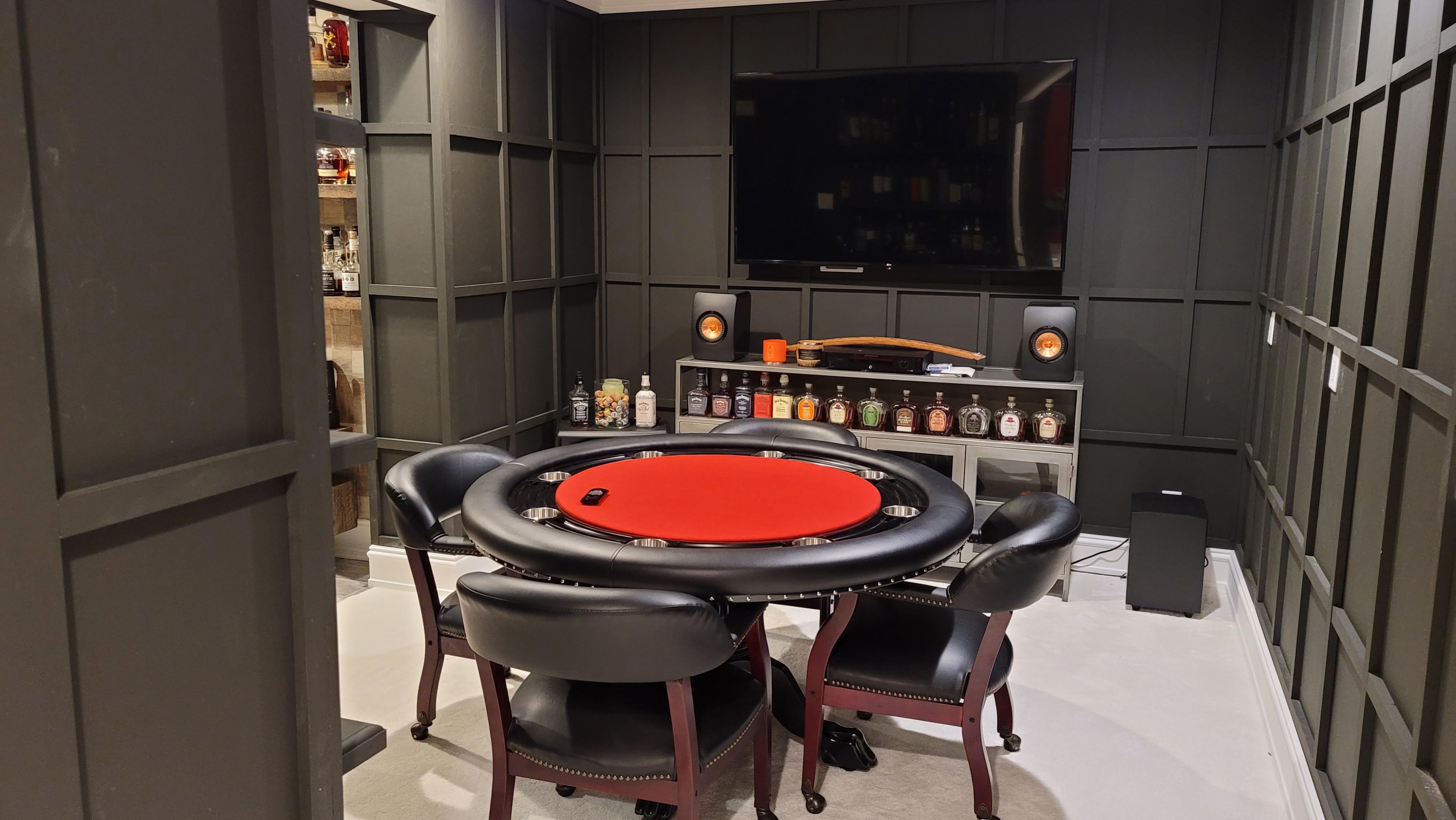

The basement space would seem more amiable to room treatments, etc. Also, given the location of that Scotch collection, I would likely prefer to spend more time down there! 😀
I think a (full) line array with Neo 8 clones and some rather excellent Dayton Audio drivers should work as long as you get the crossover low enough (near 1 kHz) AND have the front baffle extending at least a half-a-foot beyond that short side-wall leading into the hallway.

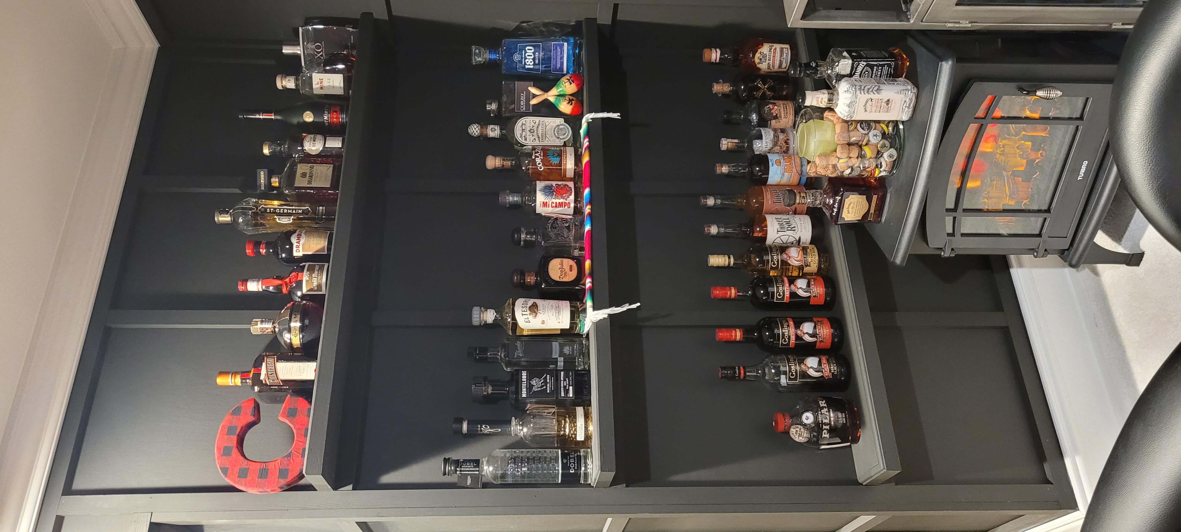

That is where we spend most of our time. Those are all empty's and that was the day we brought home the Balvenie display which has since moved to a different location.

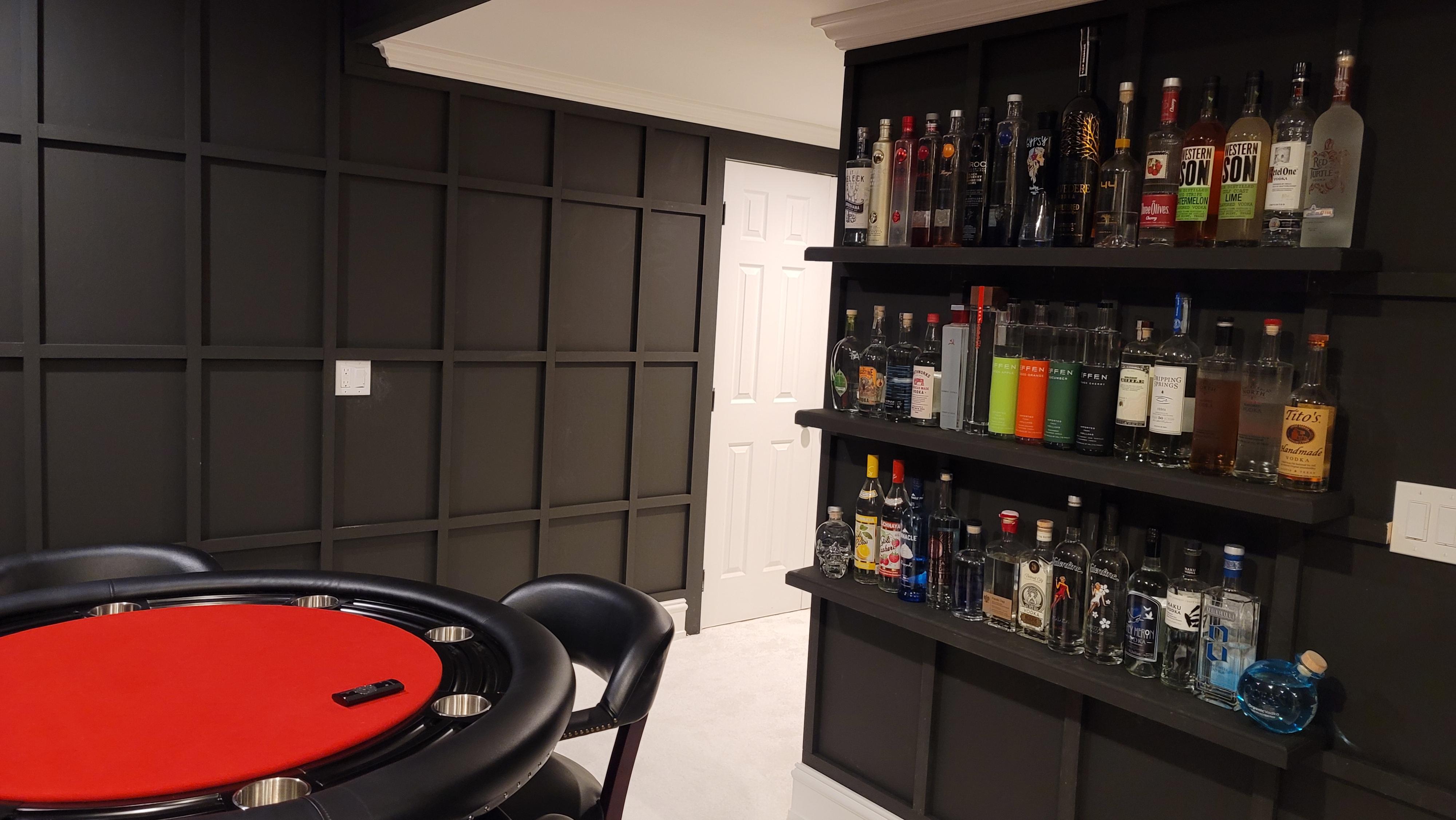

Besides music, Bourbon, Scotch, and Whiskey is another big hobby of ours. These pics are a few weeks old. We just built a poker room and finished it about 2 weeks ago.

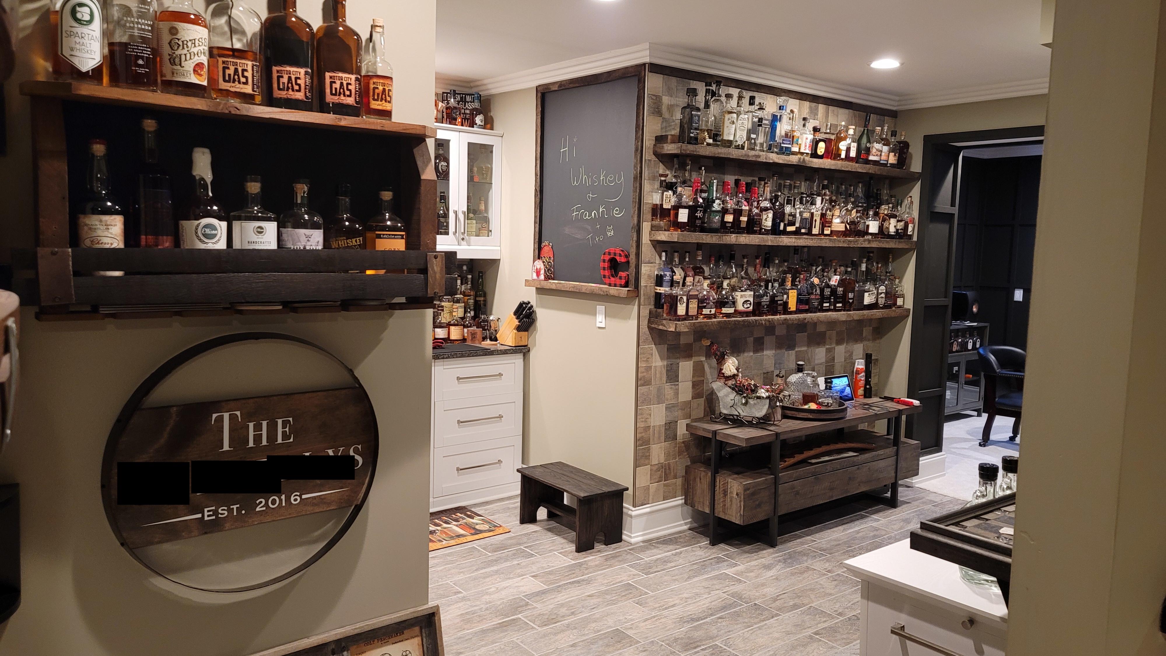

I would say this is our pride and joy and another hobby we both share. We never were really big drinkers but 4 years ago we bought a bottle of Basil Hayden and it has turned into this:

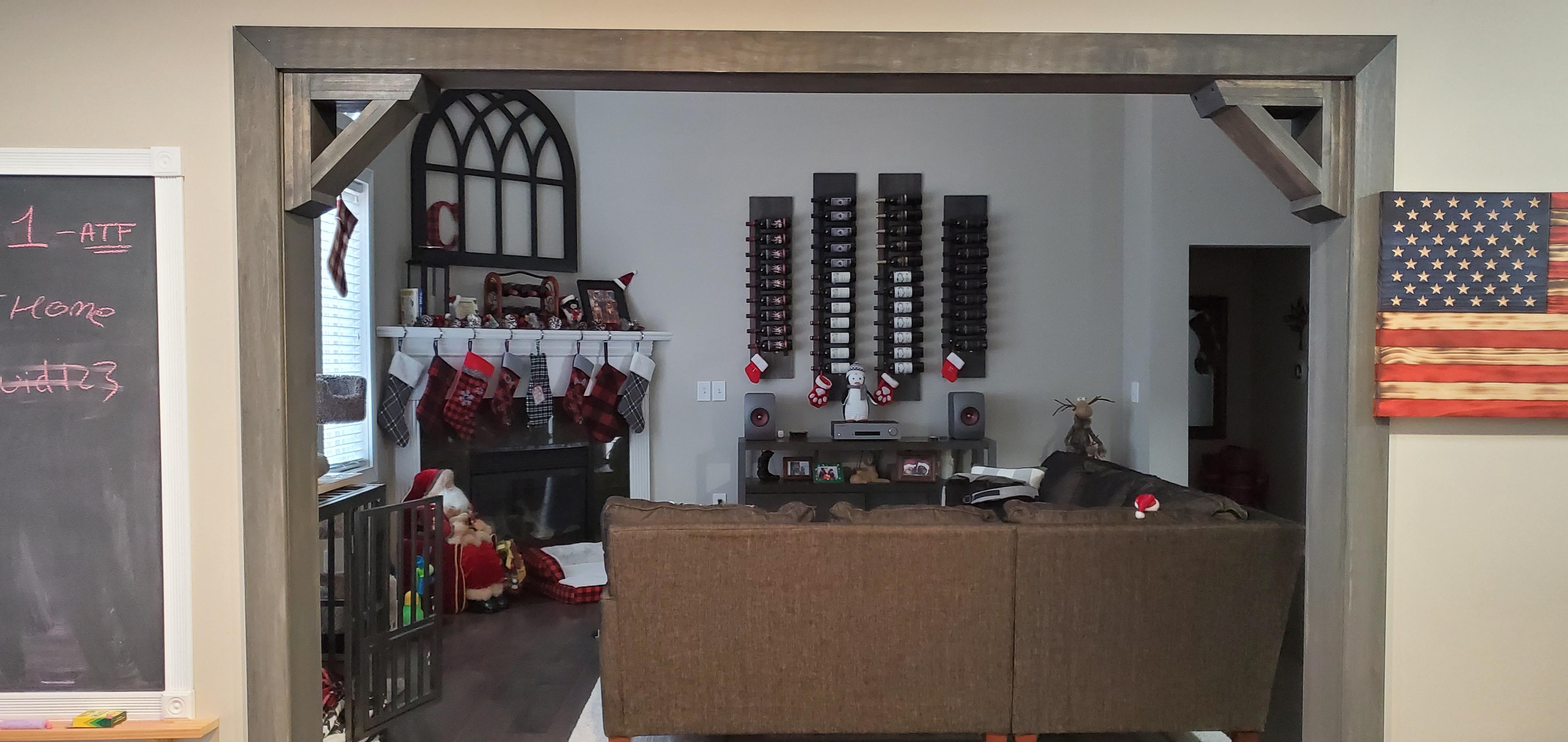

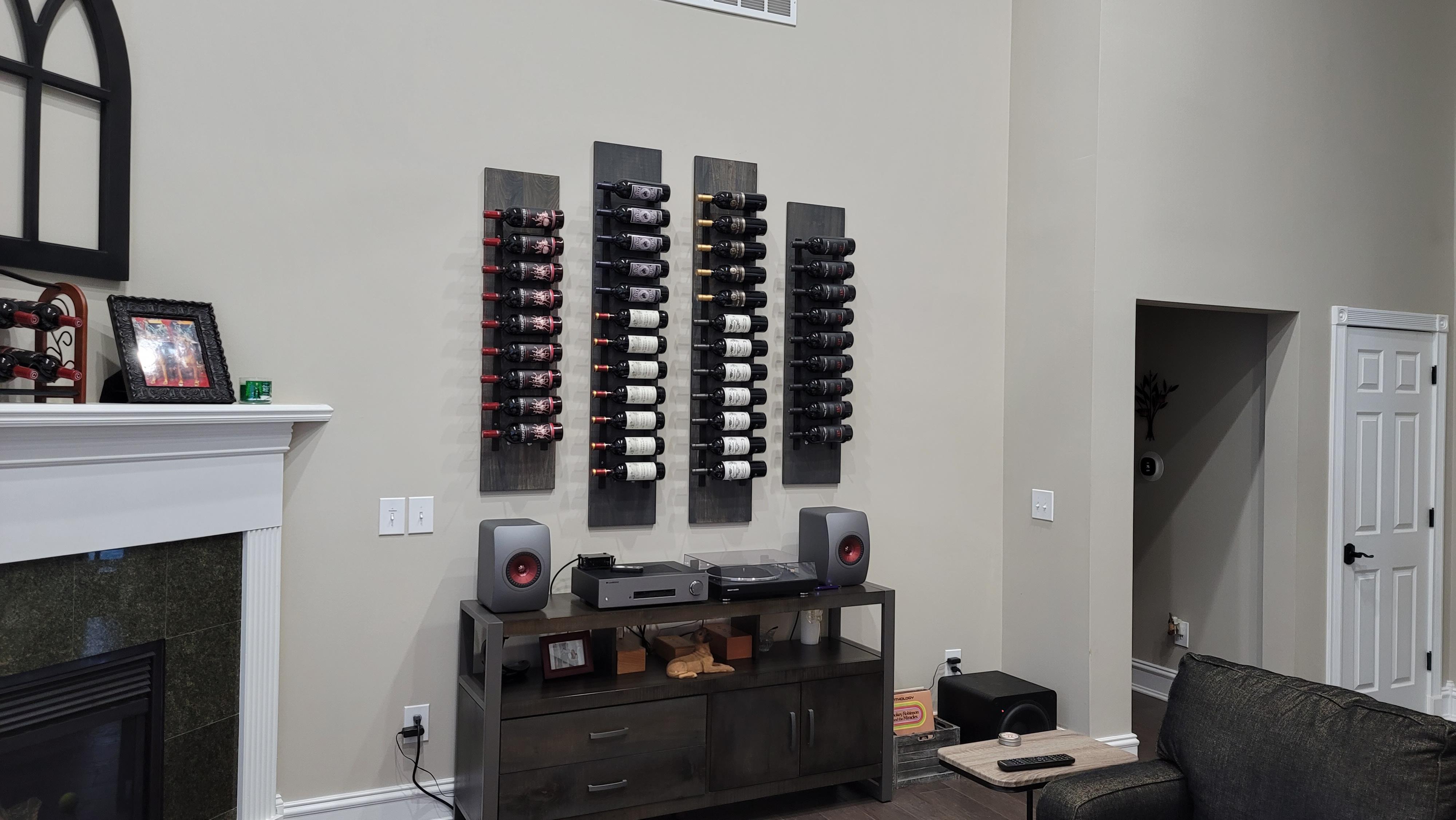

So Plan B...The basement space is much larger, ceilings are only 10' but I've got tons of room. The Salks work for one big reason the drivers are up high as we have a section of the couch about 2' away from the left speaker. We have thought of removing that if we moved to a different speaker.
I could move them upstairs and build something for downstairs. This is that space.
