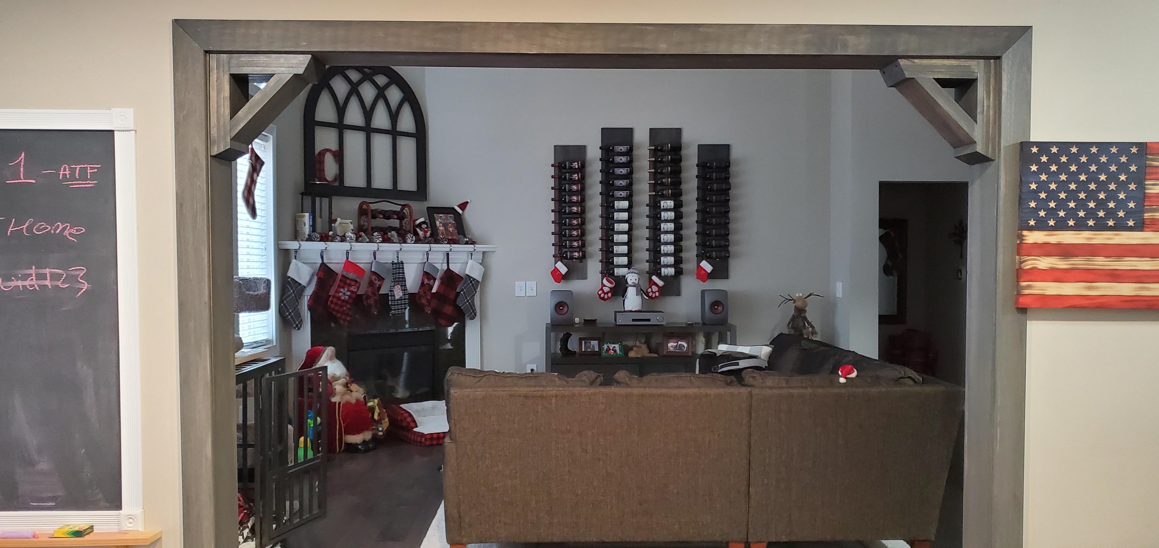

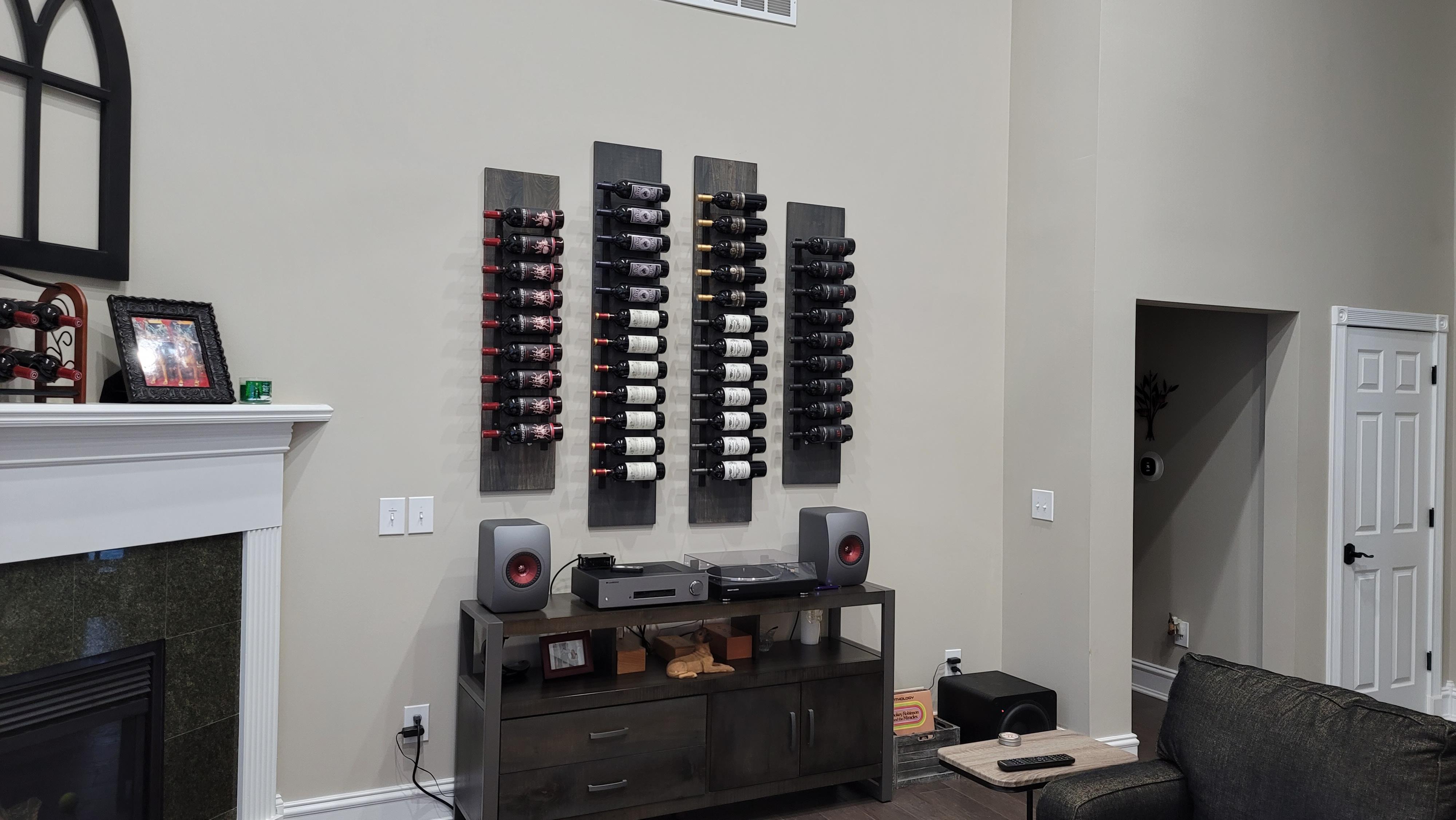

Hi, ericspt
From your two picts in post #38, my take is you don't really have much room to work with on the wine rack wall.
I think I'd probably go with line arrays there, like wesayo and many others have built, given the narrow total width between fireplace and hall wall. Especially so, if the table and wineracks are designated keepers.
Tall and straight would work; pretty easy to build and they don't need much in the way of electronics.
The other narrow line alternative, CBTs, don't look like they could fit without getting into the fireplace space. Their backward curvature forces the footprint out into the room.
If it were my room, I'd be thinking about speakers on the window wall just for all the degrees of freedom that space offers...could do about anything there.
CBTs could be a real nice showpiece there. As could any of the great ideas folks have been offering...
TY.
So I know we would rather stick to the wall where the wine rack is.
We could do it along the window and for the look of the OB's we might have changed the room but if we could leave it as it the line arrays look like a winner.
Plus the construction of the Wesayo means I can finally justify buying that 2D CNC I've been wanting 🙂
Very welcome🙂
Sounds like you would meet all your goals and be very happy, with some straight-line, tall arrays.
Whatever path you end up taking, Good Luck !!
btw, if you do go with a straight-line, i'd choose between the tc9's like in wesayso's, or the probably better albeit more costly drivers, that Jim Griffin uses.
Figure out what you want to do for sub(s) and xover frequency, budget, ....then choose which line-array driver.
my 2c

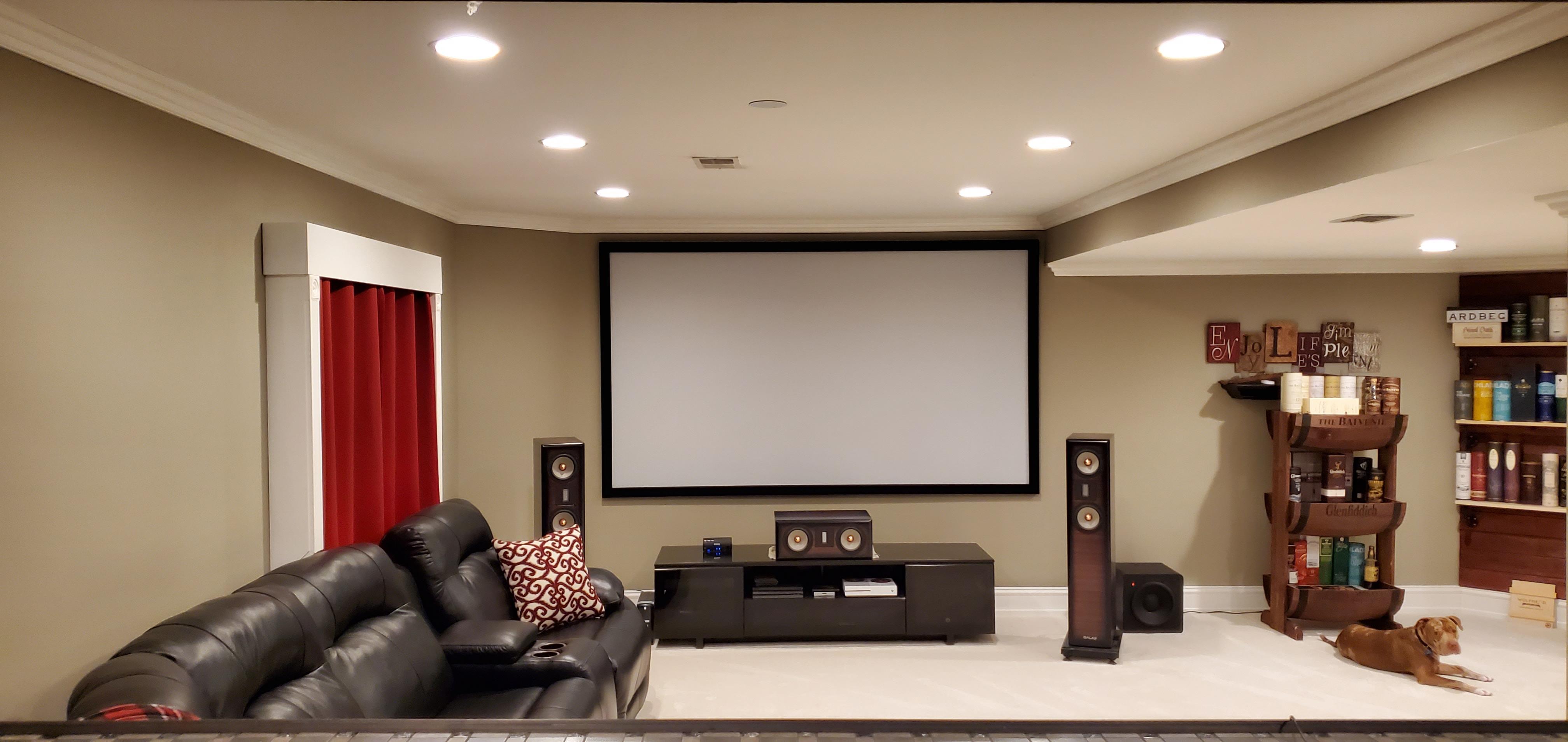

I understand the 3/4 way may be the better choice.
So Plan B...The basement space is much larger, ceilings are only 10' but I've got tons of room. The Salks work for one big reason the drivers are up high as we have a section of the couch about 2' away from the left speaker. We have thought of removing that if we moved to a different speaker.
I could move them upstairs and build something for downstairs. This is that space.
