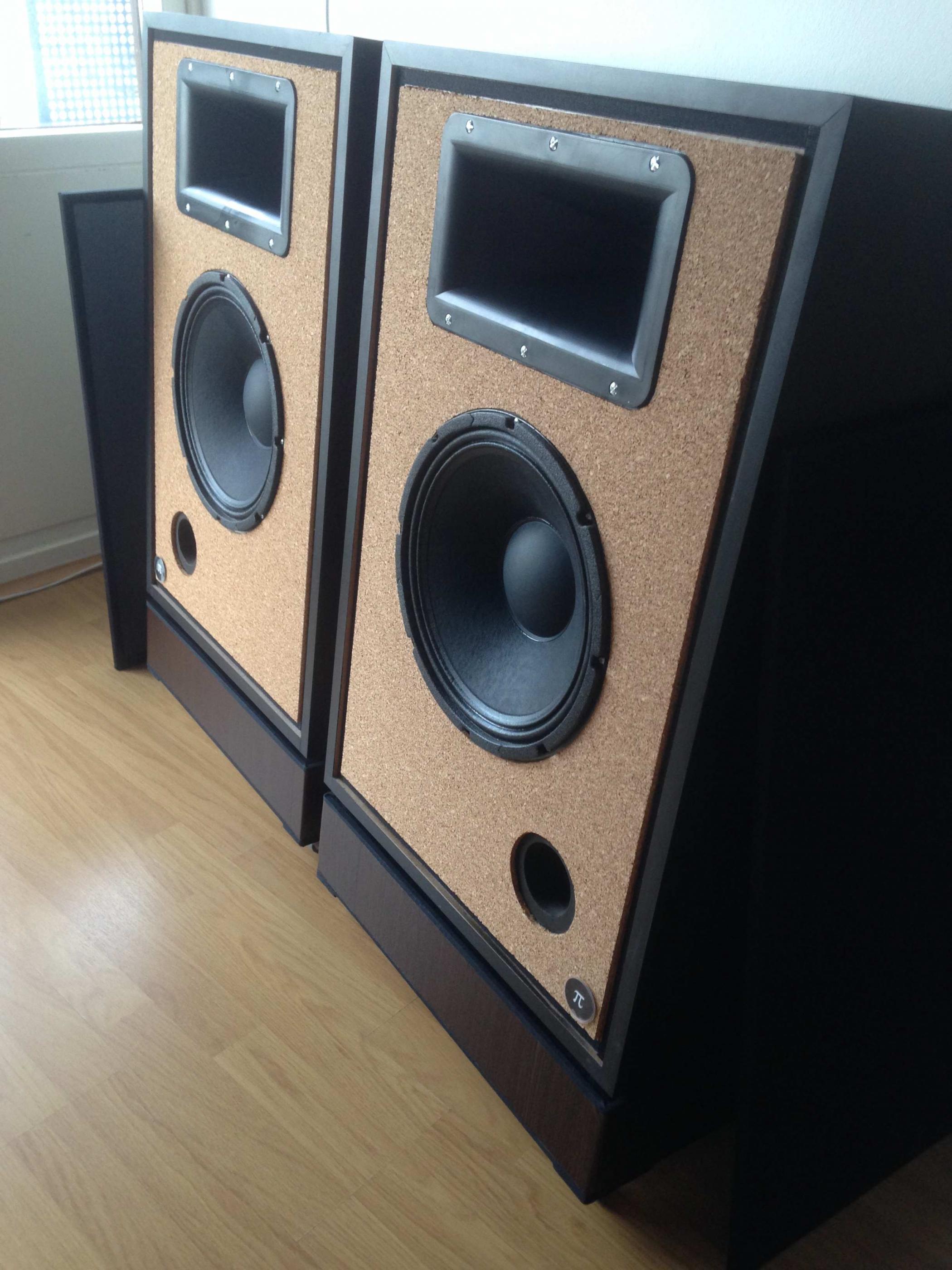

I had first hand experience with my Pi3 speakers build, due to bad WAF factor and problems with neighbors I need to say good-by to them. They were very capable of filling the room with big sound without breaking a sweat!
Actually - they were sounding better with more power fed to them.
It's a 2-way 12inch woofer with Horn, you can found more info on Pi speakers forum, there is a also 15inch version as well!

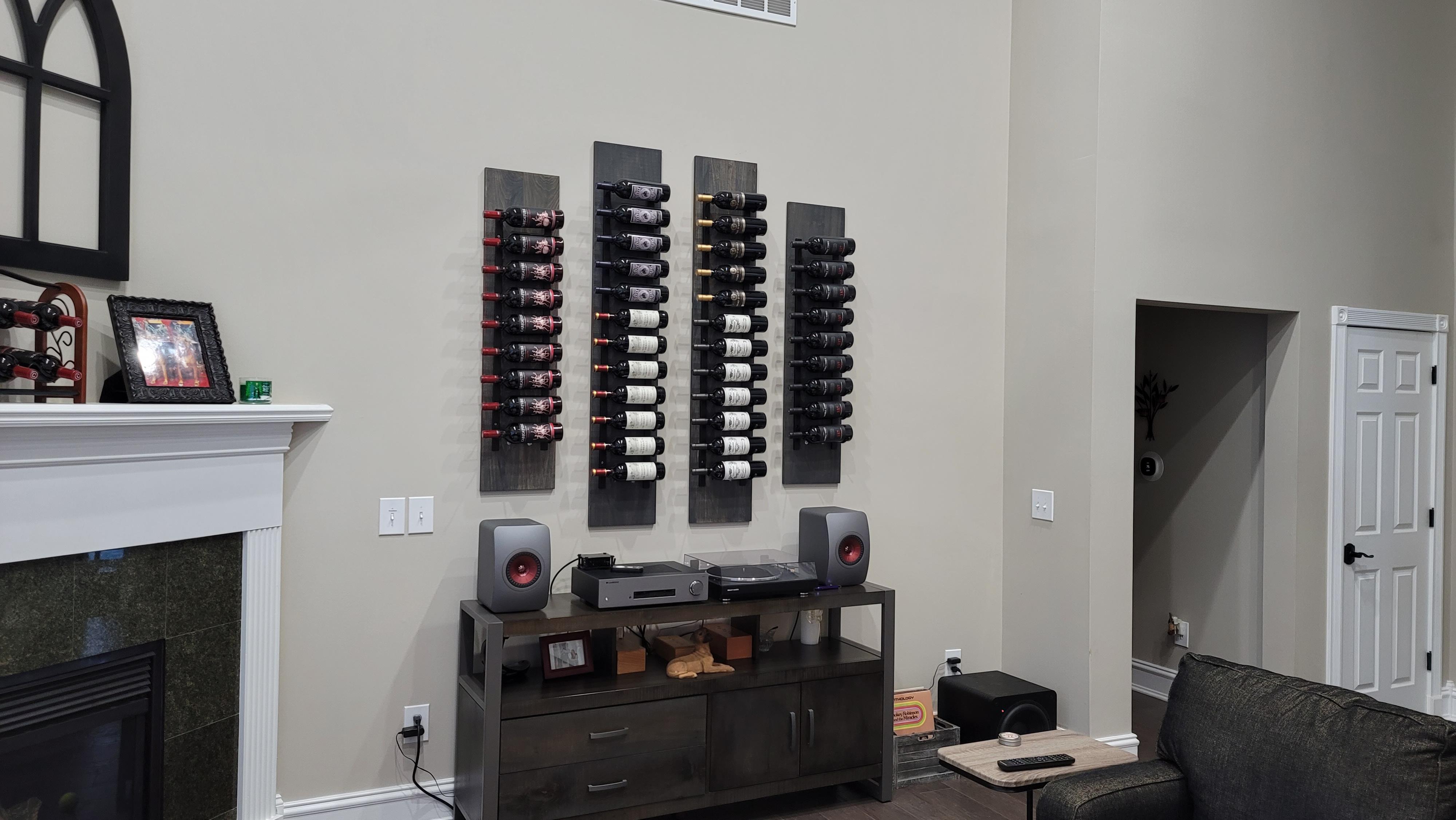

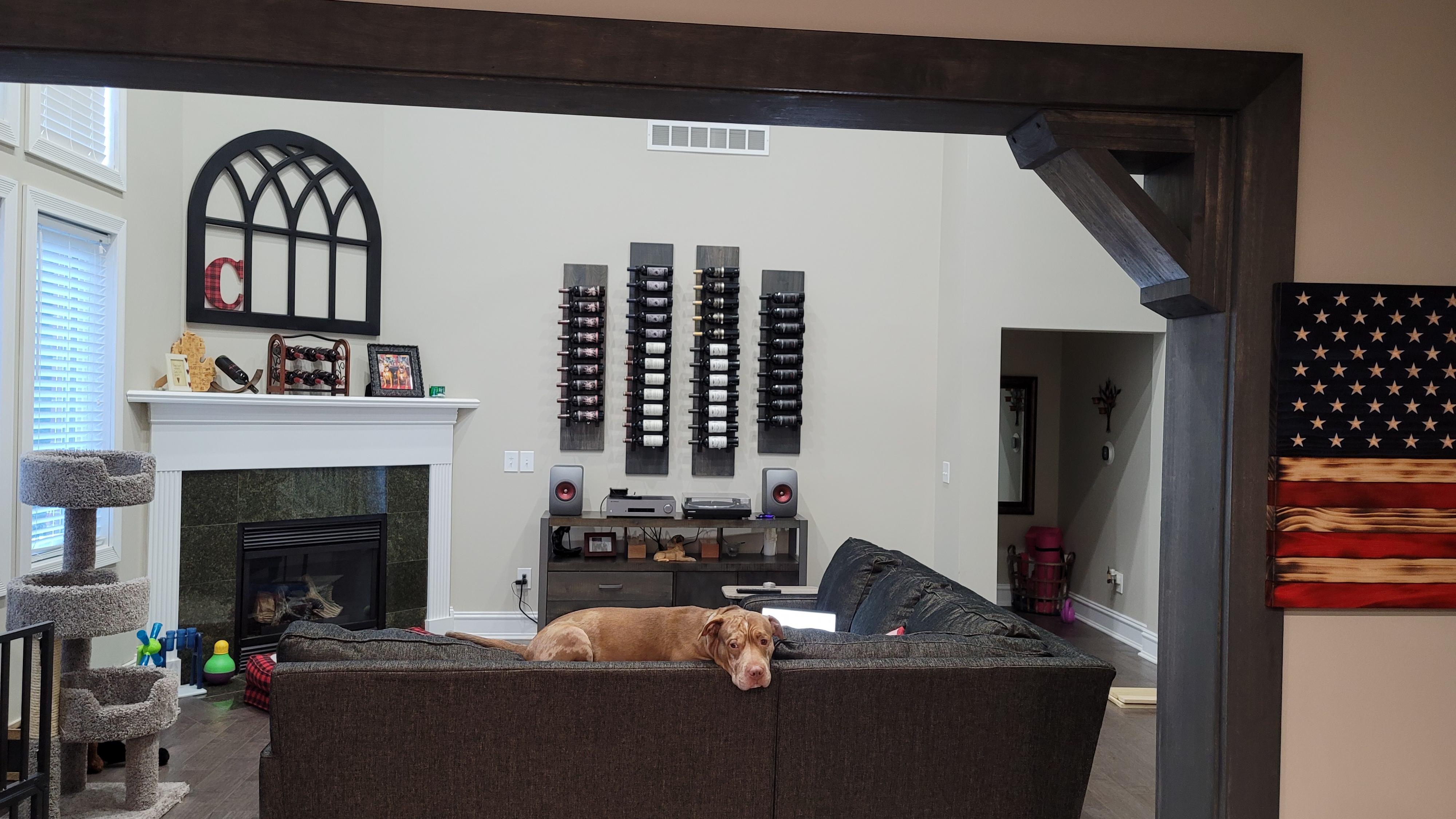

Thanks for the pics, I don't see any unusual problems. Those tall ceilings will really help.
Open Baffle works best when you can get them away from the walls. 3 feet is minimum, 4 feet is better. If that doesn't work for you, there are a number of good projects mentioned here that you could get closer to the wall. But even box speakers sound better with room to breath.

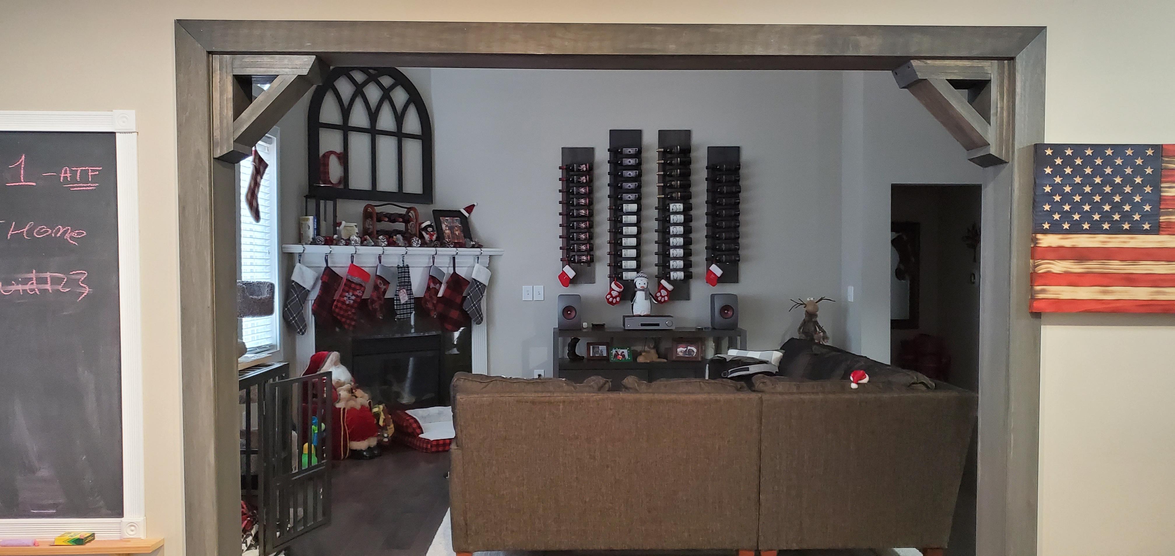

I've got a plan. We never sit in our living room, our main room is in the basement. The dogs lay on that furniture. We can shrink it down a bit, move it back a bit.
I thought it would be cool to put tracks on the floor where they could be moved in/out as needed. Set back against the wall and then slid out when listening.

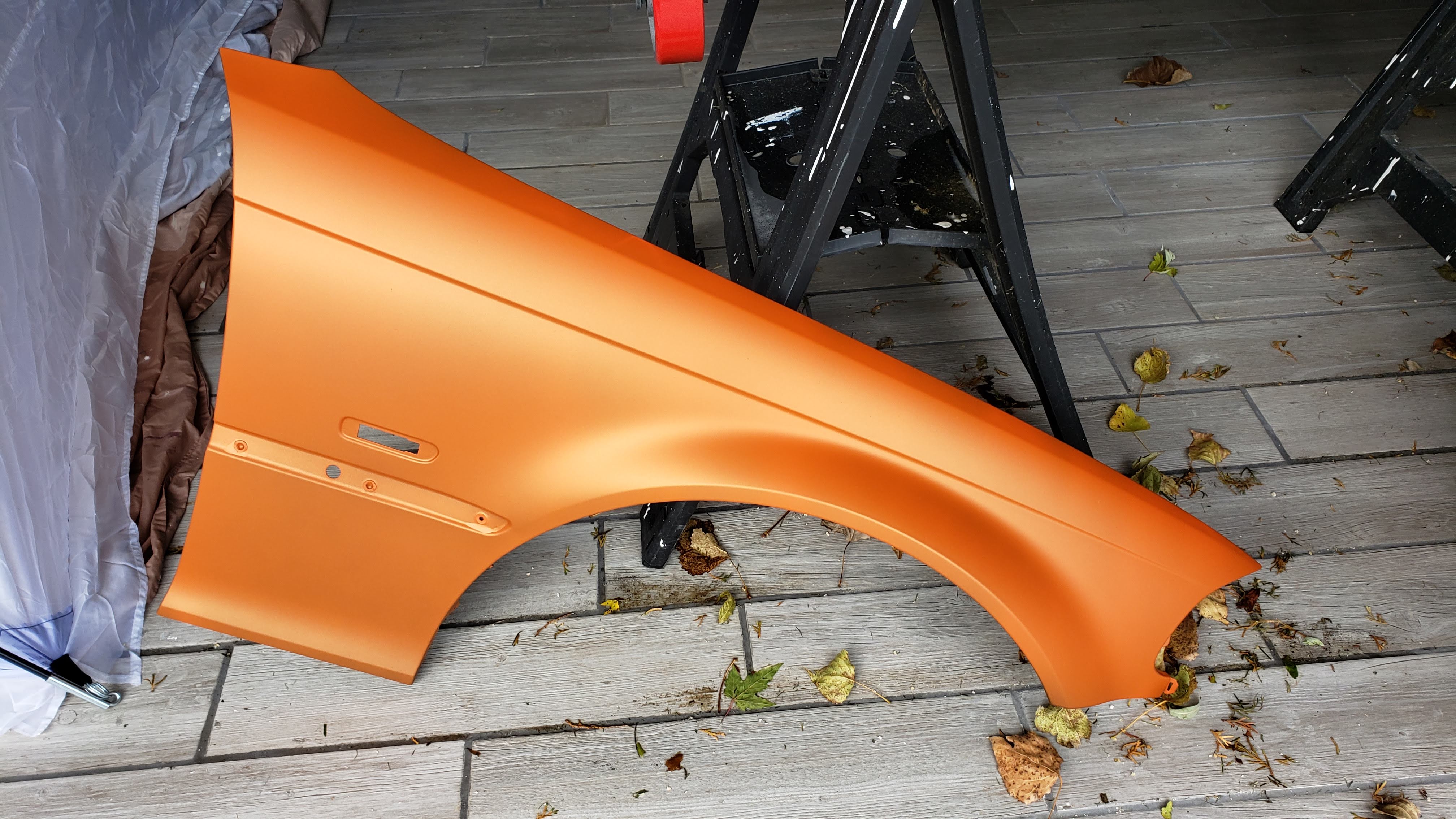

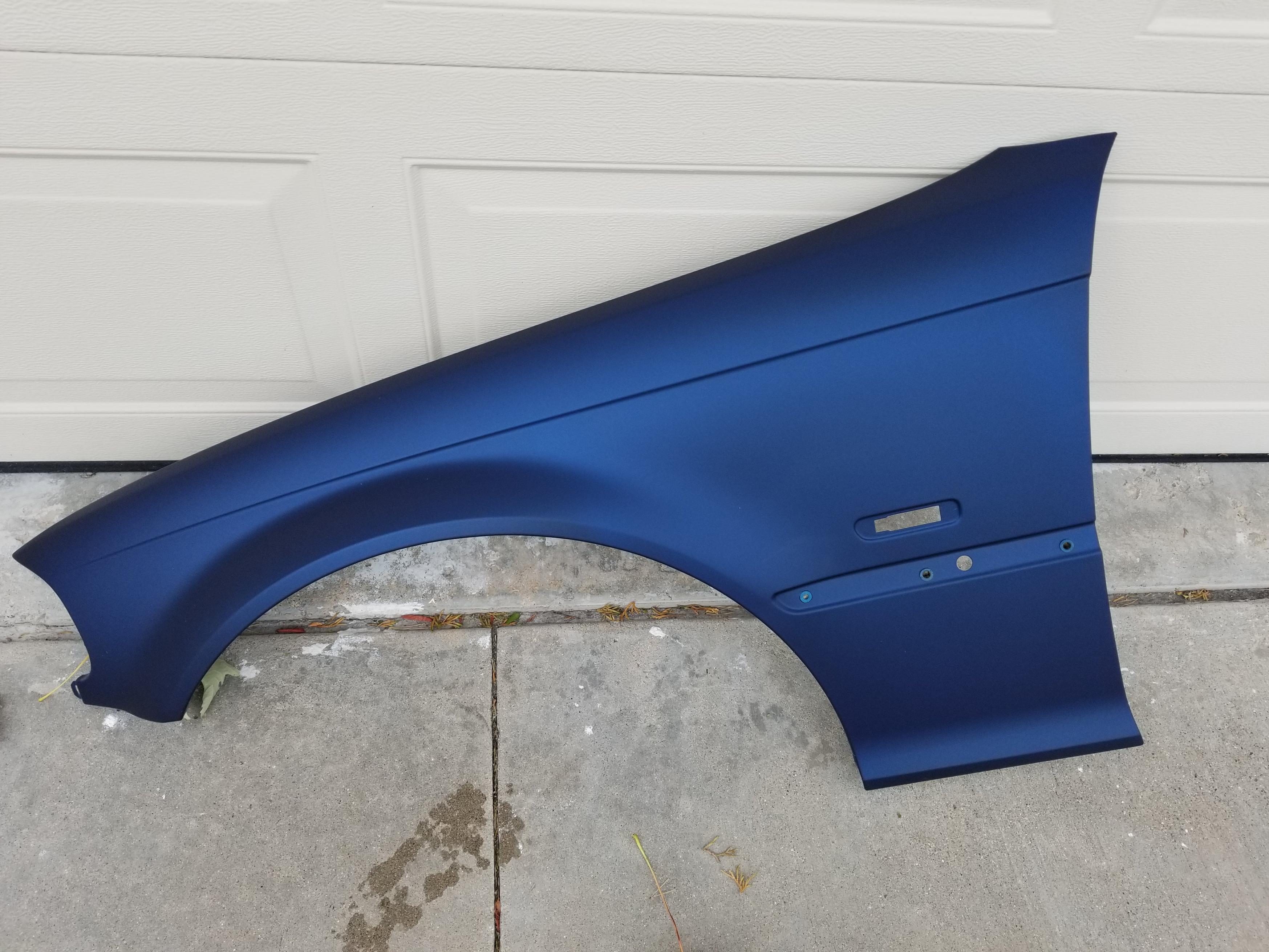

I had even considered Plastidip. We were building a BMW 330 track car and I experimented with it on a fender. Looks awesome sprayed out of a gun.
I had never painted a thing in my life. Bought a $100 air sprayer, a $50 spray tent and did this is 10 minutes. I did the blue first, waited a few days, peeled it off and did the orange.

Can't open the picture in the first post though, is it the room layout?

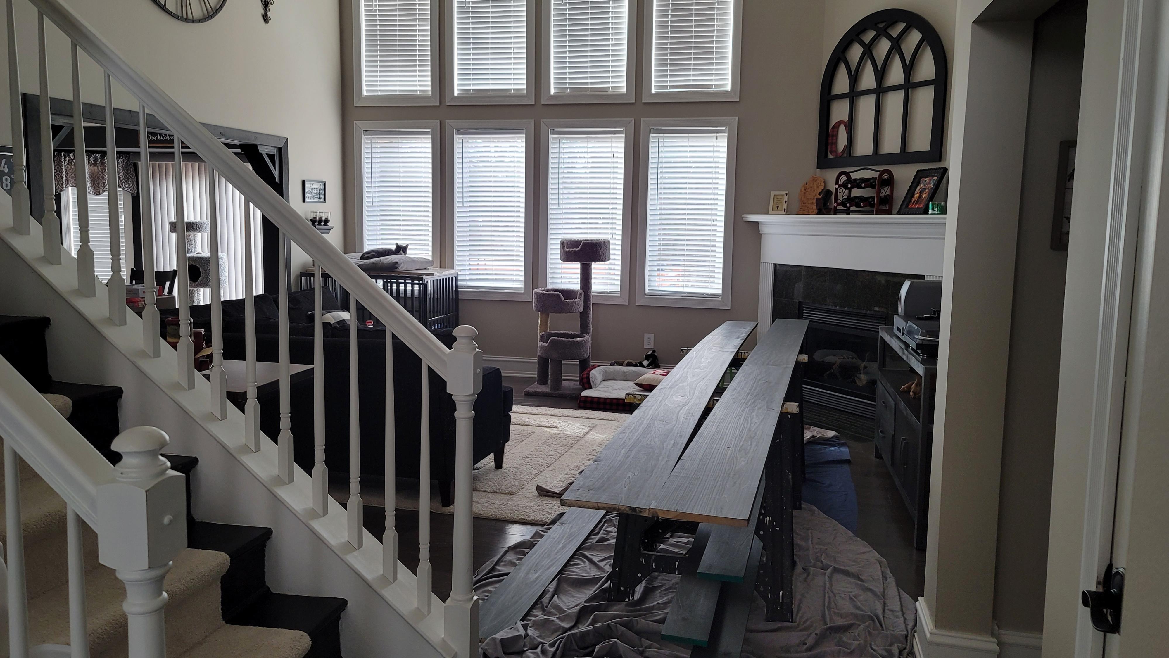

Here it is and also from a different angle. All the wood on the floor and saw horses are for tomorrow project. That entire wall with the windows is getting re-trimmed out and new window treatments.
Assuming the room was empty could they be made to work. I've had them where they are because we are in the kitchen often, putting it along the windows would mean we are perpendicular to the speakers.
The Plastidip thing is amazing. Your sprays look perfect. There is a whole subculture of Plastidip.
Thank you. I was shocked how easy it was, now granted those were big surfaces and the key is being able to spray around edges without getting overspray and drips but I could not believe how well it came out.
