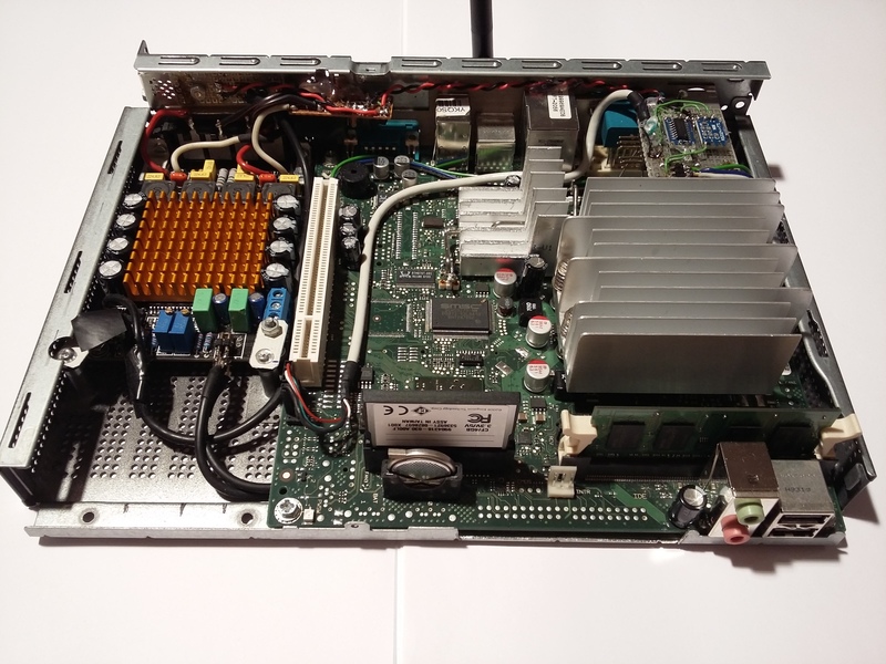

Corporations use them extensively and when they get replaced at the end of their warranty, the used/refurbished sellers get flooded with that particular model, driving the price low. They are built to last (including properly-designed power adapters), often nice-looking, decently equipped (USB3, gigabit ethernet). Some have options for multiple SSDs which can be handy for inexpensive raid1 https://www.diyaudio.com/forums/digital-source/377502-external-ssd-music-storage-6.html#post6808144
The older models are too underpowered for running graphical Windows (CPU and drive space), but for headless linux they have plenty of power and space (1GB RAM, 4GB SSD is enough).
Some 5 years ago I built a simple streamer/CD player/amp with FS Futro S450/550 (20EUR from ebay.de at that time including the power brick) Home * pavhofman/plabs-player Wiki * GitHub, it has been running basically every day since then in my parents' kitchen (close to the stove, a bit demanding environment) and never had a single failure.

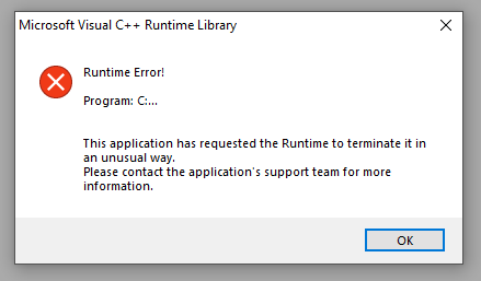

OT question - just got hit!
Fired up the AP and the Apwin 3.3 software and got an error message from the runtime library it seems, see attached.
What I did:
Ran Apwin in demo mode, no AP hardware powered up, no USB connected: same message.
Repaired the latest C++ runtime's I found in the Settings|Apps: same message.
Uninstalled Apwin, restarted the PC, installed Apwin: same message.
Apwin runs fine on my other PCs, and it ran fine on this one until just now. What the heck?
Any ideas?

Windows update recently? What version of C++ run time is required?
May need an update to apwin?
I don't know which version of the runtime is needed. And there is no update to Apwin, for at least 5 years ;-)
It is intriguing that this just happen out of the blue, on this particular PC only.
Thinking about the error message, it doesn't appear it is the runtime, apparently the app (Apwin) requested to the runtime to terminate it, in an unusual manner. Hmmm.
When I launch the app, it says, can't find hardware, you want to run demo? Yes, then it brings up de screen, the analyzer panel, the generator panel, next should be the sweep panel but then it quits.
