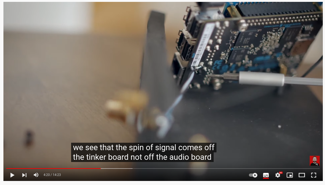

however in the case of the Primo device jitter over SPDIF coax is very high..... 2.733ns is extremely high so it is safe to say the coax SPDIF output is unusable.
Well, let's see what's going on. The Primo uses Asus Tinker Board S with Rockchip ARM RK3288. RK3288 integrates an SPDIF transmitter the output of which is available on the Tinker Board between its ethernet and USB ports
The Primo SPDIF cinch si soldered directly to this output Volumio's Primo is a two-headed streaming monster! - YouTube time 4:18:

Now what does the non-PLL fractional divider do. The Wikipedia explains nicely https://en.wikipedia.org/wiki/Frequency_divider#Fractional-n_dividers - flipping an integer divider between values n and n+1 to reach the required fractional number on statistical average, sorting the sequence randomly to minimize the effect. So basically the clock generator flips between two close frequencies to generate a mid frequency, on average. Looks very familiar - the very same technique which RPi uses for generation of its internal I2S clock, called MASH in its documentation. Periods of the two frequency ticks generated by the fractional divider in RPi differ by 1.3ns for 48kHz. Clearly the rockchip uses half the dividers (or half the frequency) so that the two frequency ticks differ by twice as much (2.7ns).
I analyzed the RPi fractional divider behavior in Avoiding RPi Master I2S Fractional Jitter . It has the very same cause and the very same "hack" could be applied to the Rockchip driver. Only the nearest integer-divider frequency would differ more from the required audio samplerates as the numerator divider in the rockchip is more coarse (larger difference between the n an n+1 frequencies) than that in RPi's Broadcom.
To conclude - the SPDIF jitter of the Volumio Prime (= Asus Tinker Board S = RK3288) is perfectly explainable and completely irrelevant to its USB performance.
