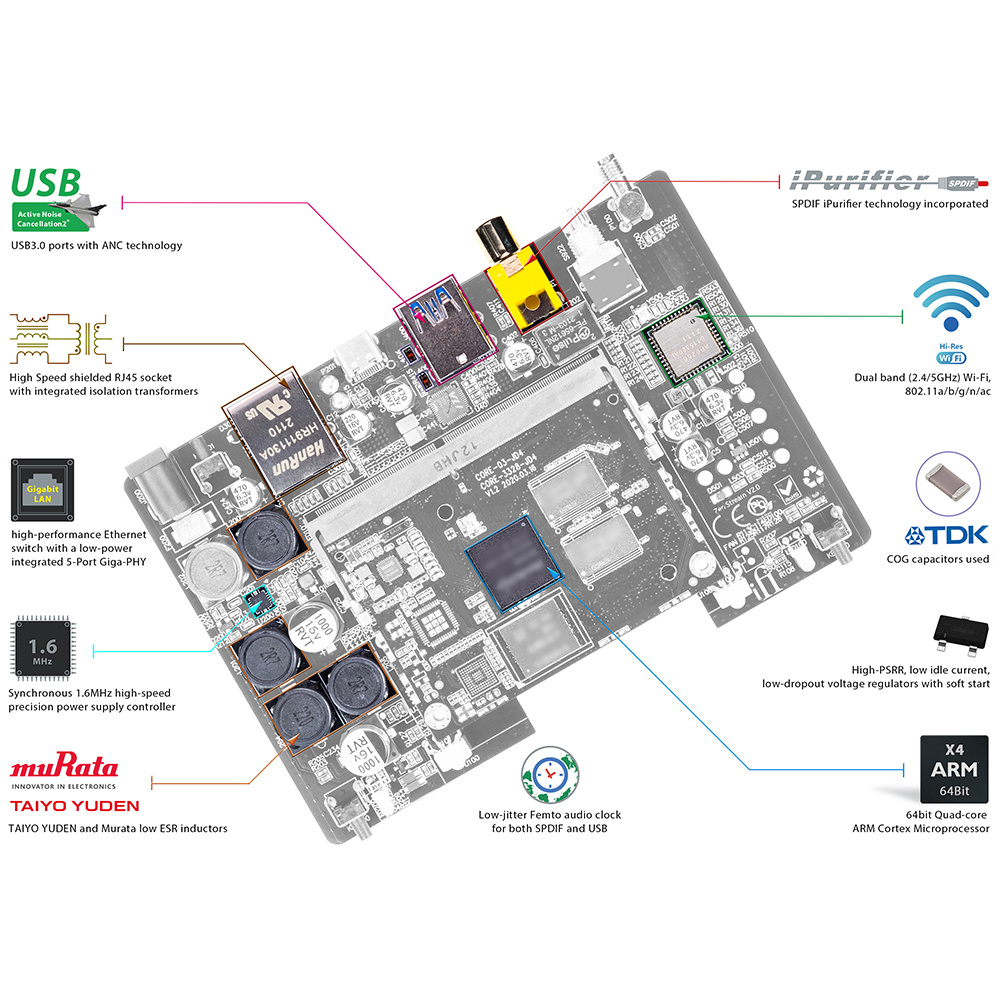

So I see Jan has to be massaged into a RPi 4 as the others are very good but maybe less good for audio 🙂 The flaky 3B is not the be preferred. This leaves the Zen Stream which he coincidentally already has. This device measures also very good. Maybe we can concentrate on the device as it seems a winner. Not of RPi of course as religion forbids to say that.
Maybe we can spend words on the device that was chosen and why it performs so good. I think I will try the Zen Stream out as well as I see its design is superior to many devices I know. It certainly has design aspects specifically for audio contrary to any RPi. This is because the iFi was solely designed to playback audio the best possible way for a competitive price. That fact may be hard to swallow but it gives it a head start of proportions when compared to a cheap universal device meant to spread computers and coding in third world countries.

But comparing the Zen streamer to plain RPi from the audio output POW is IMO not fair. The Zen streamer contains a Rockchip compute module plugged into a specialized audio board with external clock. We can compare it to RPi4 (or better the CM4 module) with some hat with dedicated clock onboard, mastering the RPi's I2S peripheral switched to slave. Not many hats feature that, IMO the pure reason is that the vendor would have to provide a custom linux driver which most hardware vendors are scared of. I believe it's a much better option than using the jittery internal clock and reclocking the I2S with some FIFOs later on, causing large latency and unavoidable over/underruns in the long run.
One key advantage of the rockchip SoCs compared to the RPi is their integrated configurable divider from external MCLK to I2S bitclock. That makes the proper audio clock circuit much simpler as only a crystal can be used, feeding the DAC MCLK and the MCLK input pin of the rockchip, no external configurable clock divider is needed (plus an optional simple two-crystal selector)
The major disadvantage of rockchip vs. RPi is the outdated android kernel, compared to the latest kernel available for RPi on their github, and the overall software support. Apparently that is the key aspect.
