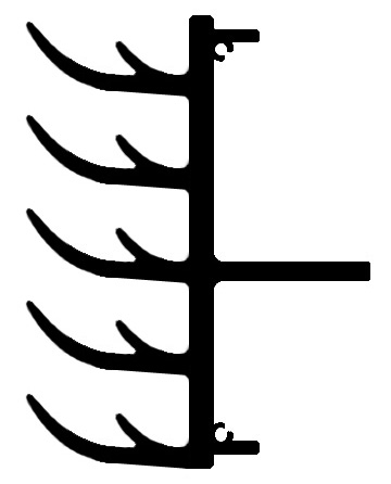

We should just explore from a hundreds or thousand ways permutation how to get rid of heat.
Leave that signature heat sink design to FW customers, or just buy the original?
This really is not enough to keep you busy?
Its about design with similar heat transfer and esthetics for greedy boyz, but recognizably different not to be usable by unauthorized cloners. Those do not look different enough to original FW fin pattern?

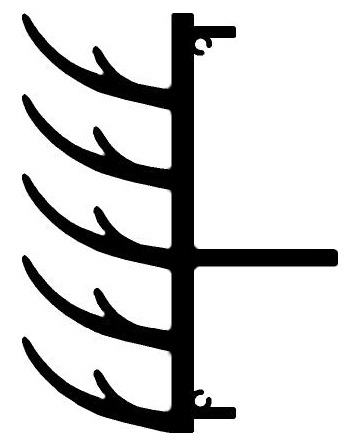

@indra, the middle one looks lovely.

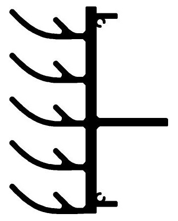

We could go even more distinct by replacing all the secondary fins with a 6th primary fin and going to a taller profile -- which might also allow the use of Modushop 4U fronts & backs.
Jeff, do you have bolt spacing for the 4U? But taller means more expensive and less interest for group buy.

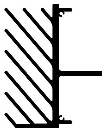

And another sketch.
And another sketch.
Yes, I think that the second is perfect but the problem is, more complicated = more hours of machining= more expensive. 😱
@indra1,
There's something to like about the simplicity of that last one.

@Gianluca, we're looking for the vertical spacing of the 4 holes for the cap screws that attach the backplate to the chassis so that we could possibly space the little 'C's in indra1's heatsink profile in post #48 to match them.
Thank you Gianluca, the drawing should help if it is drawn to scale.
This was just to show you the distance between the mounting holes and the edges of the panel, if you need the complete drawing so you can see all the dimensions you can find it attached to this post
Let me know if this sketch can help!
Nice.
Using my pdf software scaling tool, I think 125 mm C-C distance between the mounting holes is the other dimension that Jeff and Indra are looking for.
Nice.
Correct!
