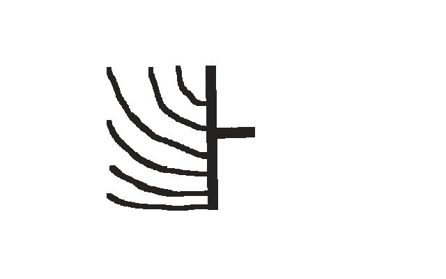

I'll admit I was thinking something really basic along the lines of the Conrad finned heatsinks, but then the penny dropped. The reason the FirstWatt fins are longitudinal is because it's the only way to have a longitudinal flange on the same extrusion. Something like the Conrad must be either cast or machined.
Given that, you could imagine something like flower petals. Forgive the bad graphic, but something along these lines:

A good start Jeff, I had been thinking along very similar line. Let's give the matter a bit more of serious thinking and effort overnight shall we? I'll also bring an idea or two to the table tomorrow.
