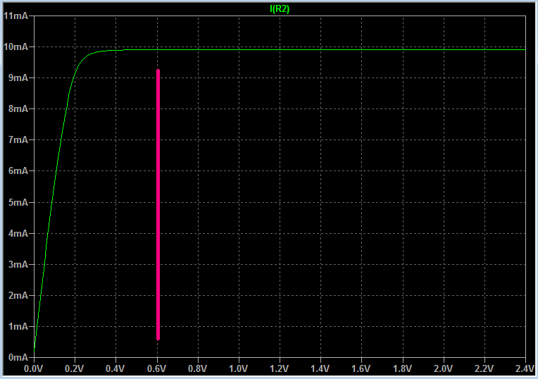

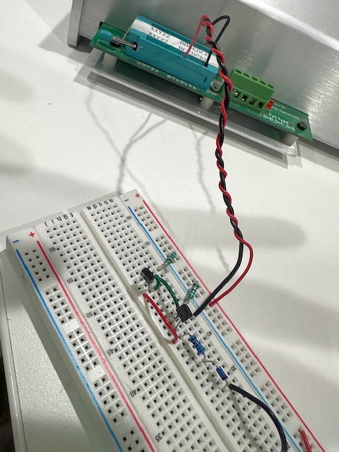

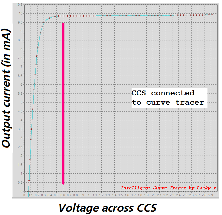

Show me a current source which works with 0,6 V ..
Here's one. It "works with 0,6 V" both in SPICE simulation, and in the real world on the lab bench.
_

Yes, I did not consider a mirror, only "classical" current sources.
In some very famous and popular threads about regulators here a JFET is used as current source
with less than a single Vbe drop, there is a source resistor in series. I am not convinced this works.
