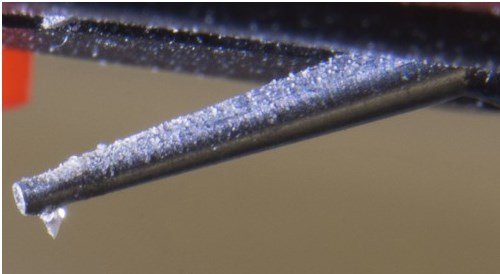

In many ways, this is true. However, since it is impossible to compensate for mechanical resonance electrically—due to the weak coupling of these components—the best solution would be to purchase a new cartridge with an ultra-light needle and a cantilever of conical structure. This way, the resonances will shift into the ultrasonic range, as they do in MC cartridges.
Reactions: hbtaudio
I'm with you that the lower the ETM the better, but are you sure about tapered cantilevers for MC carts?
My 50kHz cart has a solid boron 0.28mm cantilever tube, so not conical.
Hans
The conical geometry of the cantilever increases rigidity, minimizing parasitic mechanical resonance. Residual vibrations are further damped by a point-applied vibration isolator, typically visible as a dark spot on the cantilever itself.
However, beyond a certain threshold of rigidity, the benefits of the conical shape may diminish, as other structural factors become dominant.

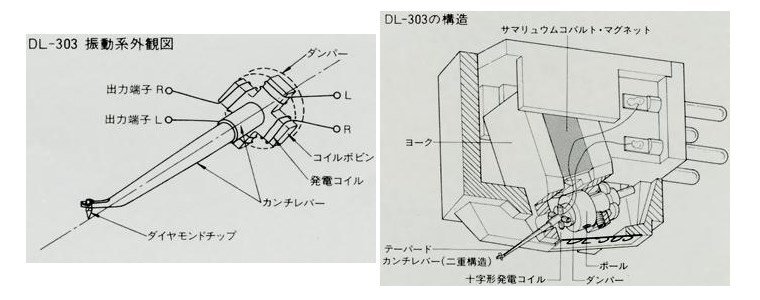

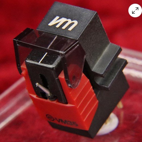

A picture from the past, from a more developed civilization—when marketing was less developed. 😊
TAPERED CANTILEVER VM STEREO CARTRIDGE
The decrease of equivalent mass of oscillating system in viewing from the stylus tip is directly related to the improvement of every distinctive feature. The smaller the equivalent mass is, the better. This is the widely prevailed theory for every kind of cartridges. In fact, it can be safely said that every effort of technicians has been concentrated on how to decrease the equivalent mass while keeping the balance of necessary mechanical strength and efficiency of electrical converter. This newly completed tapered cantilever is the final product of our vigorous efforts and continuous approach to this goal.
The special light-weight alloy pipe is surprisingly minutely finished with the micro sizes of 0.4mm in diameter at the tip, 0.9mm at the base, and 50 microns at the center part. Compared with the thick straight pipe of the original types AT-VM35 and AT-35X (with 0.6φ and 50 microns), the AT-VM35 achieves tremendous high efficiency, though its dynamic mass is relatively small. As shown in the measured graph at the end of this catalogue, the amazingly smooth frequency response is obtained only by using this cantilever.

When all MC’s would have tapered cantilevers and MM’s not, it could help to explain some anomalies in MM behaviour.
That would be clear confirmation, I agree.
MC cartridges differ somewhat in price and can afford to use lighter and stiffer cantilevers, which are not necessarily conical.
Not direct confirmation of anomalous behavior: the use of conical cantilevers in MM cartridges, being stiffer, extends the frequency response.
