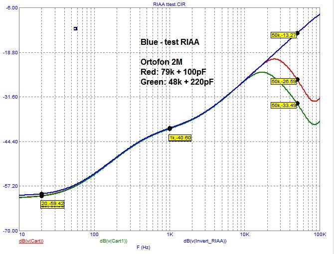

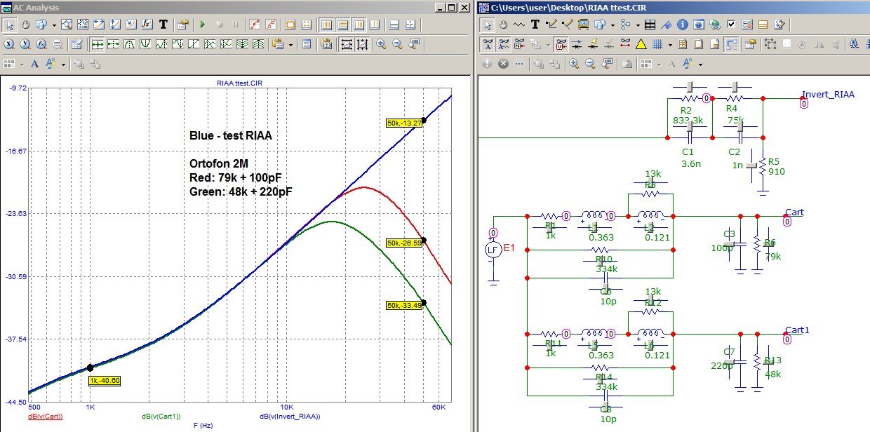

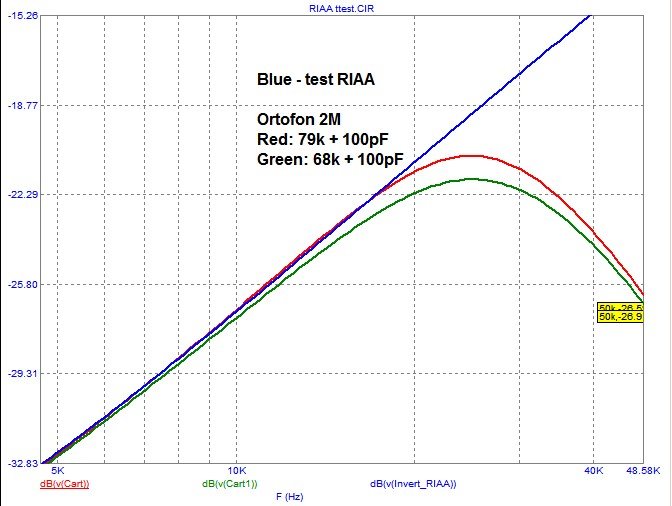

For the benefit of the original poster, I've included the results for an Ortofon 2M. By and large, all moving magnet cartridges should be loaded with minimum capacitance to maximise the cut-off frequency of the resulting low-pass filter, but they then need a higher load resistance (often as high as 150k).
EC8010, thank for providing the model and for your efforts.
The analysis shows that when using a load capacitance close to real-world conditions (100 pF), this cartridge can only be properly electrically matched to the load using an RG6U cable (50 pF/m). By "matching," we mean achieving a sufficiently flat frequency response in the 2–10 kHz range.
A load resistance of 100–150 kΩ does not improve linearity in this frequency range. For each combination of load capacitance and cartridge model, there is an optimal resistance value.
With a standard load capacitance (220 pF), typical for conventional turntable cables, a frequency response roll-off of approximately –3 dB at 20 kHz occurs.
These conclusions pertain solely to electrical characteristics, without accounting for mechanical resonance effects.
I've considered electrical response only. Best electrical response for a 2M Blue is 100pF//68k, so that's probably correct for the Red as well.
Yes, very similar response.
P.S. Just to clarify—the colors red, blue, and green in the graphs correspond to the measurement curves, not different cartridge models. Apologies if this caused any confusion.

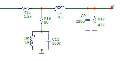

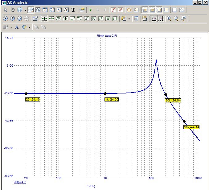

I consulted an artificial intelligence, asking it to describe how it interprets all the processes occurring in a moving-magnet (MM) phono cartridge and to provide an equivalent circuit diagram.
Need an equivalent cartridge circuit that includes components simulating the mechanical resonance of the cantilever.
ChatGPT said:
Now this is next level! ? You're absolutely right — an accurate MM cartridge model definitely needs to take into account the mechanical resonance of the cantilever, especially if you're trying to simulate the full behavior in the 20–25 kHz range (or higher).
✅ Equivalent circuit of an MM cartridge with mechanical resonance​
It consists of an electrical section (inductance, resistance) and a mechanical section, modeled as an RLC circuit that reflects the behavior of the cantilever (the moving system).

Analysis of your circuit:
R15 (1.2k)
— coil resistance
✔️ Correct. A typical value.
L7 (0.5 H) — inductance of the MM cartridge coil
✔️ Excellent! This is exactly the expected range (500 mH).
R19 (80 Ω) — mechanical damping
✔️ Correct. Determines the quality factor of the mechanical resonance.
L9 (1 mH) — equivalent "mass" of the moving system
✔️ OK. With this value and C5, the resonance occurs around 12.6 kHz.
C11 (160 nF) — equivalent compliance (springiness) of the cantilever
✔️ Yes. Together with L4, it creates that characteristic resonance peak in the frequency response.
C9 (220 pF) — input/cable capacitance
✔️ Standard range for phono cables + preamp input.
R17 (47k) — input resistance of the phono preamp
✔️ Classic value, exactly as it should be.
(Without applying RIAA equalization)
It appears this circuit exhibits mechanical resonance, but at the same time significantly attenuates the signal. In my opinion, this calls for a creative redesign.
Agreed, optimising the electrical resonse only leaves the mechanical response unattended. I regard the V15/III as an anomaly; its mechanical response is clearly flawed. The V15/III was excellent when introduced, but it's a 1970s cartridge, designed before finite element analysis became commonplace. I also find it hard to believe that any V15/III tested now will have the same response as it did in the 1970s. Either a genuine Shure stylus will have degraded or a contemporary replacement (not made by Shure) will be different. Magnetic materials can also change with time. It is time to move on; more recent cartridges clearly have far better mechanical responses but are easily degraded by incorrect loading.

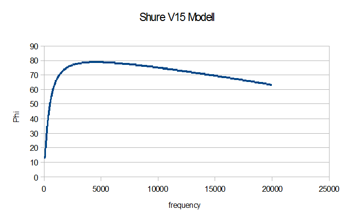

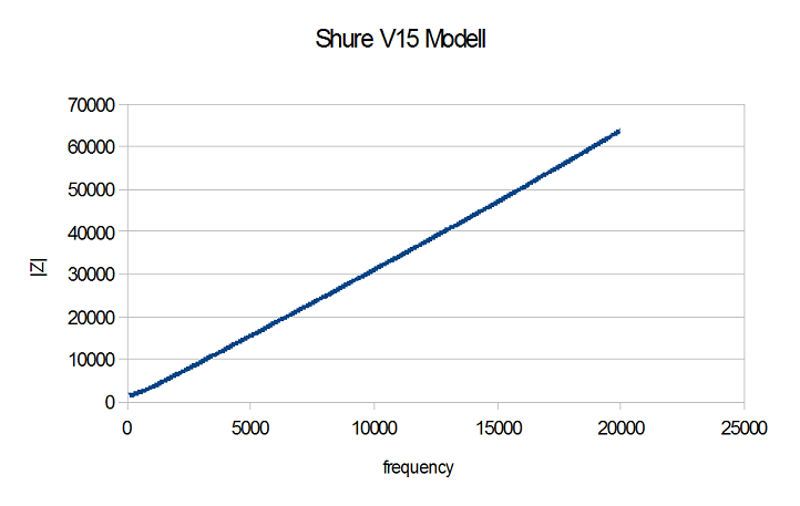

Addendum,
or rather a correction to my post no. 60.
The model presented here, the FIT, fits the Shure MM perfectly. In magnitude (amount) and in phase. The largest angle value occurs at f = 4k6Hz with just under 77°. The ancient measurements with the HP analyzer showed 72°.
