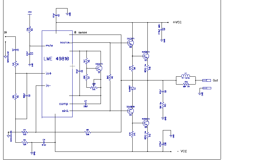

LME49810 - a new cousin for LM4702
sorry, my gif was too big. Hope this time will be ok
the resistor // to the diode seems to be the mirror of the driver's emitter one in most of schematics from the seventies.
I knew this topology before building these amps but i choosed to simplify and to modify later if necessary. The result was i got very clear trebles.
As my ear is satisfied and as i have no possibility to measure distortion, i left the amp unmodified till now.
But i keep on being interested on this Baxandall point.

I have incorporated the additional R and C in my revised PCB, and will test it in a few days.
What was mentionned is not a two pole compensation.
Here it seems that ( not for the 49810 ??) a serie resistor + capacitor should be added from comp pin to ground while leaving the mille cap in place.
The twin pole compensation is a feedback compensation method replacing the mille capacitor by twin T ( 2 cap and a resistor in the middle). The objective of such a network is to keep constant the loopgain in the midband then decrease it at 40 db/decade and then before the phase margin is too low, come back to 20db/decade to have enough phase margin at unity gain. This method buys you loop gain in the middband. It is of course a tricky method that must be tuned for a topology, a specific load and a layout.
What is mentioned in the thread is more a lag serie compensation added to the loop gain already compensated by the miller feedback compensation. The lag compensation technique decreases the loop transmission in the vicinity of unity gain while not modifying to much the phase margin, therefore it will improve the stability if there are problems with some parasitic poles in the vicinity of the unit loopgain frequency.

Qoute:" What was mentionned is not a two pole compensation.
Here it seems that ( not for the 49810 ??) a serie resistor + capacitor should be added from comp pin to ground while leaving the mille cap in place"
But that is exactly what is described in AN-1850, page 13?
I agree that Two-pole compensation is the commonly used term for what you describe, but National uses the term Two-pole to describe the compensation scheme in the application note.
Or am I still completely in the mist?😕

What is shown on page 13 is Two-Pole or Twin pole compensation as I described (with Rc2 removed)
What is mentionned in Jackinnj post is another compensation combining Miller and an equivalent of lead/lag.
