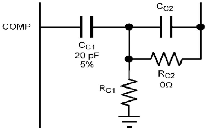

In this AN-1850 p 13, is there not a contradiction between the first sentence and the choice of the recommended value?
Citation: "...A value (of CC2) five times CC1 is a safe starting point. The resistance value is then selected based on the location of the desired pole. Recommended starting values are 12pF for CC2 and 5.1kΩ for RC1."

Audioman is talking about the LM4702/LME49811. The LME49810 and LME49830 do not NEED these additional caps. Only the compensation capacitor is needed. AN-1850 shows that additional optimization can be accomplished with a more complicated compensation network.
