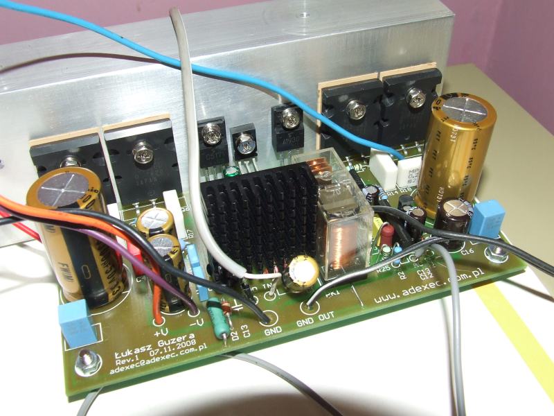

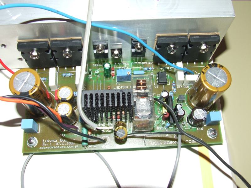

My second two channels Power Amplifier using LME4910 driver and MOTOROLA MJ15003/MJ15004 Power Transistors.
It is similar to my first one(On Post #579).
I add MKP-capacities on capacities for power transistors in second Power Amplifier.
The following are wave-test measured by oscilloscope.
I use 8R resistor as load
(The wave in the upper half of screen is load, and the another half of screen is function generator)

Why the square wave of 20kHz and 40kHz on load is better than function generator?
I think the cable between Power Amplifier Singnal Input and oscilloscope is older.
