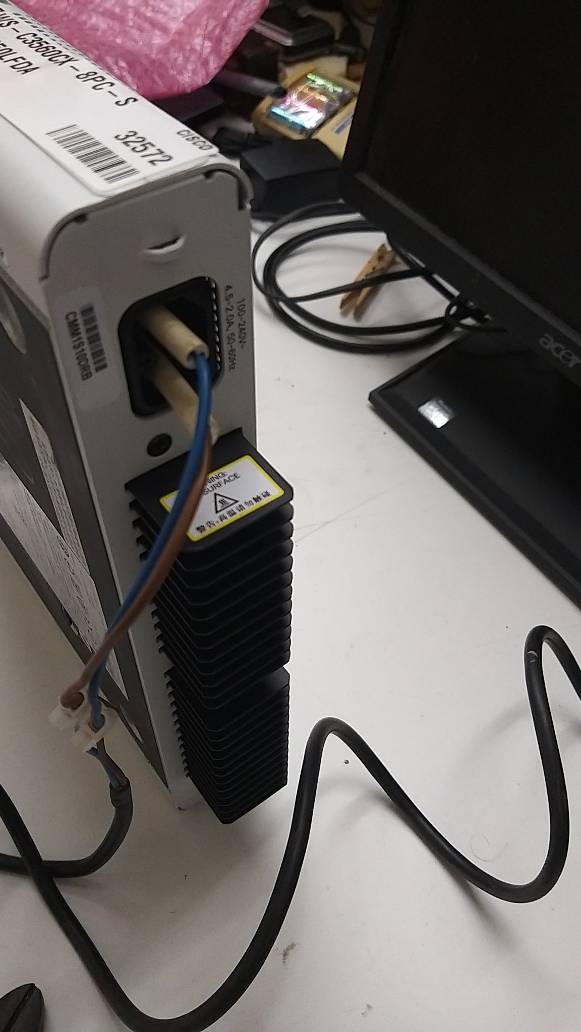

And then one day I picked up this Cisco switch. And my C14 cord would not fit. No, Cisco decided to put a 20 Amp rated C16 socket into a 8-ports POE switch with a rating of 135 Watt consumed power. Yeah, you bet is was dearly needed for such a huge power consumption and current draw to put in a 20 Amp socket incompatible with C14 sockets. Sure I have some heavy power cords available used in HP and Compaq servers rated at 2x800W consumption. But THOSE had ordinary C14 connectors of course.
Eventually I picked up the Cisco power cable to make the final installation. But no way I am going to carry a third variant in my stock C16-EU and C16-USA. Therefor sometimes I have to revert to a totally universal socket connection.
