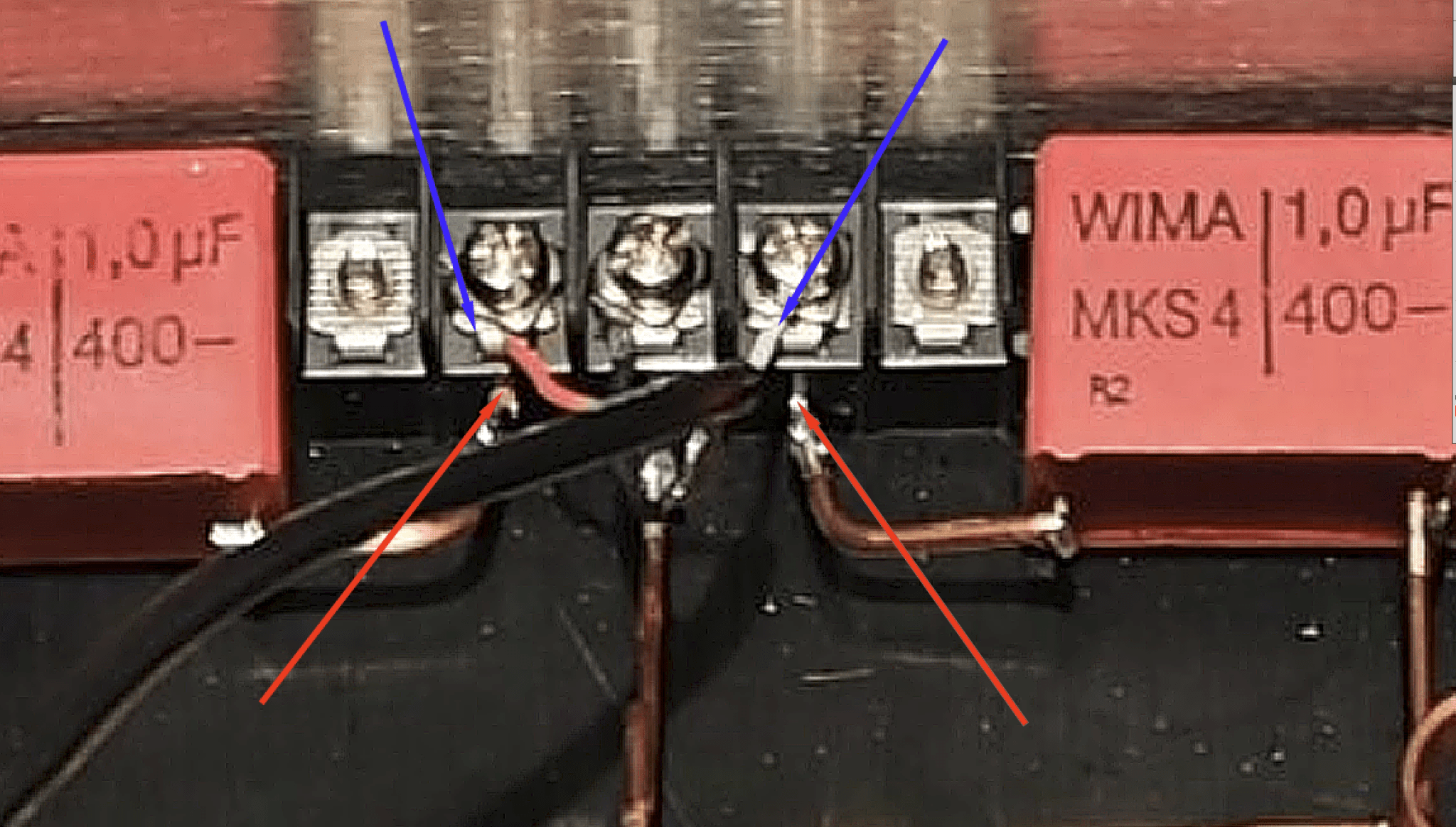

Yes and the potentiometers resistance being the reference to GND for both channels. You modified the inputs to 2 floating antennas and then the uPC1237 came into action. You then bridged the protection relays contacts as a remedy. We know.
Measure the relays contacts if you have the opportunity. Connecting an oscilloscope won’t hurt.

It plays wonderfully without the relay and tbh purists prefer the signal not going through hardened relay tips. Many amps do not even have a speaker protection relay.
