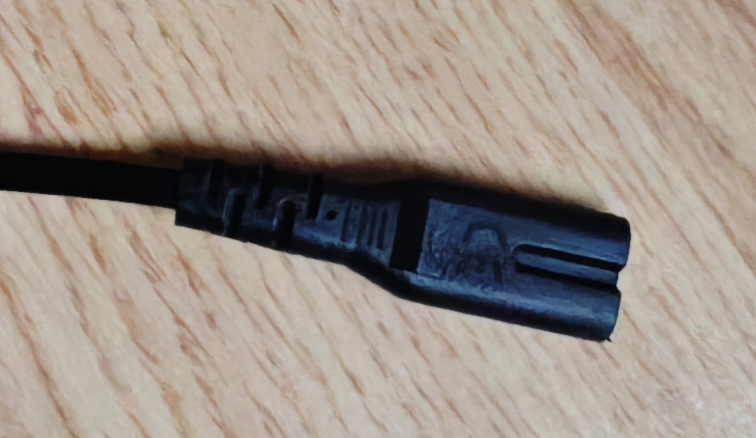

Do you know this Plug?
It's used by many SMSL all metal devices and many more manufacturers.
What do you think how effektiv the FI (Fehlerstrom Schutzschalter) will function without a PE-Leiter?
Reactions: Joseph K
That is not a plug with PE. Your device does have an IEC inlet with PE (also connected) and inadequate internal PE connections. So that is comparing oranges and apples (class I/class II) together with wrong reasoning.

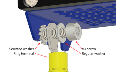

Furthermore my words are totally non important, we have regulations for that. Any electrical (safety) technician can confirm correct PE wiring color and thickness, what washers, bolts and nuts to use and how to have correct grounding. Anodizing, paint, screwed connections, all can be too high ohmic so simple methods have been developed to make it right.
Of course class II devices don’t have and don’t need PE and chances that L will touch chassis are next to nil by design but I can again have the wrong take on that of course 🙂

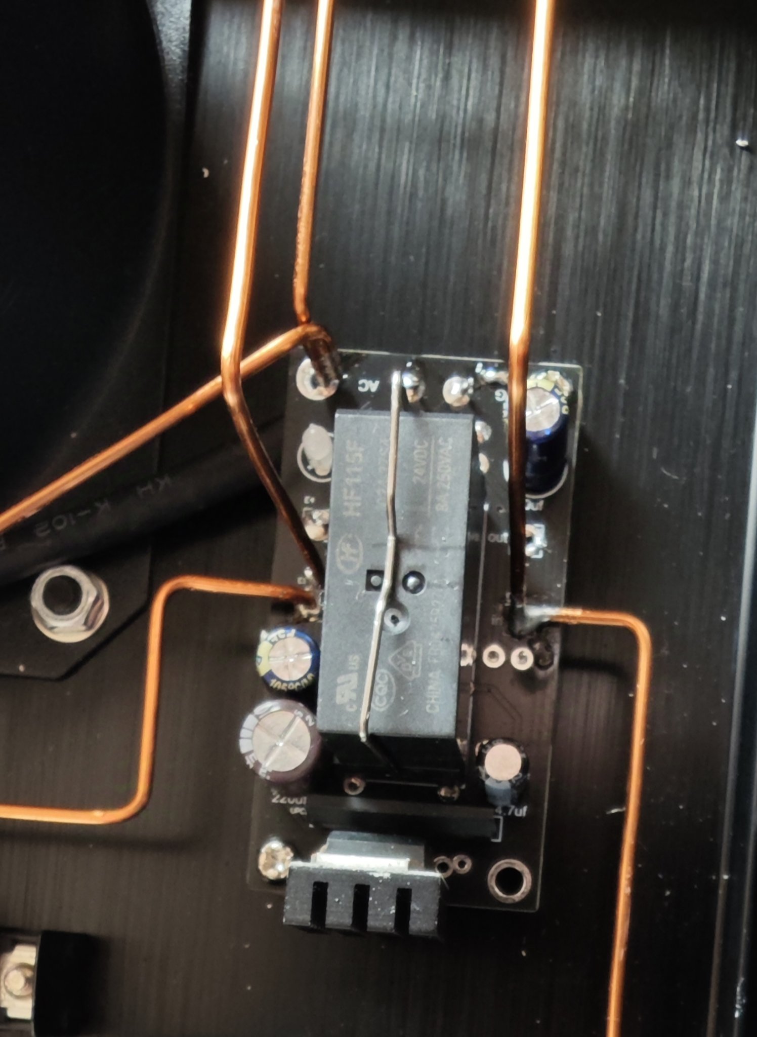

Coming back to the original problem.
The protection relay circuit only works as a delayed speaker turn on as far as I can see.
There is only AC from the transformer and the output wires from the LM4780 going to it. No other pin of the chip is is connected to the relay circuit. Since the amp plays cleanly when I bridge the relay the chip can not be in any fault mode.
Unless there is some logic circuitry underneath the relay board that senses problems on the output of the lm4780 I can see no reason that the change or omission of the pot should cause the relay to switch off.
I can only think of a coincidence between the faulty relay and my doings.
