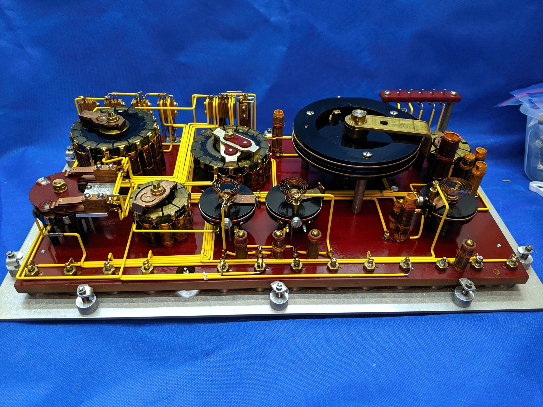

Perhaps it would have been instructive to say up front that you bought it this way and the "point-to-point" wiring is not your own work, not "your fault". I confess that I too assumed that any such creation w/o a printed circuit board had to be DIY. The internet is full of videos of terrible hacks where they wire components together in a similar manner, unsuitable for anything but a quick bench experiment, without any of the features that make a circuit useful long term. Would you approve a 480V 3-phase installation with exposed bare wires hanging out on the floor? It's hard to believe that anything without a PCB is offered for public sale.

My first words:Perhaps it would have been instructive to say up front that you bought it this way and the "point-to-point" wiring is not your own work, not "your fault". I confess that I too assumed that any such creation w/o a printed circuit board had to be DIY. The internet is full of videos of terrible hacks where they wire components together in a similar manner, unsuitable for anything but a quick bench experiment, without any of the features that make a circuit useful long term. Would you approve a 480V 3-phase installation with exposed bare wires hanging out on the floor? It's hard to believe that anything without a PCB is offered for public sale.
