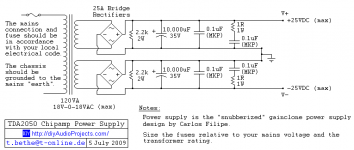

I built it using the TDA2050 snubberized power supply:

It won't be the caps or their values. An amp like this should be silent even with 1000uF let alone 10,000uF reservoir caps.
The unbalanced rails are a puzzle but nothing to do with the hum in the sense of them being different.
Check the two secondaries really are separate i.e. it really is a four wire connection and not three with a shared centre tap.
Check the AC voltage (use a DVM) across each winding. They should both be the same.
It is possible that the amp has a DC offset and that it is drawing current from predominantly one rail which would pull the voltage down a little on that side... worth checking.
If you take a spur from the centre point of the two reservoir caps and use the end of that spur alone as a clean ground then the amp should not hum. Couple up just one channel to begin with and make sure that is silent. You can return the speaker negative point to the reservoir caps but nothing else. All sensitive ground points are to be referred to the clean ground.

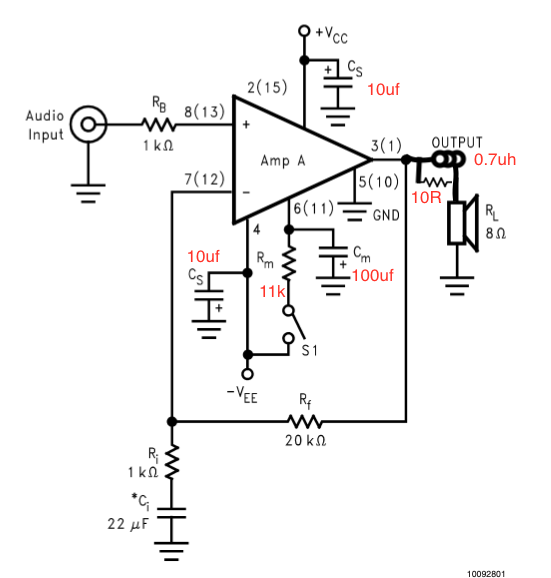

Here is the schematic of the build. It's using a KMTech board from eBay.
The +ve and -ve capacitors are shared between channels, as is the 100uf. The 22uf caps are electrolytic.

Inputs shorted to ground is perfect...
Now those voltages look pretty good at face value... and there doesn't seem to be any 18 volt DC offset here because pins 1 and 3 (the output) are at near zero. So something has changed.
With everything just as it is now just double check that there is indeed no DC on the speaker terminals of the amp.
One thing puzzles me (and I've never used or researched the LM4766) is that the input on pins 8 and 13 are shown 'floating' and without any ground referencing resistor. Normally with any opamp or audio output chip there would be a resistor to ground.
If the speaker terminals do indeed have no DC in this condition then switch off and couple up the speakers again and retest. Leave the inputs shorted of course. And always use the bulb tester.
If that is OK then I think we have to add a resistor of 20k or 22k from the input to ground. Now with the short removed retest again.
Also I see there is no Zobel network present but we can look at that later.

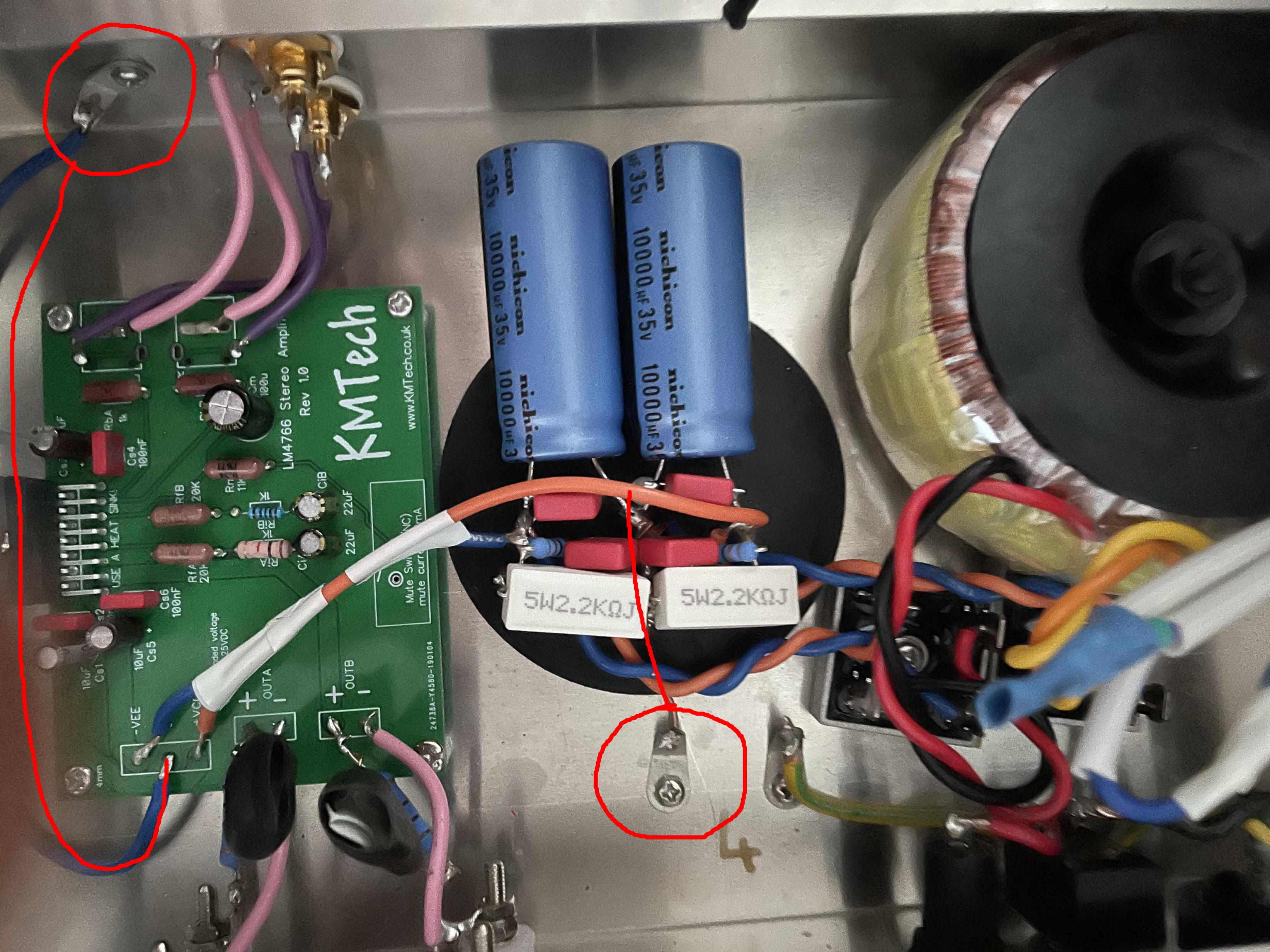

I actually already swapped it to one ground rather than two - I copied the grounding scheme from the valve guitar amp world which uses one for preamp next to input, one for power amp next to caps.
As soon as I started reading around for troubleshooting I realised that was a mistake!

OK. So, I soldered the 20k resistors between pins 8 (in) and 5 (gnd), and pins 13 (in) and 10 (gnd) on the underside of the board.
Powered up, amp was totally silent, tested for DC, no issues. Checked the voltages on all the pins again, everything was still good.
I don't have an RCA cable, so I had to crocodile clip on to a guitar lead coming out of my computer. I have the parts to make the cable, but wanted to get it working first.
Totally silent. Then realised I hadn't put a jumper across the mute button.
It now works!
It's totally silent except for when I clip on to the hot of the lead. If I hold the earth and the hot crocodile clip cables tight next to each other, it quietens down considerably, which makes me think the issue is the cables... not anything in the amp?
I feel like if there was a ground loop issue to do with the power supply I would hear it whether connected to an input source or not... right? I think?
The only other issue is the channels sound slightly different. The speakers I'm using are just some junk ones I picked up in a charity shop though, so I'm trying to work out if it's the amp or if the speakers sound slightly different to each other.

While for a newbie any ground on the circuit or on the pcb is a good place to solder something on it, the truth is very far from that. Therefore, if you want to do something properly and learn something along the way, you have to read well and put it into practice exactly as the more experienced tell you. If Mooly and I tell you to solder the lower end of the ground reference resistor at the input of the amplifier to the signal ground, then please do exactly as said because there will be less problems later.
I understand your desire to have an amplifier that works "properly" as soon as possible, but there is no room for shortcuts here...make/buy a cheap but technically correct interconnection cable.
I expect the amp to be totally silent in only two cases for now: a) when nothing at the input is connected and b) when only one channel (left or right) is connected at the amplifier input. The moment you connect both channels (left and right) at the amplifier input, the same moment a ground loop will appear inside the amplifier that no longer will be silent...but we will solve this later with the already mentioned 10R resistors.
