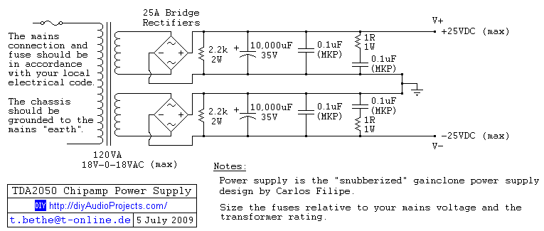

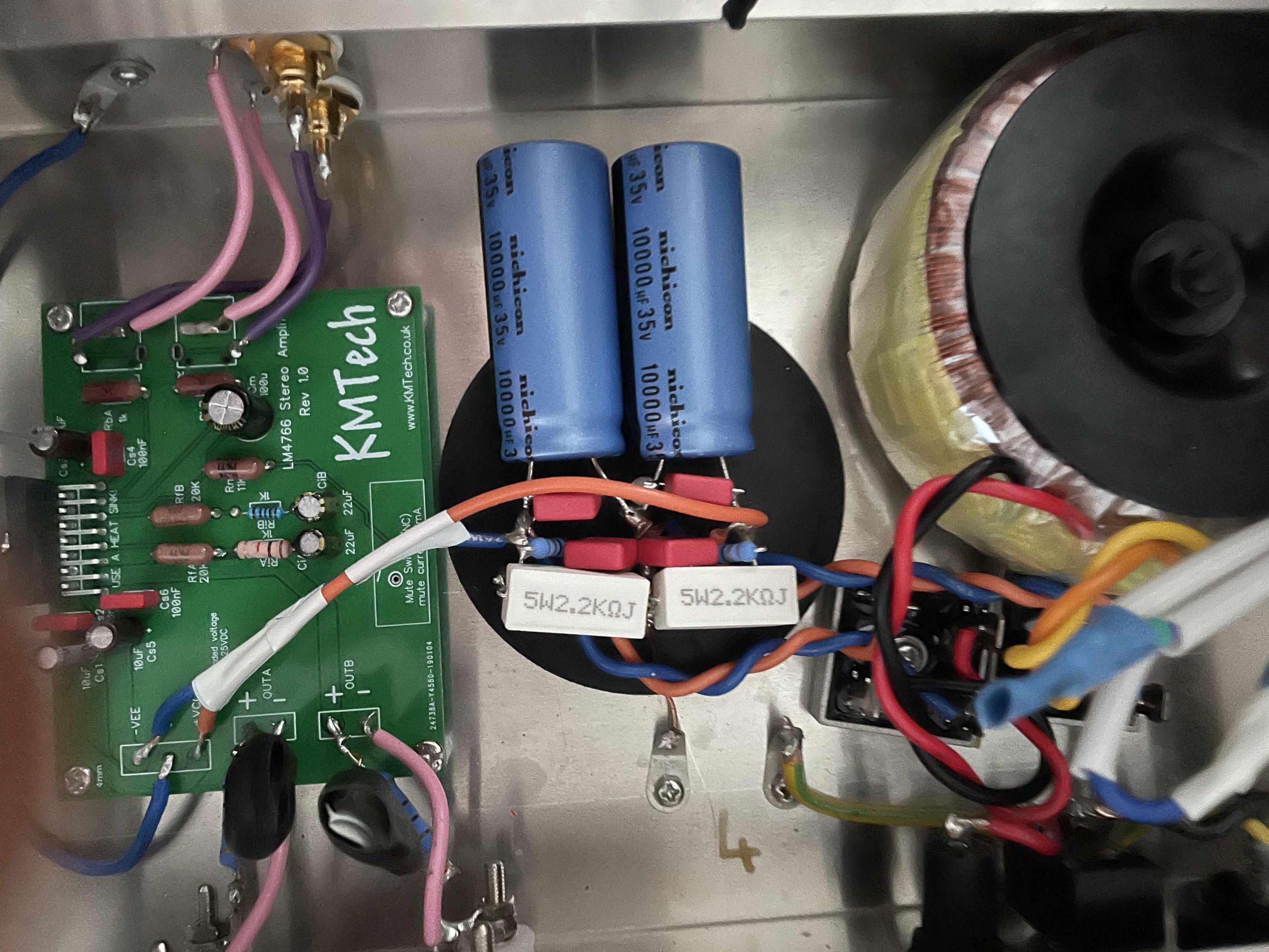

I was wondering if I could get some help with an issue I'm having with a chipamp build.
I built it using the TDA2050 snubberized power supply: View attachment 952344
It hums, a lot. It has a very loud 100hz hum (I'm in the UK).

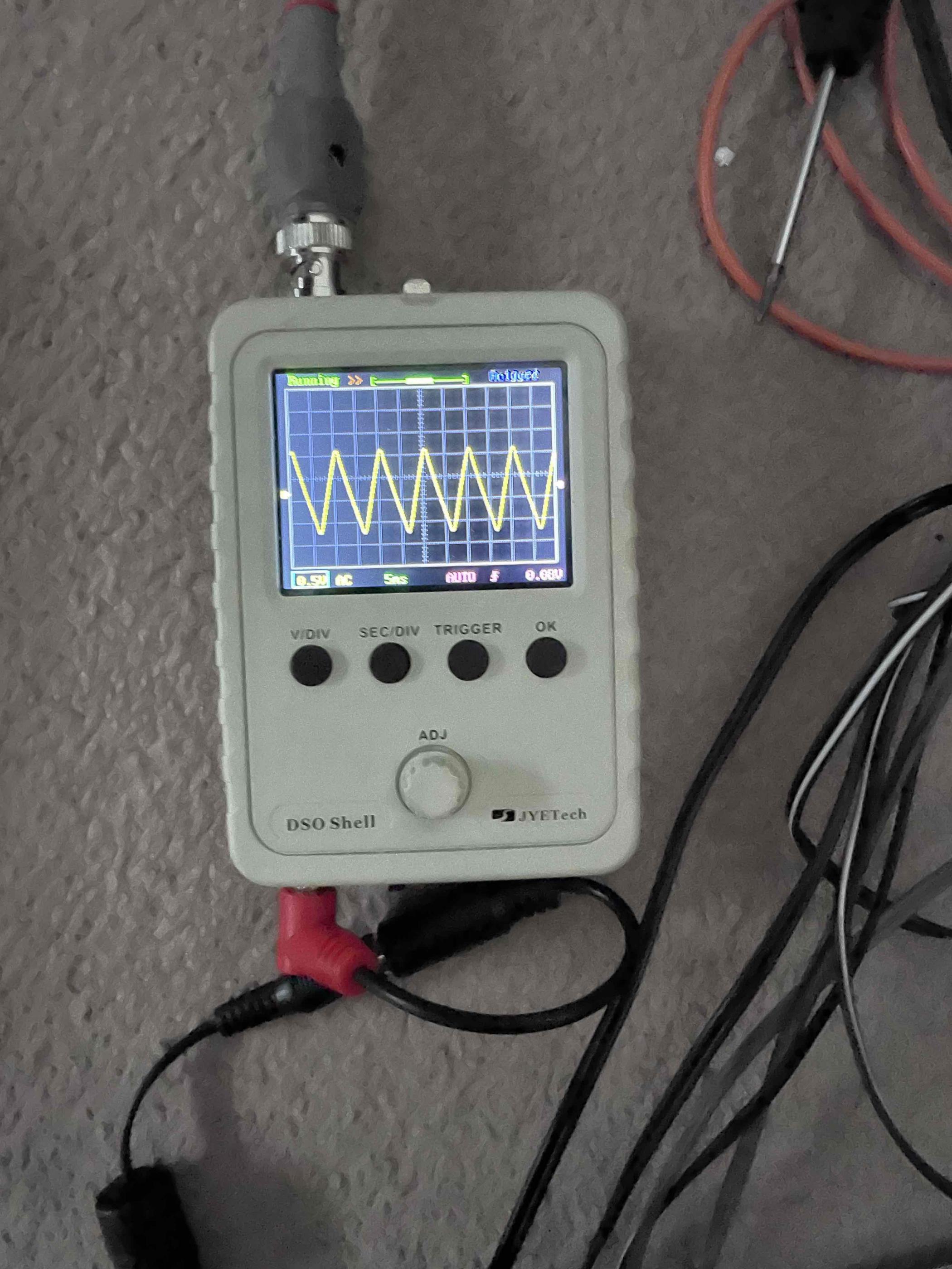

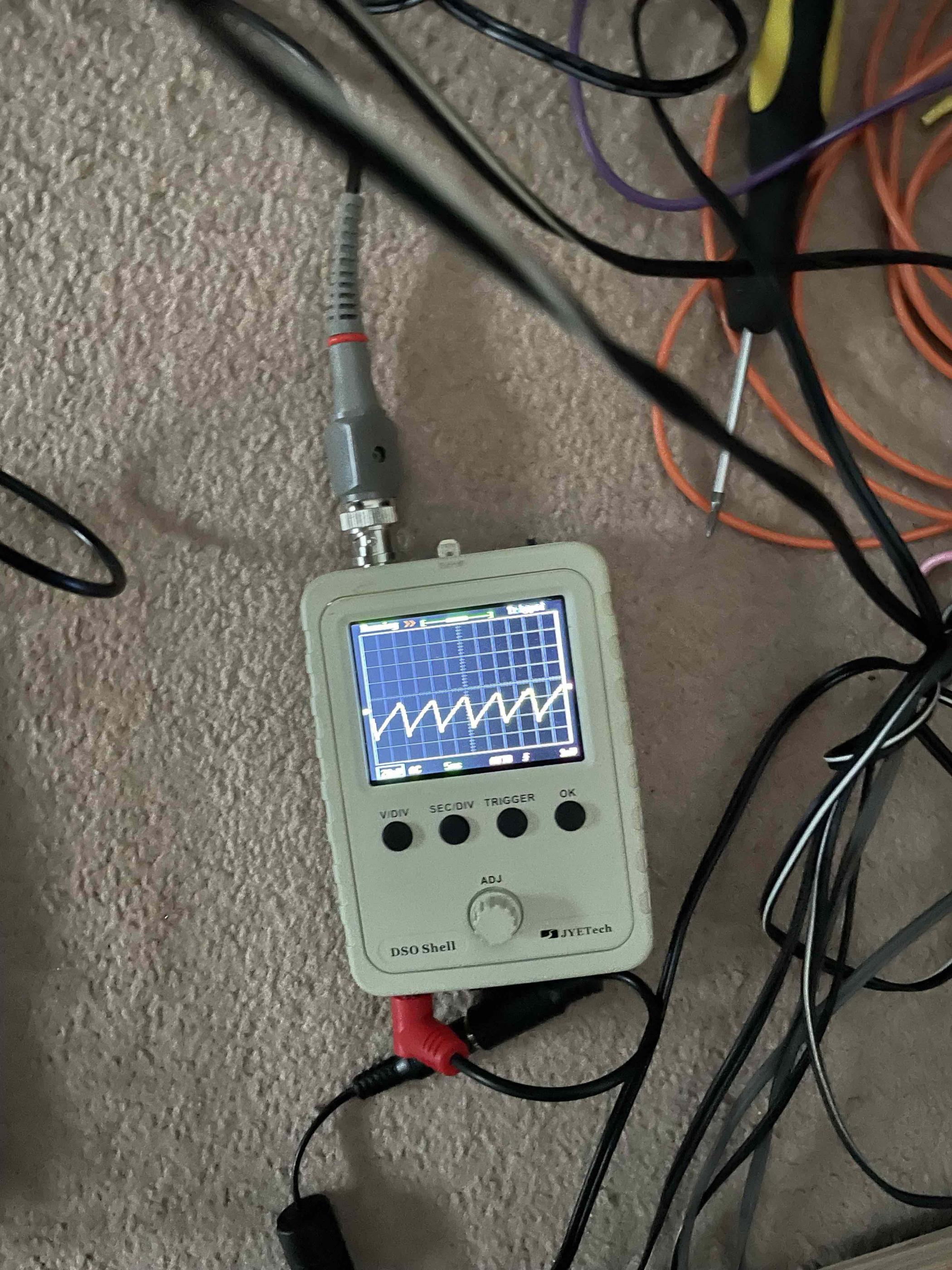

I have played around with a cheap digital scope I have, and it seems like the issue is with the +ve supply, which has 1.5v of a sawtooth 100hz signal in it. It's also slightly lower in voltage output (~20v compared to -25v -ve, which is what I expected).
This signal is exactly mirrored on the output too.
On the -ve, there is the same signal, but only around 25-30mv:
Interestingly (maybe), the mirrored signal on the output disappears if I touch the audio input. If I touch the audio in on the right channel, the right sawtooth output signal disappears at the right speaker terminal, but it remains on the left. If I touch the left in, it disappears on the left out but not the right.
I've tried moving the wires around, changing ground positions, moving the transformer, no change. The rectifier tests OK.
The only thing I haven't done is change the 10,000uf cap on the +ve rail, which I'm going to do today. It was a brand new Nichicon cap, does it seem possible that this is the problem and it's just not getting smoothed?

You have done the primary homework yourself. Few inputs though:
using a dual bridge rectifier has its advantages but without a PCB I don't recommend it at all.
If I were in your position I would disconnect the PSU from the power amp, remove one leg of the bleeder resistor, use only one bridge.
First check the output voltage at each rail with a 18+18 volt trafo it should be [(18*1.414)-1.4) ballpark 24 volts might have messed up the formula a bit but voltage should be around 24 on each rail, I would add an error margin of 10% on each rail so it should be between 21.6 to 24 volts on each rail.
Second check the ripple on each rail if the capacitors are not out of order and one of the rectifiers in the bridge is not shorted and ground is properly connected the ripple should be minimal.
Oscillation at 100Hz means lack of ground. You need to check that.
With a good psu power amp do not oscillate except they are connected to a poor Pre, turntable without ground.
Hum or oscillation at 100 hz is most of the time due to psu, and the mostly likely responsible candidate is Ground connection or capacitors. In your case I'll put my money on "improper ground"

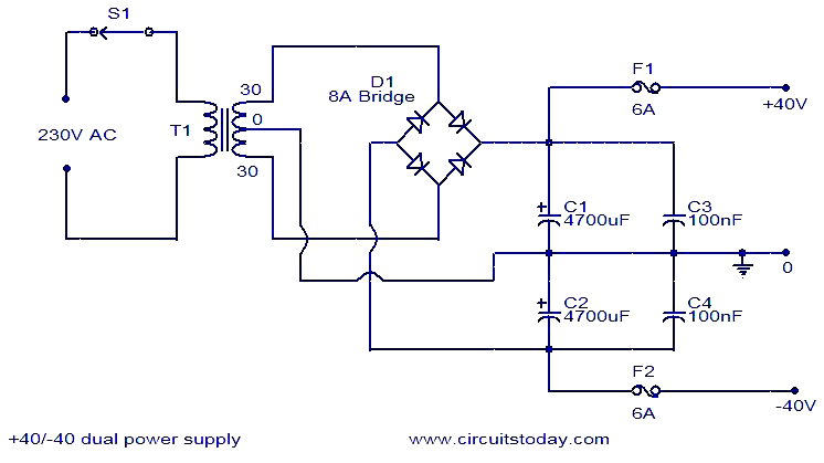

you can use single bridge rectifier as mentioned in this schematic. Remove the bleeder resistor for now. 1R/1watt.
First use a single bridge, if the hum persists (which I doubt) try and change the source audio signal and cable. e.g if you are using a tape/reel to reel/phono(pre out) as the source change it to may be PC audio out.

I realised that the schematic I uploaded was missing a couple of 100nf capacitors that, Mooly, you'd recommended on the Complete novice alert! thread. The schematic that came with the paperwork for the PCB didn't include them, so I missed them off when I was quickly adding the values and the inductor to the schematic from the documentation.
I have ordered the parts for the Zobel, however, and some additional 10R resistors.
In the meantime, I moved the input RCA grounds from the PCB to the capacitors' ground, and that has eliminated all but a tiny hum. There's now a very faint 'on' sound now, that registers as around 50mv of general 'noise' at the speaker terminals on the scope. It'd still be nice to get rid of that, though, but I can listen to music without issue and it sounds excellent.

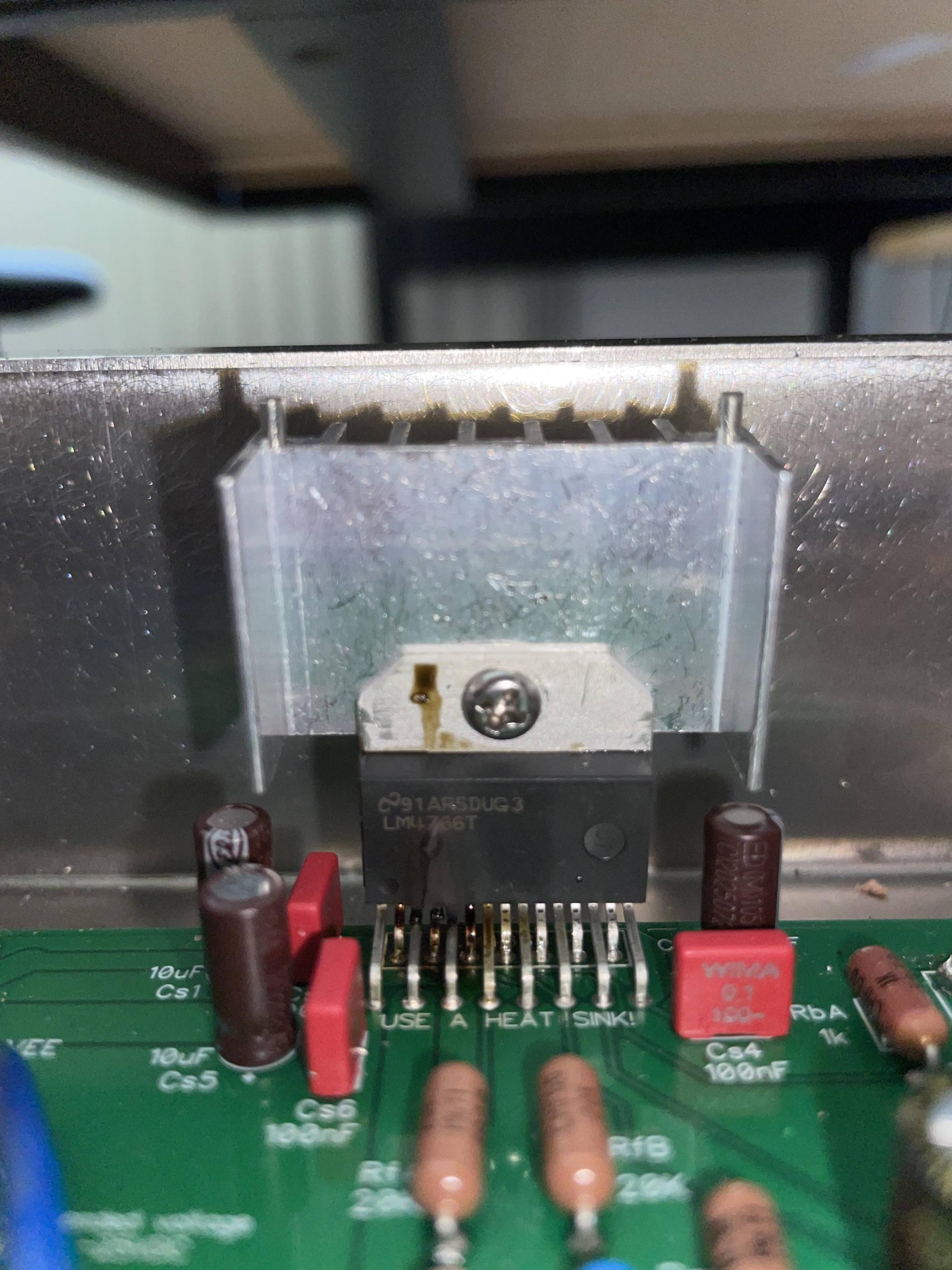

I'm not sure what happened. Like I said, it was working fine. Small hum but nothing terrible. Hooked it up to the pre-amp, everything was still fine.
Turned it on and off a bunch of times while I was trying to decide whether I preferred it with or without the pre-amp. No issues.
Then, turned it on, heard a pop/crackle immediately, saw smoke, turned it off. Chip's burned. It looks like it was between pins 3, 4, and 5. I wonder if there was a short or something, or if it was connected to turning my pre-amp on at the same time.

I guess you haven't read the LM4766 datasheet which is the first thing to do when dealing with IC...if you did you would certainly have some questions regarding the equations on page 15 "DETERMINING THE CORRECT HEAT SINK".
It's truly amazing how much LM4766 has ever withstand so much overheating with such a tiny heatsink...and rest assured it has done absolutely everything to protect itself from abuse, but the poor thing couldn't take it anymore.
One more thing...the metal tab on the LM4766 is at Vee potential, so -25VDC is also there on the heatsink in your case, because you are not using an insulator between the LM4766 and the heatsink. Therefore, if the contact between the heatsink and the housing accidentally occurs, you have a short circuit.
Edit... one more note, never connect/disconnect interconnects while the amplifier is on, even though the LM4766 has some protection for that as well.
The circuit you posted (post #7) was always a very simplistic implementation pretty much lifted from the data sheet.
Apart from the error of the missing resistor at the input, the input should really be AC coupled and also include an RF filter. An output inductor should be included to aid stability into slightly capacitive loads and of course the Zobel network.

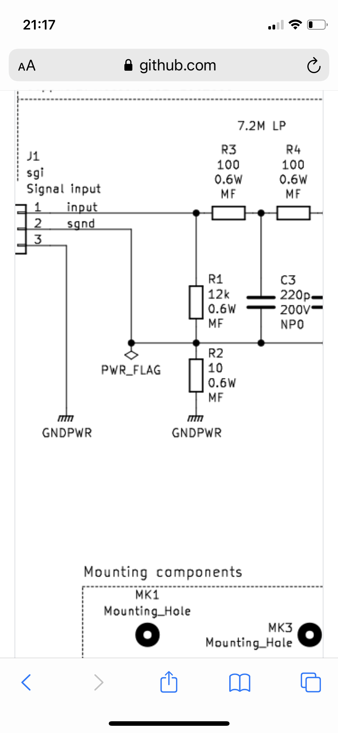

For an rf filter, would that just be a small capacitor (120pf-ish?) across the input resistor to ground?
For the ac coupled input, would a 4.7uf capacitor in series with the source signal be sufficient?

When you add the Zobel network remember that it goes before the inductor, not after.
A 120pF (or 220pF) across the input resistor (the one from the chip to ground) should be OK but you then should add a series resistor in front of it all, say 2k2 or 4k7.
A 4.7uF coupling cap is OK. Fit the polarity to suit the small voltage present at the input pin which could be a few tens of millivolts negative.
Grounding is a massive topic and something that has to be considered from the outset. You can certainly try what you propose, many designs use that technique.
There’s already a 1k resistor in series with the input, would that be ok? Or did you mean in series with the rf cap to ground?
It will be ok, but the ground reference resistor in parallel with the rf filter capacitor must be on the right side of the input 1k resistor towards the input pin (8/13) to be effective.
Yes, but put a film type capacitor, not an electrolyte of any kind.

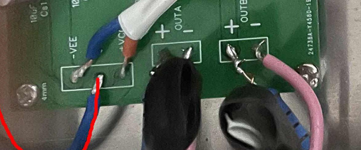

I just stumbled across and saw something which really should be fixed.
These wires got way too much insulation removed and can short out easily, the soldering does not that great either. They don't even need a broken solder point for that. In terms of safety and reliability this definitely needs to be adressed.
