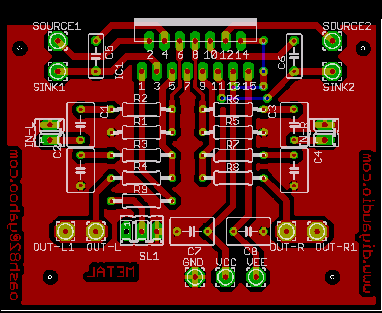

Hello All
I will post a new modified PCB design for LM4702, I will modify the PS bypassing a little bit, so all guys be satisfied, and feel good about the PCB design, no problem.
Also I will work on the other PCBs for the power transistors to which I pointed out yesterday, (2SB1564/2SD1449), (MJL4281/MJL4302-MJE15034/MJE15035), (MJE11031/MJE11032).

I am not sure what concerns you. Shorting just about output resistor beyond its rated power dissipation will kill it. Just don't short it. 🙂 Or you could build an output protection circuit.
Still there are plent of good parts to choose.
Russ White said:I am not sure what concerns you. Shorting just about output resistor beyond its rated power dissipation will kill it. Just don't short it. 🙂 Or you could build an output protection circuit.
Any audio diyer can easily short the output power transistors by mistake in deed, but I will try not to short them 😉
Do you have any short protection circuits on mind russ...
Yes, but I will not use for me first prototype.
You will have a hard time finding good devices that can take a full on short for long.
russ,
you might post some kind of schematic for the protection circuit later, I have the intention to add them to the power transistors PCBs.

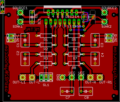

i wouldn't worry much about the built-in 0.22ohm resistors, what can be done is to add external resistors in series with the emiters, say another 0.22 then add more sap's in parallel to get a better SOA rating for the output stage! this is how i will do it when using the sap devices!
two of these chips in two input boards will make a really high powered amp, with a balanced input, ballanced outputs. i.e. with rails of +/-85volts, 600 watts is possible!
national has come a long way since the lm391 days! about 20 years, i'd say well worth the wait!

Russ White said:
Sorry to say so, but your first point is patently false, some LM3886 circuit can draw 15ma to 25ma at idle, yet good bypassing can make all the difference in the world, it is not just sound I am after either, it is also stability. Bypassing as optimally as possible is always the best choice, not that compromises don't sometimes have to be made.
As for you second point, any suitable power transistor you choose could be used. I don't make any assumptions on that.
I think you need to read me better, either that or i need to practis my english, as we think each other wrong, but trying to say, basically, the same thing.
bypassing as close as practical, not possible, and as good as practically possible. thats my view.
point two, the chip dosent need darlingtons after all?
i was under the impression that it did after reading the datasheet.
what will the effect of removing qmulti1 on the datasheet resoult in?
I was thinking this, with the resistors, were there to help counter thermal runaway?
If you use theramally compensated devices like SAP16 you do not need qmulti,, otherwise they should be included on the power device PCB.
Also you can easily make your own darlington pairs and use a wide range of devices.
My idea is to make the driver PCB as generic as possible by taking any output device dependancies off the driver board and moving them onto the power device board.
Cheers!

demogorgon,
If you have a set of requirements you would like to see in a PCB I would be glad to see if I can accomodate you.
I chose the SAP16 simply because it has a great reputation, and it removes something like 6 components from the schematic. 🙂
You could build this amp with 2 SAP16P 2 SAP16N and the LM4702 for around $30 + passive component costs which are quite variable.
That seems pretty darned reasonable to me. 😉

Russ, This dialog turned out better than i had thought, good thing you are a diplomatic man 😀
well, i'm trying to point this\these design\designs into a more intigrated solutions, thats based on logic and knowledge rather than the latest fashion on the forum 🙂
like mauro's 3886 amp. no BS, just a good design. no snake oil. no matter how cheap it comes 😉
i'l have to sit down with pen and paper and make a scetch of what i envision, but not tonight. tomorrow.
oh, btw, something that cost you in the states 30bucks will cost me about 60 here up north. if not more.
there's a reason the wages up here are about twise as high as yours.

This discussion has led me to one clear and concise conclusion....I really need to finish my new speakers!
Seriously, both of these designs look pretty good so far! Personally I would like to see individual output boards as it allows for more flexibility where heatsinking is concerned (lets face it that will be the biggest cost). It also allows for more flexibility in the chassis design and layout. This will also allow you the flexibility to experiment with different output transistors etc.
I look forward to seeing what happens with this design. Has anyone given some thought to a PSU for these????

Hello
demogorgon:
If I am not wrong, you need to see two transistors (MJE15034/5) on the LM4702 PCB in order to hardwire (MJL4281/MJL4302) directly, not forgetting the addition of the bias transistor....
I already said, I will make it versatle, and satisfying to all valuable members interseted in this project. I will try to do what is mentioned above. I will also try to keep it single sided....
In this one, I have made the small signal tracks shorter as much as possible, and moved the PS capacitors in order to allow using a connector for the PS. I added the mute resistor also which I completely forgot, now its on the PCB, along with another connector for +5 Volts 🙂
and still as beautifully symetric 🙂

Hello demogorgon
Glad to see that you like it demogorgon, I always try to do the best I can...
I will be waiting for your sketch 🙂
