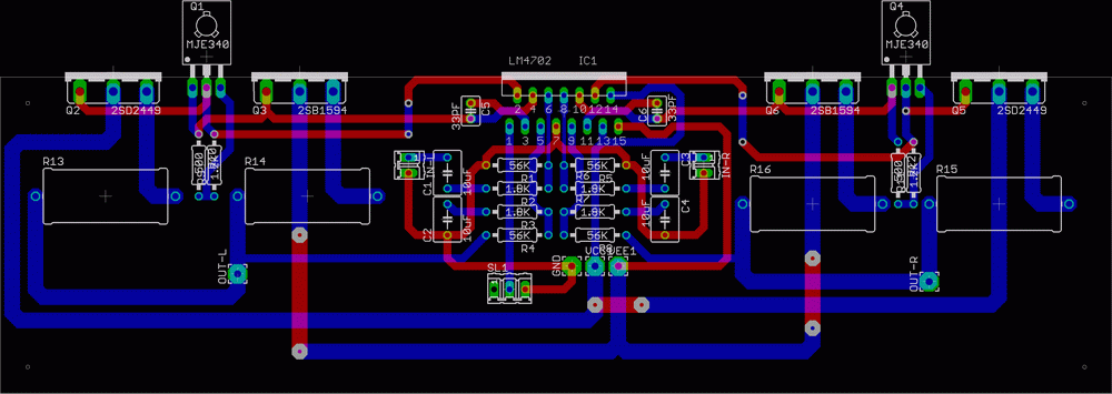

I am designing the whole thingy in deed, so the PCB will contain one LM4702, two driver transistors and four output power transistors, also the "diode" transistor...
I 've concluded that it will be a better idea to be able to change the driver transistors, that will yeild the flexibility of having as many output transistors as the designer wants. For now, I will only include four output power trnsistors.
I have finished designing the library of LM4702, I will also design a library for the output power transistors, I will have MJL series.
For now, here is the library for LM4702, guys who use Eagle and are interested in this project, shall see this library and make sure its absolutely mistake free...
I also might omit the driver transistors and use power darlington instead, I am still confused on which one to go with...

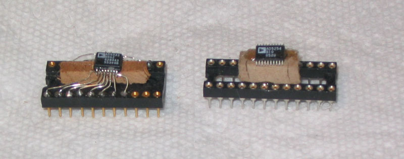

John:I use the following technique for soldering SMD chips to an IC socket.I glue a small piece of wood to the base of an IC socket,I then use a small dab of hot melt glue under the chip and then secure it on top.I then solder 30awg wires to the IC socket,I then carefully align the wires to the chip and use solder paste to solder.I have successfully done several dozen chips with this method and have not lost one yet!....

Hey, Bob, do you do all the wires at once, or one at a time?
How do you melt the solder paste?

I don't think its a matter of 4 to 5 transistors in deed, this IC, has current mirrors for the constant current consumption, which lowers the THD very much, also a thermal shut down feature, which also need more transistors, you start counting.....
The most important thing is the neat looking of the amplifier, and the high performance at the same time, that can be obtained using this IC...
The PCB I posted is just a prototype, I am still working on it, and will make it single sided if I can, I will also place LM4702 on a separate PCB, and the output stage on another PCB, the output stage PCB will have many verions, I mean there will be one PCB for LM4702, and two or three PCBs for the output satge from which you can select one that satisfies your transistors....according to the power transistors used....TO-3, TO3P...Darlington.....with drivers......etc...

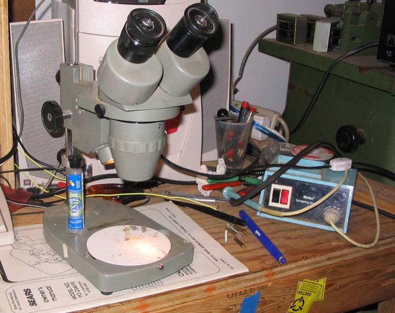

Hello Wes-Ninja:I first solder all of the wires into the IC socket,I use ic sockets with gold or silver plated round holes.I solder one wire at a time,a small amount of solder paste is applied to each pin followed by soldering with the 30 watt soldering iron.I do hold the wire to the pin with a fine point tweezer.
I can complete a 16 pin device in less than 1/2 hour.

Bob -- thanks!
I'll have to add that one to my book of tricks.
Once upon a time, I had to do something similar, but on a larger scale -- replace a wide DIP with a skinny DIP. I was replacing a defective SRAM chip and couldn't find a wide DIP of the right type.
I ground down an old EPROM, removed the die, then bent the pins straight on the skinny DIP and finished the connections to the EPROMs pins with 22awg solid copper wire. I also had to add an extra decoupling capacitor.
