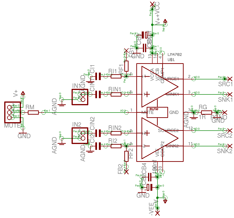

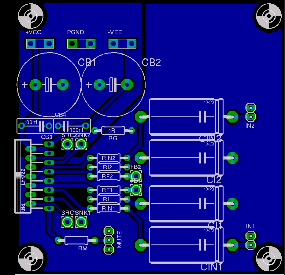

Here is what some guys asked for, the PCB for LM4702 alone, with no output transistors, I think its fully optimized now and single sided, I spent the rest of yesterday night on it, hope you like it guys...
Notice that the comp caps are not on the board yet, that is because I was initially going to put them right on the pins. I changed my mind and I will add them soon. So look for an updated PCB soon.

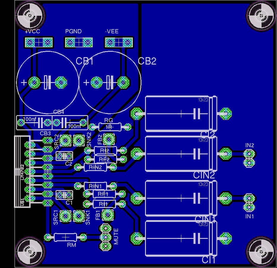

Cin and Ci
Metal, what where you planning on using for Ci and Cin, it will be tough to find caps in the size you have on your PCB.
Also you should bypass the PS pin on the chip as close to the chip as possible.

well, Russ, the "close-as-possible" bypassing for a chip that draws a constant current of 25ma is not needed. the overbypassing does not help the sound, it helps the sound you hear. and thats the sugarpill effect you know.
making the board for a specific pair of transistors serverly limits it usefullness, if this is something you make for yourself, only sharing the work for fun, then ok, but for most people, like me, your pcb is useless.
-Marius
Sorry to say so, but your first point is patently false, some LM3886 circuit can draw 15ma to 25ma at idle, yet good bypassing can make all the difference in the world, it is not just sound I am after either, it is also stability. Bypassing as optimally as possible is always the best choice, not that compromises don't sometimes have to be made.
As for you second point, any suitable power transistor you choose could be used. I don't make any assumptions on that.
