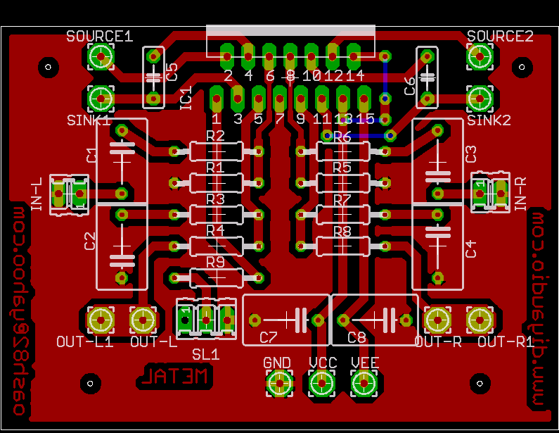

Hmmm, well that PCB might be much use to anyone else beside you then unless someone knows where to get 10uf film caps that are that small.... I certainly don't, but I wish I did.
Hello russ,
If you say that other members can't get it, I will change the footprint to a larger one, so all guys can have the capacitors they want on the PCB...No problem 🙂

russ,
Ok, no problem, I will change that soon...

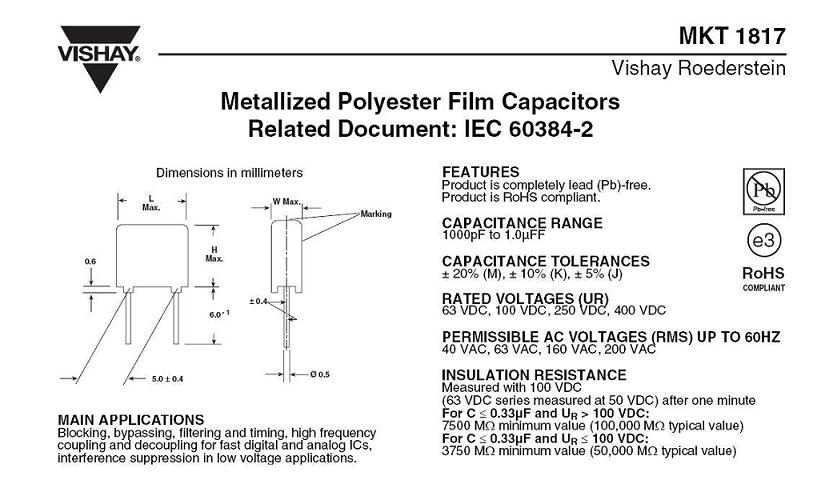

Vishay caries Polyester film caps in 10uF for around $1 CDN...with the 5mm lead pitch. They are available from Newark.
MKT1817510065
Not sure if these would work or not...but they would fit!
MKT1817510065

Hmmm the datasheet from Vishay says only up to 1uf for the MKT1817.
What I mean is that for audio higher voltage caps tend to measure better than lower voltage caps of the same type, but I am not sure its important, its not so important to me in any case.
Ensuring it is the proper voltage rating for the circuit is more important to me.
Here is the datasheet

Hello russ,
That seems to be a demo board to experiment with LM4702, I don't think we should stick to it that much, what do you think..
The last PCB design I have already uploaded with the new capacitors spacings, is just fine, you can easily manage to get capacitors for the input as high as 65Volt, and 150Volt for PS capacitors.
