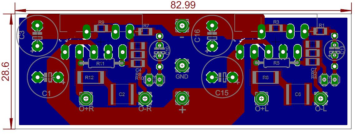

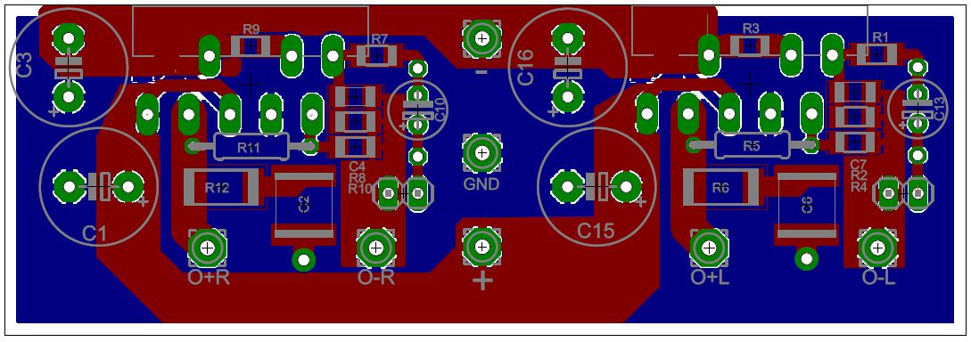

...and this is how current PCB looks like. I was thinking, maybe I could extend PCB a few mm behind LM3886 so the Vss line could be moved further away from the left input circuitry. In order for Lm's to reach heatsink, copper or aluminum bar could be used to fill in the gap.

That is certainly true. That's one of the tradeoffs you make when putting two amps on one board. You could estimate the impedance between the left channel and the supply caps to quantify the error voltage that develops because of this kind of layout. I strongly suspect, however, that the ripple voltage that develops in the power supply due to the current draw of the left channel will introduce a much larger error voltage than that developed across the VCC/VEE pours. As long as this amp is built as a stereo amp, that will be the case.
Not really... It just moves the issue closer to the supply.
That's the drawback of using an amp with low PSRR... (hint 🙂)
It's difficult to get a good layout. Period... The layout in Post #54 is actually close to optimal for the left channel. The right channel is slightly sub-optimal due to the location of the supply connector. However, I think we're counting Gnat Farts here.

Just noticed the separated +ve and -ve feeds around the left amp that will see interference from rail pulses due to current demands of the right amplifier.
Two completely separate triplet feeds to left and right channels will solve much of this.
It is really difficult to get a good one chip layout, I gave up on two chips.

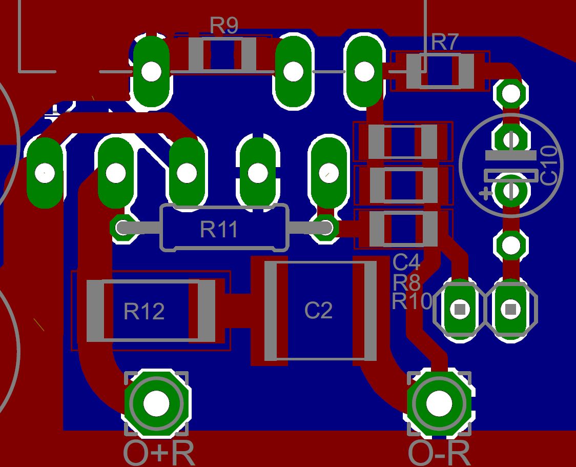

Not exactly what I had meant at the time but if you look at the PCB on #66 you can expect the LF current to flow between O-R and the (power) GND while the higher frequencies it will flow between O-R and C1/C2.
I didn't suggest that you didn't. (reread my first word)
Current follows all available paths, but much of the current follows the paths of lowest impedance. At low frequencies most of this impedance is resistive. While at high speed most of the impedance is inductive.

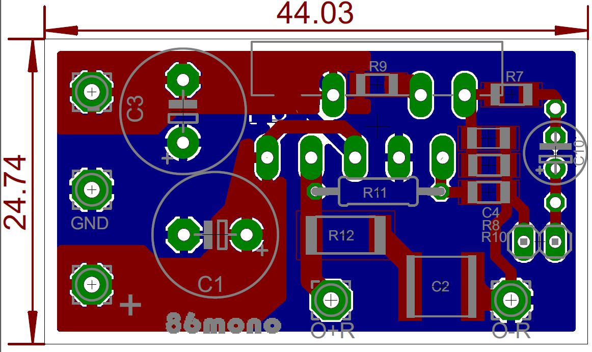

You could allow yourself to be inspired...
http://www.diyaudio.com/forums/chip-amps/268027-mini-86-lm3886-smd.html

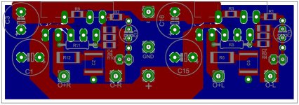

So you're suggesting to stick with mono PCB?
Aleš
No. Make it stereo!
As you are planning to order these from a PCB manufacturer, why stick to only 2 layers?
Make it in 4 layers!
Here (on this forum) you have super skilled guys to help you in designin a SUPERB stereo PCB for the 3886. Better PCB than you kan get in any kitt anywhere.
No. Make it stereo!
Yes I plan to order these from PCB fab. I suppose I can make it 4 layer.

No. I'm suggesting that you implement the low-impedance grounding shown in the Mini-86 thread. In particular, notice the routing around the Zobel network and how Cz connects directly to the ground plane though a sizable via.
A good high-current, high-voltage op-amp (which is what an LM3886 is) is all about minimizing impedance, i.e. minimizing inductance and resistance.
There's no need for more than two layers in the PCB. I'm able to beat the data sheet performance of the LM3886 with a good 2-layer layout. I show the data in the LM3886 P2P vs PCB thread.

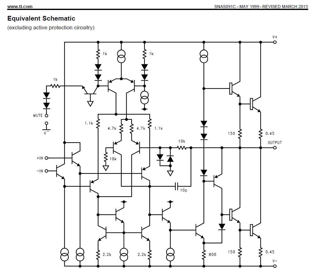

Your awesome layout 😎 got me thinking about how the V+ is routed.
Is pin 1 the real V+ power pin compared to pin 5?
Are they shared?
Going to different parts of the circuit ?
The "Equivalent Schematic (excluding active protection circuitry)" doesn't show anything:
And only the first schematic even shows pin 5 ...
Does anyone have the full internal schematic of the LM3886? (My google-fu has failed!) 😉
