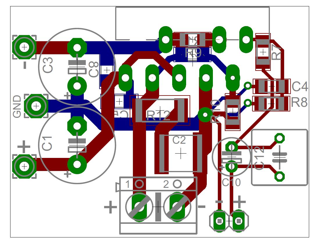

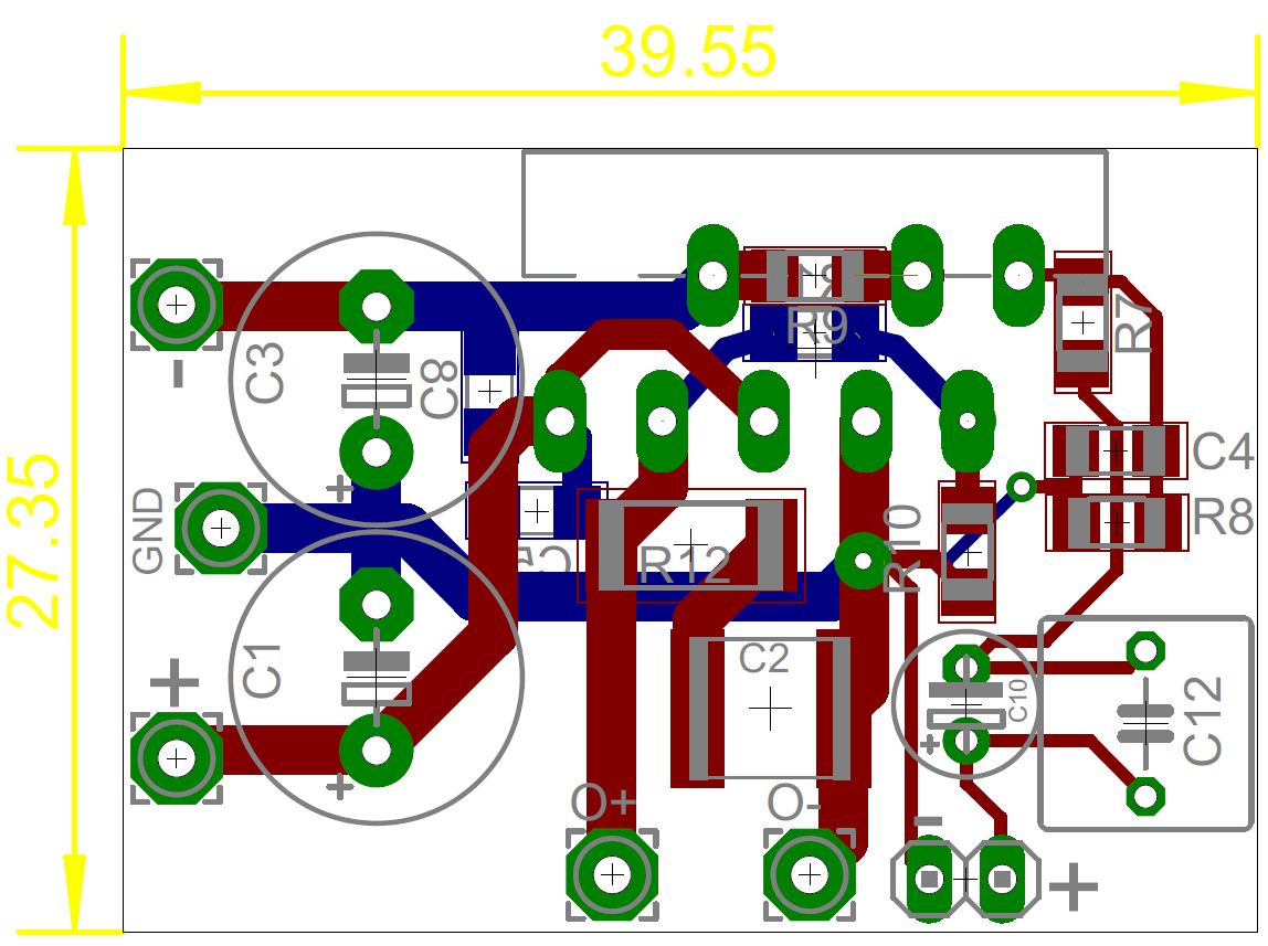

@marce: What do you think about this mono PCB? Of course you might again say it has spider legs, but in reality traces are shorter than they would be if GND lines would be connected through other components, referring to C4 and R8.
C1 and C3 are 100uF/50V but this module is supposed to be power with regulated PSU, dual mono design. R9, feedback resistor, is placed on the bottom and might interfere with Vcc and Vss, so placing through hole resistor directly on the LM3886 pins is not excluded.

Nice...
On RF you do have to cater for it these days. I would not have separated the return for C4 R8 as they are closely related components in the circuitry and having them at the same GND would be better for circuit operation IMO, you are reducing the parasitics between the two device. This is what I meant when I was ranting about the spiders legs GNDs, I do believe you can go to far, and related components would be better with a nice solid trace to the star point from both devices.

I do not now much about 3886 but this PCB looks already a lot better.
With some minor tweaks it could be excellent.
For example:
- Turn the output socket around so that the gnd terminal will be on the left side (closer to the power ground = shorter track).
- The chips GND pin has negligible current in it and has nothing to do with the power ground nor with the input ground. I would keep it away from the input ground but thats just me...
- As Marce suggested with the C4,R8,R10, do it. I would also include the R7 in that order...
- R9 might have a better place below the bottom pin row of the chip. Other input circuitry might want to be moved closer to this component (as we now should have space for them when the speaker connector has turned...

You are clearly mistaken, PCB has excelent grounding because every components ground is routed into star point.
Which is exactly what you do not want. You want a low impedance ground, because this minimizes the error voltage that develops across the ground connections. This means a ground plane... Where you connect the feedback ground and input ground also matters greatly. I suggest connecting the at the output connector. You can find more detail here: http://www.diyaudio.com/forums/chip-amps/252436-lm3886-pcb-vs-point-point-data.html You can also see the impact of a poor layout vs a good one.
Please do the math on the feedback resistors. The 1 kOhm feedback resistor will dissipate 392 mW if the amp is operating with a full swing on a +/-28 V supply. 613 mW for a +/-35 V supply. Your 1206 components are probably rated at 125 mW or 250 mW at the most.
