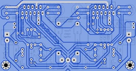

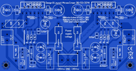

I think this is close to what you made. Some interesting choices.
Hi Mark, probably closest to this:
Tony.

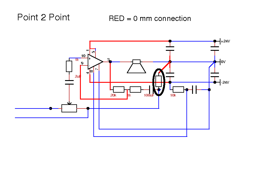

Hi Wintermute,
its very much like the first P2P I build, connecting feedback to audio return first.
I discovered that Pin 7 has a low level signal, so I moved it away from audio return.
As far as I know, if sch replicate real thing, this is completely wrong, HF loop in both direction is huge! Input, feedback and output ground should be referenced to power ground point which is form by local decoupling caps near the power supply pins, 'cos that is the point from where the amp gets it's ground reference.
You don't like it? Most of the designs here at Diyaudio use this method of speaker return (grounding), including the great My_Ref_c.
I did it based on the datasheet comment here:
When designing a layout, it is important to return the load ground, the output compensation ground, and the low
level (feedback and input) grounds to the circuit board common ground point through separate paths. Otherwise,
large currents flowing along a ground conductor will generate voltages on the conductor which can effectively act
as signals at the input, resulting in high frequency oscillation or excessive distortion. It is advisable to keep the
output compensation components and the 0.1 μF supply decoupling capacitors as close as possible to the
LM3886 to reduce the effects of PCB trace resistance and inductance. For the same reason, the ground return
paths should be as short as possible.
The only thing (as far as I can see) that I have not done in accordance with this is keeping the star point as close as possible to the chip ie "For the same reason, the ground return paths should be as short as possible".... This is the thing that Tom mentioned as well and the part I thought I should change. This is a minor change in that I just have to shorten the four earth return leads and tie them to a common point and then run a single lead from their back to the PSU ground point.
Or am I missing something else?
Tony.

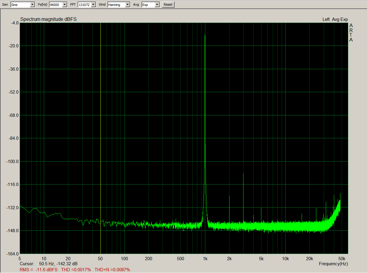

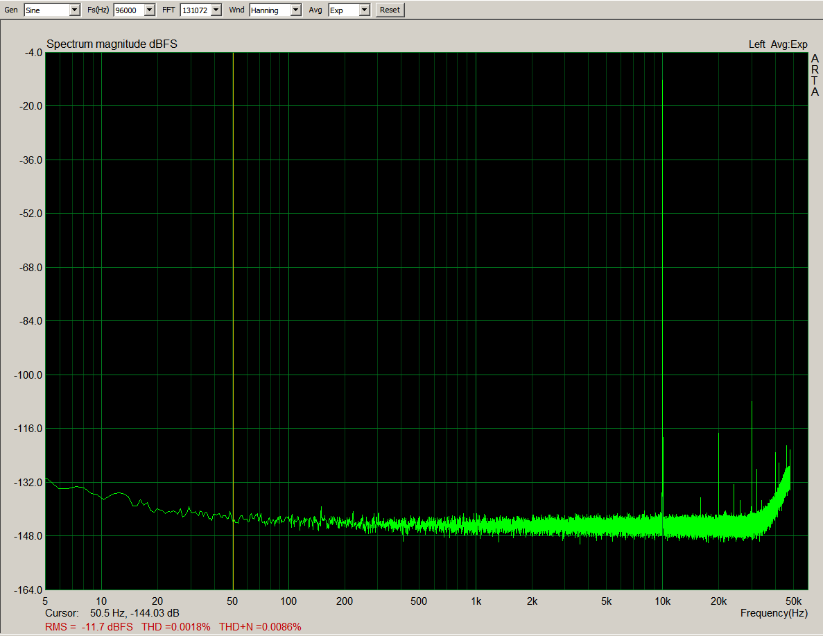

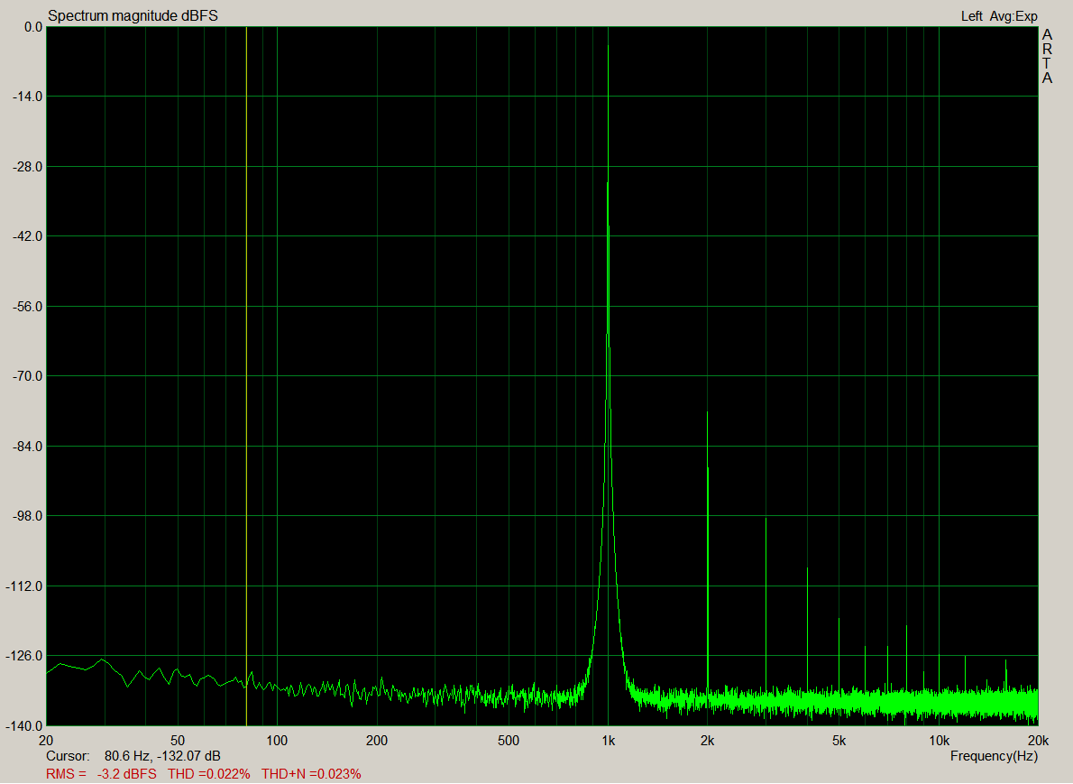

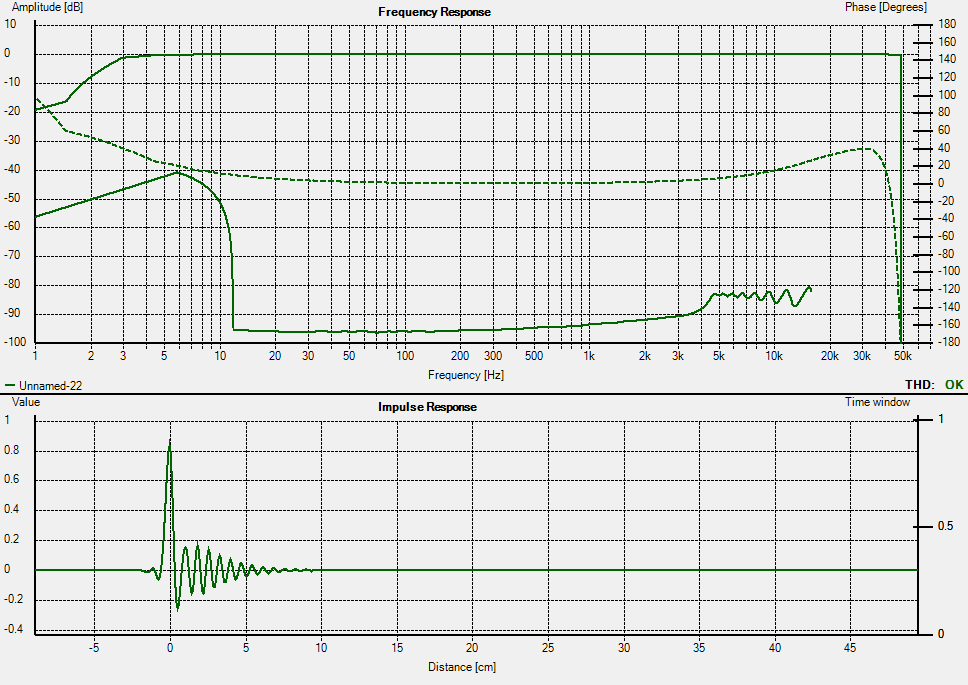

I have a focusrite scarlet 2i2. It is pretty good on balanced to balanced loopback. It is very ordinary when an unbalanced device is connected to the balanced output (distortion is MUCH higher). I intend to make a balanced to unbalanced converter, some of the chips are ok but generally only have S/N of about -100db. I'd like to get something -120DB. I did find one chip but can't remember what it was, was SMD only Linear Technology I think. Found someone who had used it and was getting better than -120db S/N.
Attached are tests I did when I first got the 2i2, note the distortion plot in holm is suspect. 4th pic is using a balanced to unbalanced loopback. ie: unbalced out (tip hot, ring and shield tied together) , and then tip and shield of the RCA to tip and ring on the input of the 2i2
Tony.

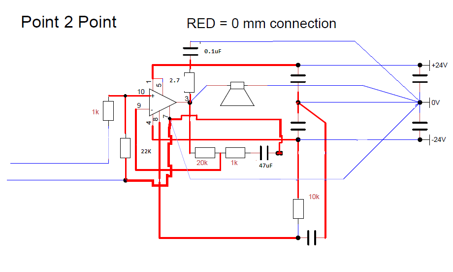

Hi Wintermute, I would connect the feedback loop to 0V (star). after tomchr tested different return methods, I realised how bad it is not to return the feedback and audio returns separately to star.
The feedback loop becomes a voltage divider and so injects output signal into the audio return, as well as messing up the feedback loop.
See schematic.
See schematic.

Hi Tony that looks pretty nice. what software are you running? I guess getting some measurement software is key, which then determines the interface hardware / sound card requirements. yes I think balanced interfaces are necessary will look into that some more
I like it. I have the Saffire PRO 24 myself. Nice box.
Looks like Holm Impulse and ARTA to me. Holm Impulse is free. ARTA is $80 or maybe it's 80 Euro. Pretty reasonable. There are free audio spectrum analyzer software as well. If you find any for Mac, let me know.
