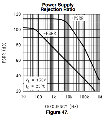

The DS shows the PSRR only for open-loop operation. It would be instructive to see what happens when the loop's closed. When I tried simming the LM3886 schematic for PSRR in LTspice (closed loop) I couldn't reach the theoretically predicted performance at the lowest frequencies.

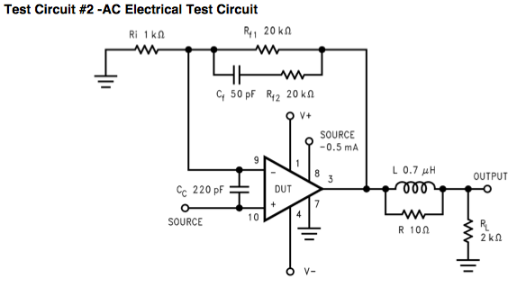

Um. No... It shows the PSRR for closed loop operation. The AC test circuit would be used for the measurement. No measurements on an op-amp are run open-loop.
I'm not sure what you mean by "LM3886 schematic". If you copied the LM3886 equivalent circuit schematic but used discrete devices (and their respective models), you would get very different performance. If you simulated an LM3886 model and the model included the supply related effects, you should get close to the data sheet performance.

There is really no point in measuring the THD with the supply wiggling. It's the wrong measurement. Recall, THD = [power of harmonics]/[power of fundamental]. A spectrum of the output signal would be a better measurement. Then again, the result can be deduced from the PSRR plot. If you apply a 6 kHz, 1 V sine wave to the VEE supply, you should get 1 mV on the amp output (60 dB PSRR). If you want to predict the effects of a triangle wave, look up the Fourier series, figure out the harmonics, and do the math.

We agree that any supply current drawn by the amp will cause the supply to sag, right? If you have a sine wave input, you'll get a half-wave rectified sine wave current (plus a little DC) on either supply. This supply wiggle will be attenuated by the PSRR but you will find some (usually small) fraction of it present on the output in addition to the desired sine wave output. Are you with me so far?
So we need to know the supply bounce versus output signal amplitude (or probably load current amplitude, but output voltage is easier to deal with - we can just make a trace for 8 ohm load and one for 4 ohm load). From the measurement of the supply bounce, we can calculate the amount of supply-induced voltage on the output and compare that with the desired output signal voltage.
Now the question becomes how low a PSRR you can get away with before someone with golden ears will perceive a difference between "good enough PSRR" and "not enough PSRR" in a double/triple blind test. I don't know the answer to that.
A common FOM for the threshold of perception of THD (yes, different than PSRR) is -50 dB (0.3 %). I would assume that the threshold for perceptible supply-induced disturbances is similar. I would guess that if the disturbance is 50+ dB below the fundamental, you're probably good...
