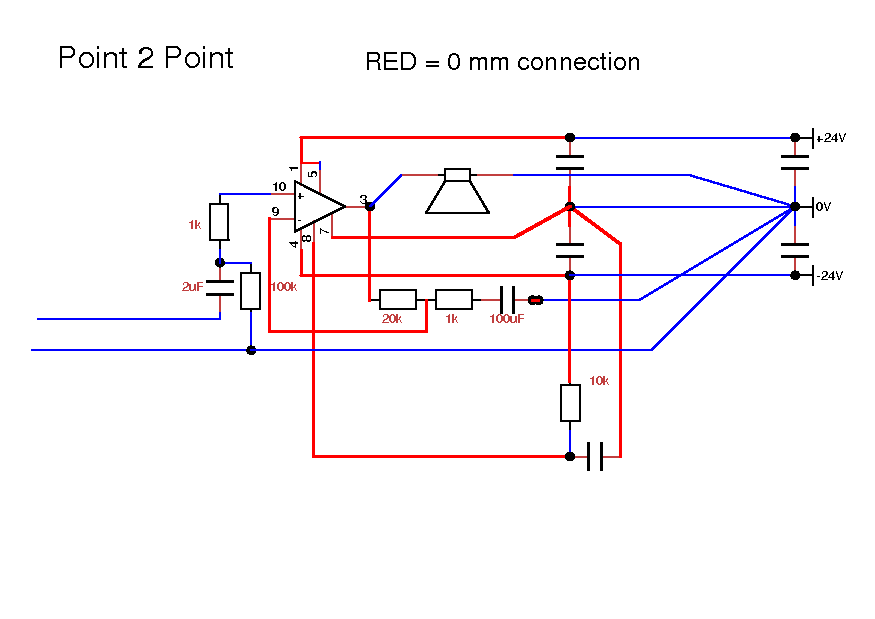

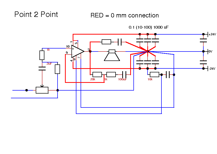

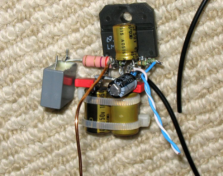

Hi Tom, I checked my construction notes and this is what I did.
Main star is a bolt in the middle of the PS board with various returns bolted together.
Zero volts from xformer first lug on star point on PS
Speaker returns next lug on star point on PS
Decoupling caps and mute cap grnd next lug on star point on PS
zobel cap returns next lug on start point on PS
Pin7, Neg Feedback Cap, input gnd and input ground ref resistor (all connected on pin 7) last lug on star point on PS

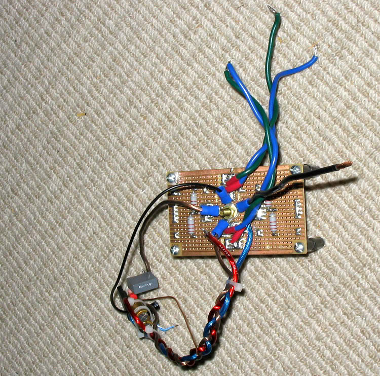

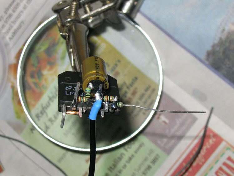

You said that the zobel cap return made the biggest difference (I think). When I did my p2p I thought long and hard about it (based on the datasheet) and that was what I came up with. I figured that input, Neg Feedback and the zero volts reference of the chip were probably best all locally tied on pin7 and that the others (due potentially high currents) should go direct to the star point on the PS PCB. I'm now wondering about the zobel cap...
I'm going to need to make a decent balanced to unbalanced converter before I can do good distortion measurements as my focusrite 2i2 has poor performance when the balanced output is feeding an unbalanced load. But I am interested to try and get some measurements to see how the thing behaves at higher frequencies.
Couple of pics attached showing where things were with relation to the chip 🙂
edit: looking back at your post, I think what I did was basically closest to your IN+FB long ground. The main difference is my main star point is in the middle of my PS board, You said that you should not do this! It wouldn't be very hard for me to make a second star point and bolt all of those coming from the chip there, and then run a separate lead to the PS star point..... added pic of ps board as well...
Tony.

If you outline your understanding of the science behind why the performance should be better with the input ground (black wire) connected to the star ground by the other passives rather than the star by the supply caps, I'll be happy to move it and retake the measurements............... and, preferably, outline the reason for your suggested changes. Referring to some arbitrary "best practices" doesn't carry much weight, honestly.
To me, the circuits are functionally identical. Neither circuit shows issues with stability or ground loops. If you know of any scientific explanation of why changing the grounding will improve the HF THD, I'm all ears. Right now what I'm hearing is "this doesn't follow "best practices" (whatever that might be)" without any explanation of how you would prefer the layout to be and why your "best practices" will improve the performance of the circuit.
I'm all about discussing the circuit and the layout. But please back you claims up with a logical explanation based in science so we can keep the debate scientific ...........
...............The results were rather dramatic.
Conclusion: Layout matters greatly - also in P2P wiring (we knew that). I achieved the best performance with the IN and feedback (FB) grounds combined and returned together to the star ground. Separate IN and FB ground returns were slightly worse. Star grounding, actually, a little bit worse that the other two. NO ground return should return separately to the center point between the supply caps. Run only one wire from the ground star to this point.
Moving the Zobel network to sit directly from the IC pin to the ground star made by far the biggest improvement, closely followed by moving the IN ground to the ground star as well. That was the reason for the poor performance I was getting. My bad... The schematic for the UNOPTIMIZED P2P tested yesterday (the gray trace in the attached graph) can be found in Post #14. The Zobel network was connected across the speaker terminals (don't do that!!).
I will take the lessons learned from this and apply them to my PCB design..........
