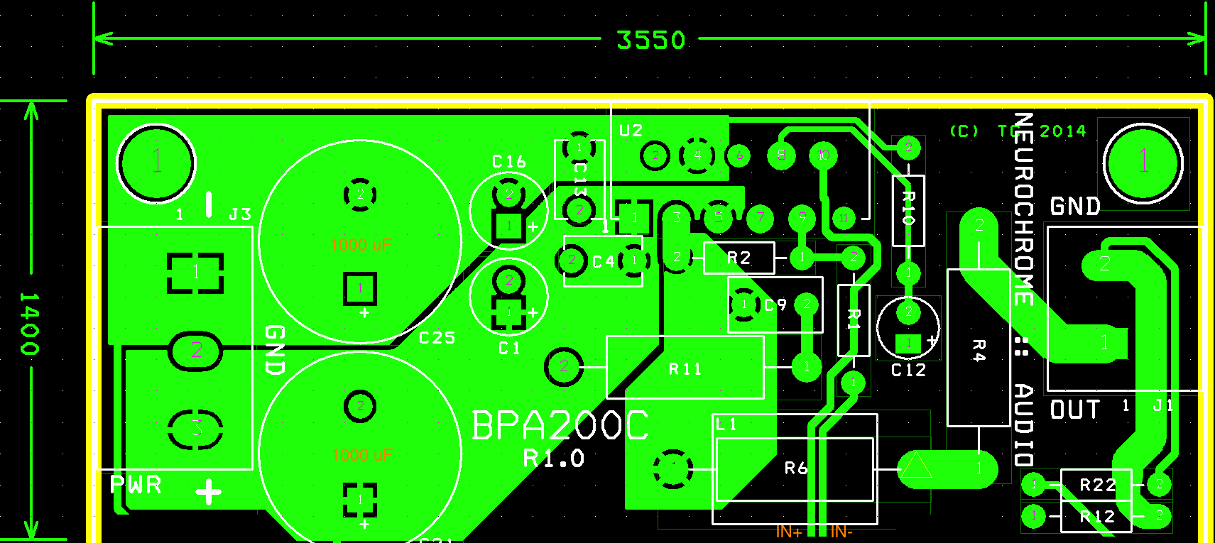

Anyway... Mucked some more with the layout. Stare at attached.
There are two main changes:
1) The Zobel network got rearranged such that the Zobel ground moved a lot closer to the HF ground by the decoupling caps. Also, I found a 100 nF C0G/NP0 ceramic cap(!). That should work just fine.
2) The decoupling caps moved closer to the LM3886. One of them was rotated to move its ground pin closer to the HF ground.
To address KSTR's concern: The fringe cap between the VCC and the OUT pours will be swamped by the cap to the ground plane. So I'm not so concerned with the proximity of the pours. If it turns out I'm wrong, I can easily change the pours with a Dremmel... 🙂 The joy of prototypes.
I ended up taking the small signal ground for the op-amp circuitry south of what's shown in the image by the output connector. As KSTR pointed to, that's probably going to be the quietest spot in the plane.
The board goes in the ferric chloride soup tomorrow. I'll keep you posted.

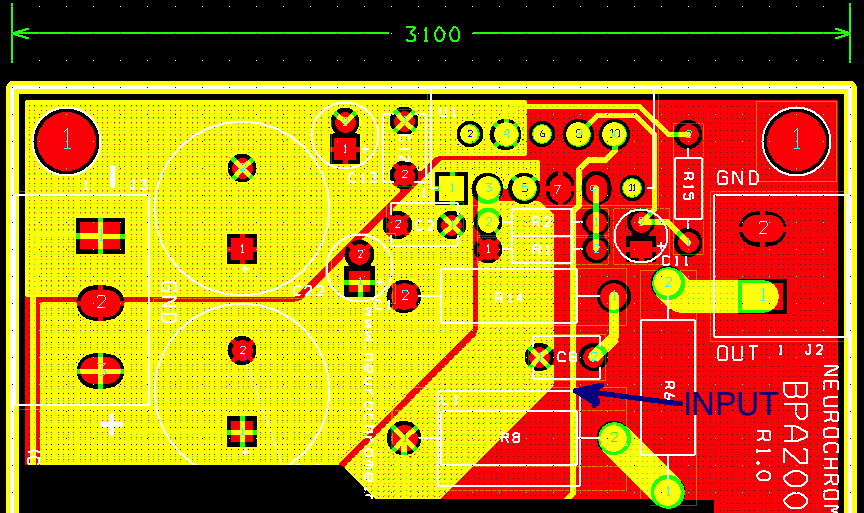

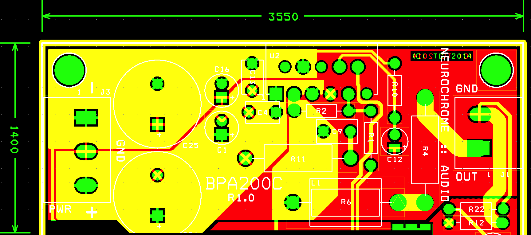

Finally... I managed to get the PCB optimized. See attached.
KSTR has previously expressed some concern about the VCC and OUT pours running side-by-side. The currents in the VCC pour are not pretty. The LM3886 is a class AB amp, after all. However, the VCC pour is tightly coupled to the ground plane on the bottom layer. Hence, I strongly suspect that the nastiness will couple to the ground plane through the sizable plate capacitance, rather than cross to the OUT pour via the much lower fringe capacitance. Also, the OUT node is of rather low impedance (probably a few ohm, open loop).

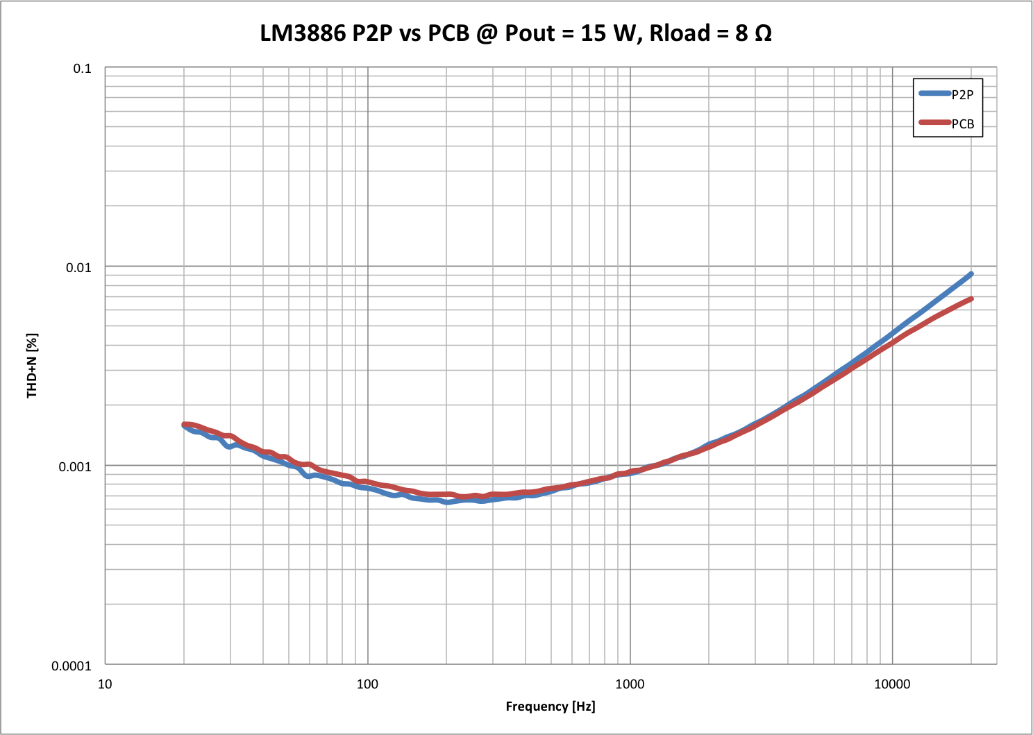

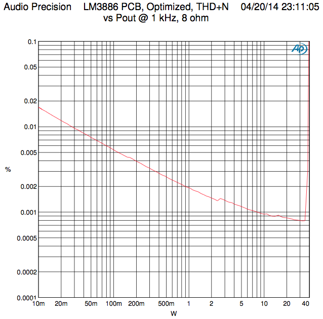

I've included the THD vs frequency for Pout = 15 W, 8 Ω and for THD vs Power at 1 kHz, 8 Ω.
Now the moment we've all been waiting for: Which is better, PCB or P2P?
Sorry to disappoint, but there is no clear winner. The two are line-on-line through most of the audio spectrum. In the low end, there's a slight discrepancy due to measurement tolerances and repeatability. In the high end, there's a slight difference in favor of the PCB - probably due to the use of lower inductance planes rather than wires.
The bottom line is that a poor layout will lead to poor performance - regardless of P2P or PCB. A good layout requires real work.

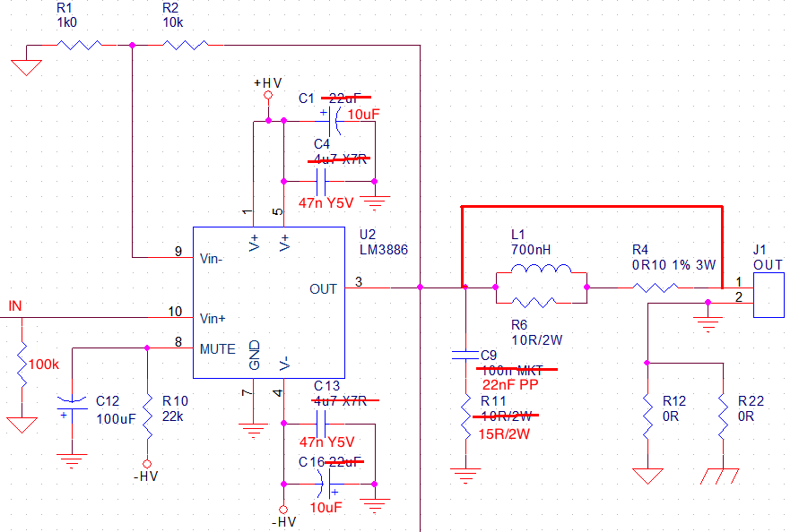

Hi Tomchr,
Great work as always. Just two questions. Where did you connect R1 to ground? I think this is possibly responsible for the (small) improvement at 20 kHz.
And have you tested the amp with a non regulated PSU?
Mark,
I have not tested with a non-regulated PSU. I used two HP/Agilent E3632A lab supplies. For debugging circuits, I prefer to have as few variables to deal with at any given time, so a clean supply simplifies life. It'll be interesting to see the performance with a less fancy supply.
R1 was grounded through R12 to the ground plane by the speaker GND terminal.
