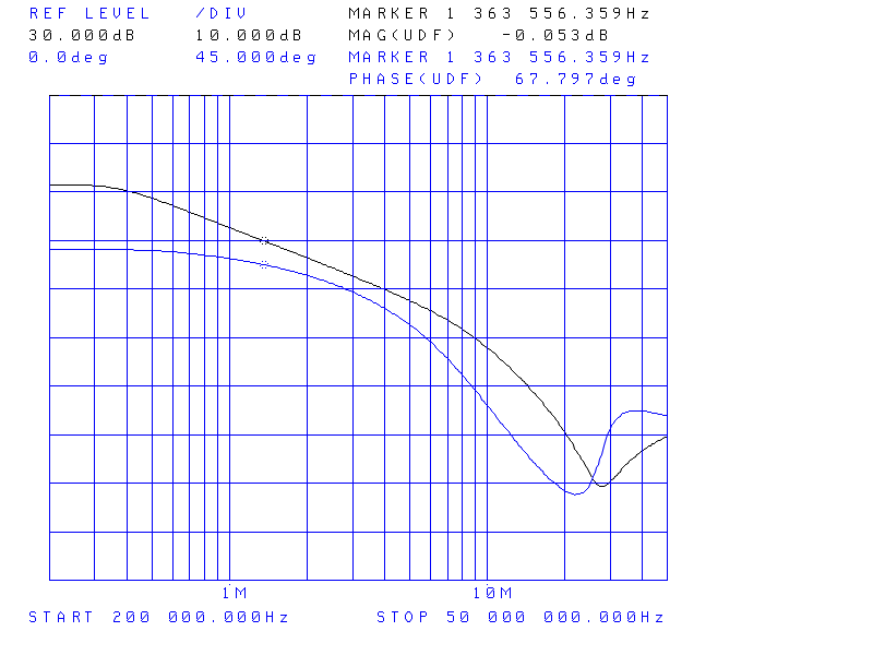

Then the moment we've all been waiting for LOOP GAIN measurements. In textbooks, the loop is opened and the gain "measured" or calculated. In practice this is not possible. However, by injecting a disturbance voltage into the feedback loop, the loop gain can be measured. This is documented well in an app note from HP: "Loop Gain Measurements with the HP 3577A Network Analyzer". Note that I did not bother to invert the phase, hence, the phase shown is actually the phase margin rather than the loop phase. Also note that the Tektronix CT-6 current transformer I'm using is intended for use at much higher frequencies. That causes the roll-off in the low end (<500 kHz).
The phase margin measures 68 º. The UGBW is 1.4 MHz. That's a bit higher UGBW than what I would have expected from the data sheet, but not completely out of whack. The PM is right on the money versus the data sheet specs.
The gain margin measures -14 dB. Not bad.
Gear: HP 3577A, Tektronix CT-6, HP 6237B lab supply, 8 Ω dummy load, Tektronix P6139 scope probes.
Supply voltage: +/-18 V.
Load: 8 Ω
Setup: LM3886 STAR GND P2P circuit.
~Tom

Tom,
Brilliant work 🙂 really "Damn Good" 😀

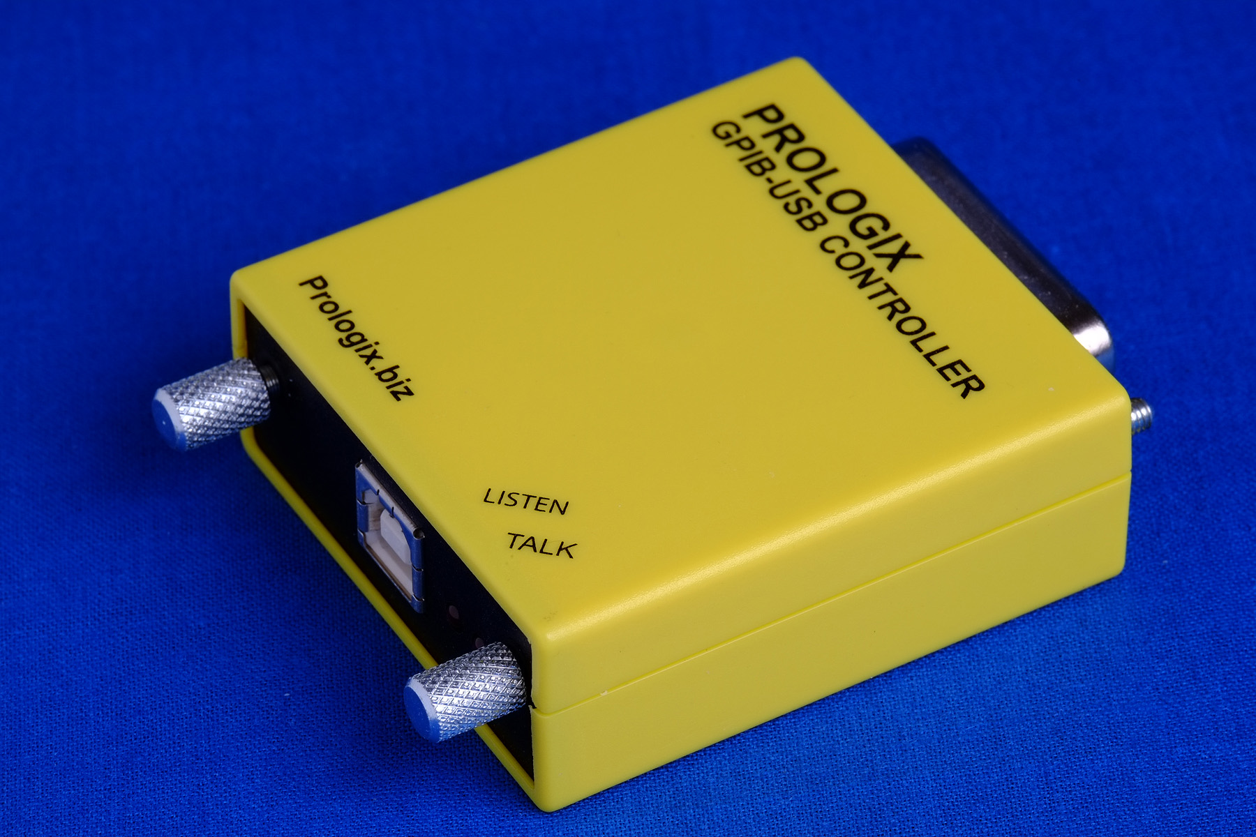

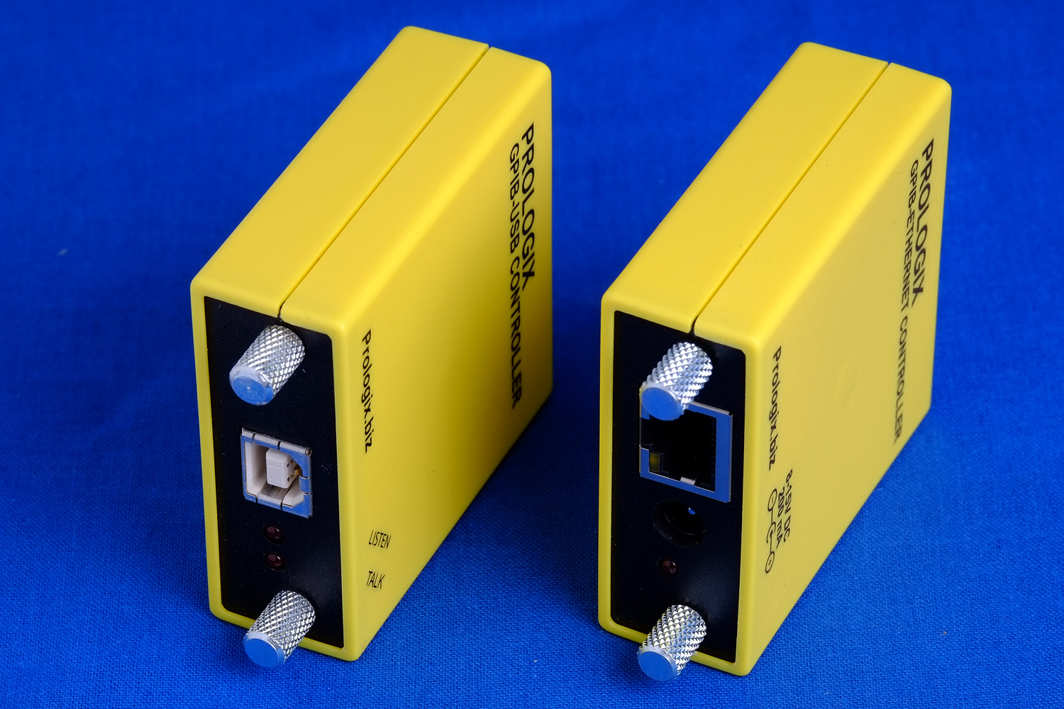

I use a Prologix GPIB-ETHERNET Controller to control my test equipment and to get the screen captures. John Miles has an excellent toolkit for the Prologix controllers including a plotter emulator.
I've used the GPIB-USB version as well. It works just as well you just have to connect via USB rather than ethernet. I find the ethernet version to be more of a "set and forget" solution as it's always plugged into my network. I have the USB version for sale ($120), just PM me if you're interested.

I was at first surprised at how low the indicated LF gain was on your Bode Plots, but upon reflection you are not only battling against the CT-6 LF B/W limitations but also at the same time working against OPS decreasing OPS impedance towards DC – both these effects will impact the LF portion of the Bode plots.
At least the Loop Gain plots appears to indicated the main area of concern 🙂
Yep. As you can see from the slope in the 400 kHz - 4 MHz region, it's a -20 dB/dec slope. Just as you'd expect. I think it's fair to extend that towards the LF region.
Which was the point... 🙂
Thank you for your offer of the Prologix GBIP to USB – Seems like they have become far more professional – I remember when they where just bare PCB with Heatshrink wrap.
Dang! He really hit jackpot with that controller. Open source software. Easy to interface to. Less that half the price of the NI controllers that require proprietary software. You can get them through various distributors now as well.
