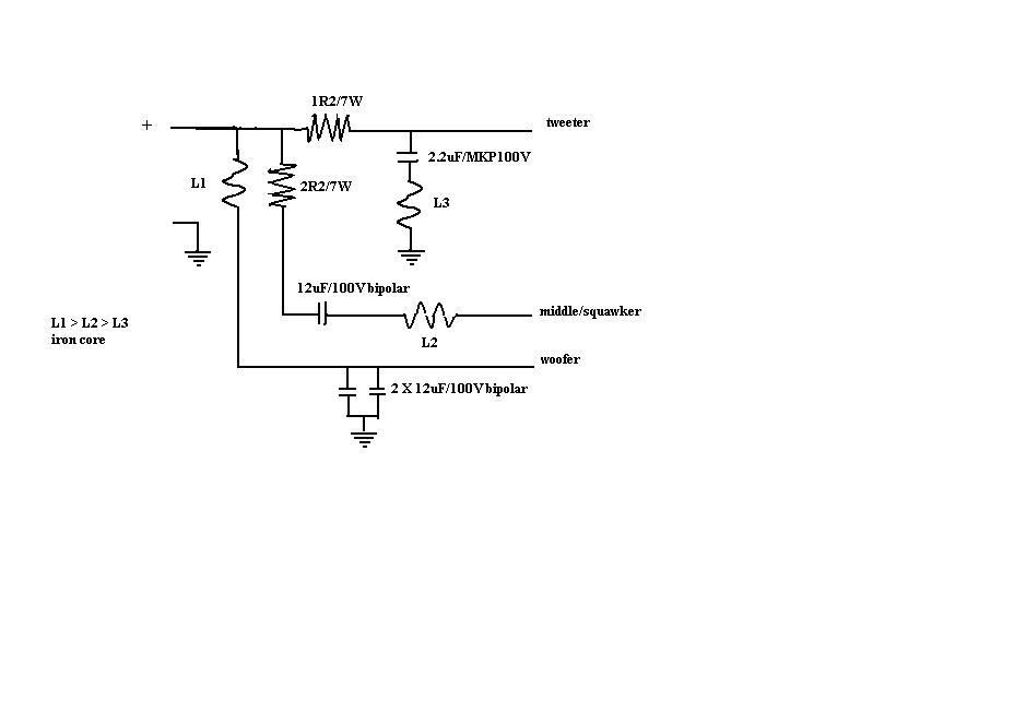

still works on your portable project?
i'm break other IC. heat problem at 34VDC when play the amp realy loud for test ( over than 3/4 of 50K pot ) its broken for about 30 minutes play. i was in a crazy test, i'was impresed with this small chip power efficiency, so i test the amp to drive a pair of friend's 2ways 18' SPL kind for stage speakers.
the heat can not quick delivered/spared to heatsink due to micas usage, even when it lubricated.
we need a strong and close blower fan,which i was not use it.
or take off the micas ( only lubricant), and isolate the heatsink from grounded things, 1 piece for mono.but thts only easy if the body made from plastic like mine.
they're good in other 'loud' tests.
even I never plays at such crazy loud for daily use, i choose to turn down the voltage to only 22.4VDC with micas as insulator+lubricant, for safety and hope durability.
it produce OK sounds either. i don't know if its also related with the LM series number ( the broken was 1875GY the new one is 1875AL ).

AndrewT said:Hi E,
what were the speaker impedances when you tested at +-34Vdc?
i don't know, the woofer marked 'soundking' maybe you recognize,
On the Soundking products, an "H" at the end of the model code indicates an 8 ohm driver, while a "G" instead indicates a 4 ohm driver.
The cast alloy (thick aluminum) model FB1805 is only available in 4 ohms, so its model code ends with a number.
So, the question is, did you ask the little amplifier for about 50 watts (with 8 ohm) or twice that much (with 4 ohm)?

oh yes please do you know how?
I think that your amplifier experiment was either hooked up to 4 ohm drivers, or something with a severe impedance dip.
Safe answer:
Use a 36vct rated, 18+18vac transformer. That will have excellent performance on 8 ohm speakers, with 27 watts, and it won't blow up if you transport it and then connect unfamilar mystery speakers (probably operating at 4 ohms).
Limitation: However operation of 4 ohm speakers is a bit safer on 25vdc rails (use inefficient diodes or a 32vct (16+16) transformer. In case of 4 ohm drivers, the maximum power output relates to heat. At 42 watts, the heat will not go into the heatsink fast enough and. . . r.i.p.
Fun risky answer:
A 40vct rated, 20+20vac transformer. That will operate 8 ohm and 16 ohm speakers. However, the amplifier will blow up if 4 ohm speakers (or 8 ohm with a severe dip) are connected.

got it,
i'm just proofing that the smaller ohm cause more heat.
ths maybe also participacing problem of my last burning amp.
maybe you can help to adv how to count the true impedance when using the crossover?
i attached my car's crossover network for example.
the pioneer's ( kitchen ) crossover have optional 8ohm or 16ohm, i dont know what inside, for i can not open the slacking case. what you think inside, if it can turn to 8ohm or 16 ohm?
so.. we can not go more greedy with said 50watt with 8ohm and twice with 4 ohm
you know the small wattage is not 'selling' in my country, thats the reason why this good chipamp is not popular here, unlike the bigger 3886. people wants more hundreds even more wattage.
i don't know, and don't know how to count, but the second chance in last crazy test, succes to impressed everyone. no one believes that this only a 'twenty-something' watt system till i open the case.

Actually, the LM1875 limit is 42w heat, which is more like 32w (maybe 39w) of music. Otherwise the heat won't go into the heatsink fast enough.
Guideline: Lower the voltage for 4 ohm drivers. The 4 ohm drivers will "ask" for twice the power of 8 ohm drivers.
MAX:
You can use a 36vct/18vds transformer with LM1875 for 4 ohm drivers. EDIT: 26vdc rails
You can use a 40vct/20vds transformer with LM1875 for 8 ohm drivers. EDIT: 29vdc rails
