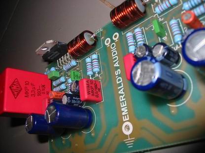

eketehe said:here are some pics, taken before re-instaling.
pls comment..
Hmm. There aren't usually inductors on chip amps. The one other time that I've seen it, the purpose was a loudness countour. Anyway, I just don't know.
