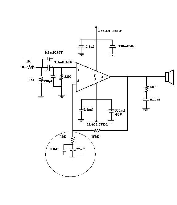

I think you have shown a 10k & 330pF low pass filter (3.3uS) on the input. This is too severe and will cut a lot of treble.
Aim for between 0.5uS and 1.5uS.
I suggest the 10k be reduced to 2k0

Tks mr andrew,
the treble just OK, but worth for a try. the smaller value caps, will they also cut the low bass?
I was trying 1K0 i/o this 10K, mm i like the smooth acceleration, or you think there's a quality degradation due to this 10K?
FYI, i using preamp for tone control, and by pass mode. some record need a little adjustment.
Brgds,.
Eka
Sorry for the wrong info
sorry for the wrong info, the existed input R sud be 1K0 i/o 10K. I'll revise the picture. The comparison is on 1R. Tks

i also still working on input caps setting, mr andrew t suggest for the smaller value. said the big 3.3 will cut much treble.but the additional 0.047 or 0.1 in combo really solved this,thts working for separated tweeter of my 3-ways. not change anything in my 2ways.
i'm stop a while for sightseeing this forum, for i'm a bit mixed up with many things.also my testing drivers.the 3 ways and the small 2 ways. maybe i did wrong from beggining for i was set NFB to maximize or maybe cheat the drivers perfomance.
The existed caps is 3,3/160V combo with 0.1/250V all polyprop.on 3-ways,they're good in flat mode.lets say good for diana krall live,its able to 'shows' the contrabass tone properly, no subwoofer needed. but not good for 80's record with their limited widhtband, example: madonna's 'crazy for you', will shows unnecessary low tone.more bad for 70's re-recorded musics. unecessary mean not synchron with the music, i think thats only 'sud be cutted'bias. different result for my 2ways.
- i'm considering to change the input caps with only 0,047to0.1, i like the repro but they're cut the low tone which needed on some record. then activate the subwoofer. but the low tone sounds unnatural from subwoofer.
- i'm considering the existing.without subwoofers, and let to hears all things in the records.
- think to make em' can be switched by a selector. and make more option input caps for vary musics. without the subwoofer ( than get more busy than just enjoying. )
see i'm thats complicated

Hi Daniel,
Transparency... whata great idea, i'm so stupid, tht sud be in my brain since the beginning i/o mix uping things.
Lets starts again..
do you mean the 0.047 in paralel with 22uF? ( see pic )
I'm failed to find the said nichicon types, but XYG, KX n VX. Matshushita FC series are the most recomended here, and they're available.
You're not stupid.
Really good transparency can also bring with it a loss of efficiency because of less compression. That can make observation difficult. However, you can always tell. Its the option where you listen to almost every song all the way through. Its the option where you can hear "through" the speaker to the "other side" and hear the ambient sounds at the recording site.
For the bypass cap deal, little Hi-K ceramics marked 473, 103, 472, can make good results. So can the little polyester.
Another possible specific capacitor for that spot is Mallory/Cornell 22uF 100v SEK (105c rated). It doesn't need the help of a bypass cap.
Its audiophile grade for about 25 cents.
This isn't true of either the 50v version or the 250v version, so that one model is just a lucky find.
As far as other options, a small collection will let you compare and find the one that pleases. Most generally, there's more success with 100v rated caps at the NFB because the 50v caps "may" have greater compression that's more suited towards PA than Hifi.
With chip amps, you can do it by listening to female singers. If she's really angry, well try a different option.

Selecting the cap for the NFB is the current discussion.
Scenerio 1
One might choose such that seems to make additional bass because that's exciting. It might be additional bass, but it might just be compression. This is a great time to see if the bypass cap practice can help. Maybe you can have your cake and eat it too? Maybe not.
Scenerio 2
Possibly, hopefully, one of the options is incredibly beautiful but seems to have slightly less bass than Scenerio 1. So, I didn't want anyone to overlook the lovely sounds possible if there aren't compression artifacts in the audio band at all.
Its like "what to listen for" on this particular component choice. The decision is quite difficult; but, given a small collection, it can be quickly narrowed down to two or three excellent choices.
These most likely involve scenerios 1 and 2 above.
