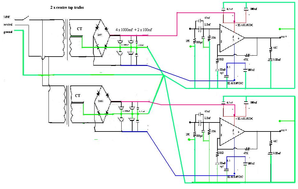

Hi E,eketehe said:the LM1875 isolated by mica and rubber paste, I tought tht was safe enough. i also always touch the heatsink for heat test.
well,Tks Daniel,
this also new for me, i need to check this.
can you kindly adv what is the TF and the T chips ?
do you have any exposed conductive parts? (yes?).
These must be connected to Safety Earth.

belows attached is my grounding network( in green colour ), which is the safety earth? the ground at a/c input or at the centered?
I see in the photos, an exposed heatsink, and I also see metallic audio connectors leading to ground. This means that the amplifier could kill a person or pet unless the chip is electronically isolated from the heatsink. The "TF" chips should be safe; however, the "T" chips need an isolater (micas, insulating washers) kit. So, see if you can measure voltage between the exposed audio grounds and the exposed heatsink. Um, not with your fingers--use voltmeter. We like you and we want you to stay healthy. Sorry about the lecture, but its kind of scary.

I have do the test. with the volt meter
Well, um, threre is no electrical load. so i touch all over the body
FYI, the case is plastic goods, all bolted to the plastic body, i set the centered grounding.
the heatsink is isolated from electrical load ( separated by micas, white rubber paste thing, and small plastic thing with center hole ).
Is it good to include the heatsink as gtounding network?
Maybe the correct question sud be : when the exposed parts will containing electrical load?
sorry for bothering with such maybe un-pro things, i'm concerned about the safety, and need to understand, so that your advs will highly appreciated. Thks
Okay, the \"T\" chips are the ones that need micas and insulating washers. Since you can\'t pick up voltage between the sheild of the RCA jack and the heatsink, then its okay.
3rd wire, and \"safety earth\" is also called \"house ground\" here in the U.S. To use it, you\'ll need to make a small device. This devices gives some resistance to \"lift\" the ground by 10R so that your amplifier doesn\'t prefer \"safety earth\" over its own power star ground.

Hi Daniel,
The chasis is not ready yet, i will show you when all ready. I left this project a while.
I'm so lucky to have this discussion, so i awared to check all related, also lucky that we already have 'safety earth in home electricity system, its connected to the buried abandoned water pump pipe. i don't know if it just suficient or not. i talk about and raise this topic to people around me. almost all people hv been known about this issue ( poor me!), but we never know about the law/procedure or something like that controling this. theres maybe a law, but we are not well announced. so, almost all of my neighbour dont have this safety earth.but public building, also my office already have this network.
The safety method in the mentioned ESP pages, is a bit same with what i do with 'the kitchen amp'. i thought thats for sound system purposes ( humming, hissing, noise ) never thought for safety.
10 ohm, 5w or better wirewound resistor (like used in speakers).
this sud be what people call 'Safety loop breaker circuit'. after all, do i still need this circuit? sorry for i maybe mixed up or just don't get any point

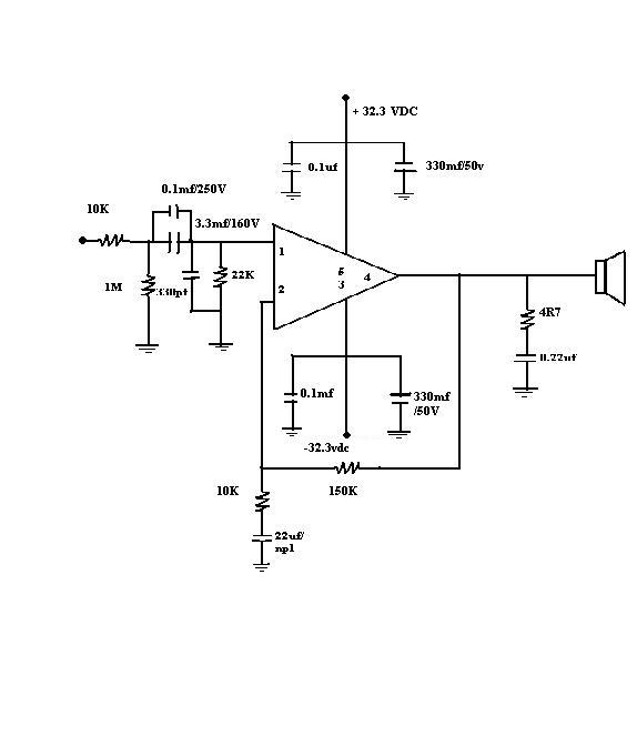

i replace the kitchen's amp with LM1875 ( i just can't quit of this . ). the last setting is fit to my small 2-way speakers, but this is my favourite setting for my '3-way all separated speaker system'. i tell you this is great and detaily in all range,perfect speed of woofers, but the most significant result is at human voice, they're soo identic . the drivers: their only some old speakers and maybe cheap ( metal body tweeters, 5' mid-range and pair of switchable passive crossover all marked pioneer, and pair of 12' eas' or seas' or something made in japan ) their lovely singing in dynamic, you won't stare at the drivers for their existance is not matter anymore but check the music with the singer at center. see i have far from where i start this. my mission to have a better hearing just accomplished. i don't know what will i find if i runs the drivers project. this activity is kinda enjoyable or i'm just addicted.
i give +/- 32.3VDC the heat will be a problem,firstly i felt the amp runs in jeopardy ( jeopardy great! ) for i'm predict that the amp will be over heat, but then just OK. i use pair of extra large heatsink with thermostat bolt on connected to cooler fan will auto on at 65 celcius degree. i think their just stable under 65. only warm ( don't worry, i check the heatsink with my hand after all disconnected ).
you're correct about the thight of ic's srew, once i burn one the ic for its still connected with grounded heatsink. just known that the IC's body is ( - ) as same as the 3rd pin. so then after, i make sure to screwed the ic tight and check connection with ohmmeter.
Pls check the diagram, this time i put the parts in PCB for more simple when seting. maybe you will try? see the input caps, this seting is able to present and awake the lowest string of contra basses or volcano sounds. so i plans to take off duty my subwoofer system, for its not necessary anymore.
